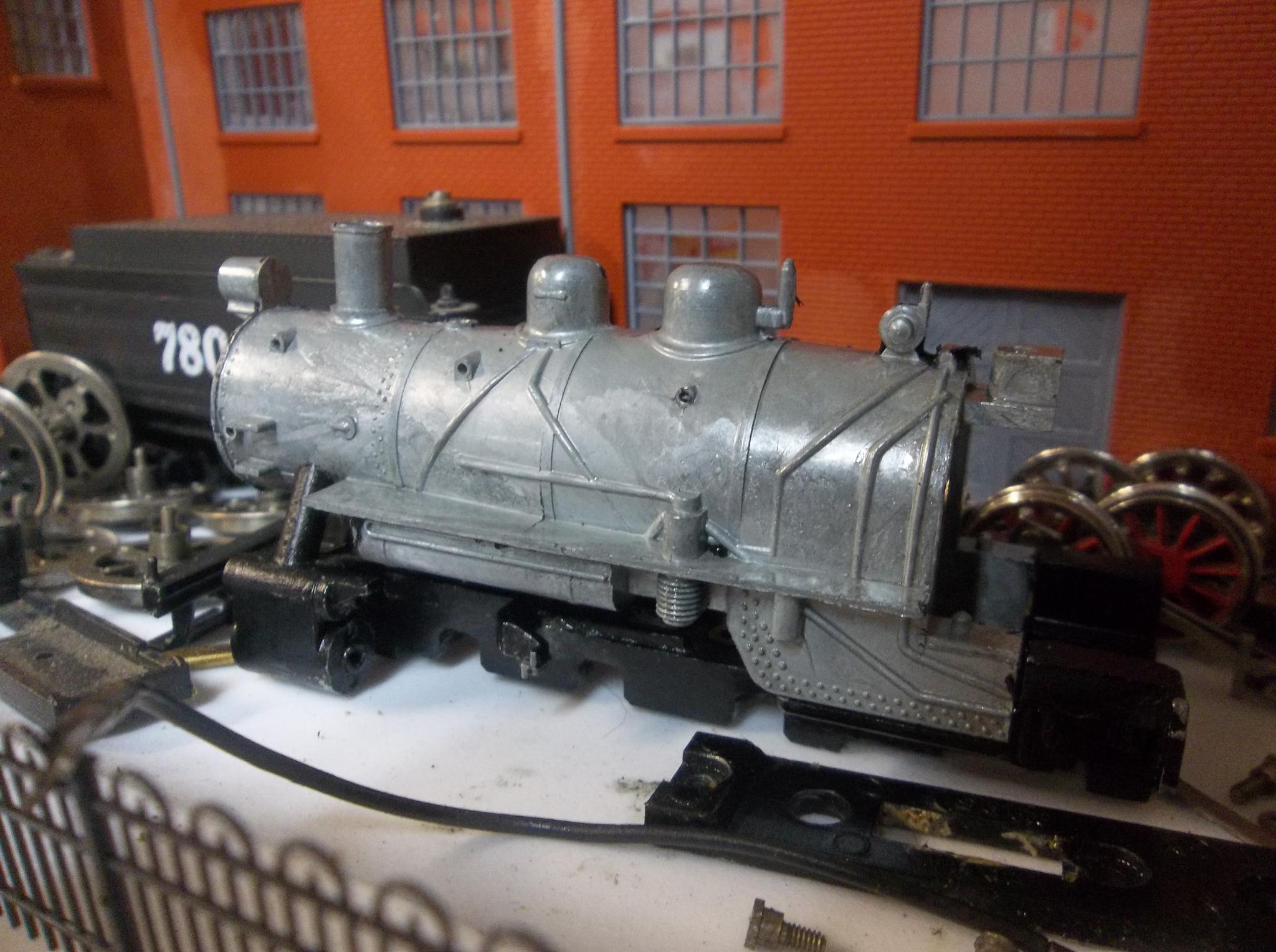

I use Napa carburetor cleaner! Works amazingly! just put the boiler or frame in it(no mechanic parts of course) and let it sit for more than 3 hours then the paint will either be all off or will be so loose you can blast it off with an air compressor or just use gloves to get it off. Here are 2 recent examples. If you're wondering why i had to remove the paint, it was cause I had bad spots in certain areas.
Mantua 0-6-0 Big six
Roundhouse 2-8-0
I buy, repair, and collect
