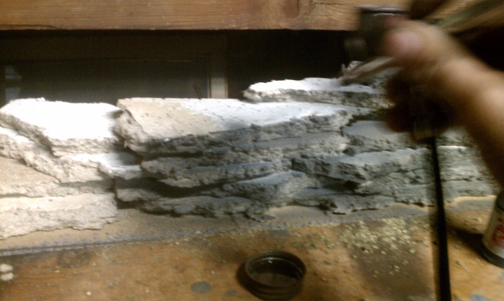

ok today, I will present a tutorial onhow to make a rock hill, mountain, quarry using ceiling tile
you can either buy a sheet of tile from your local home improvement center, or, like me grab it out of the trash bin at work
here's a sheet of tile

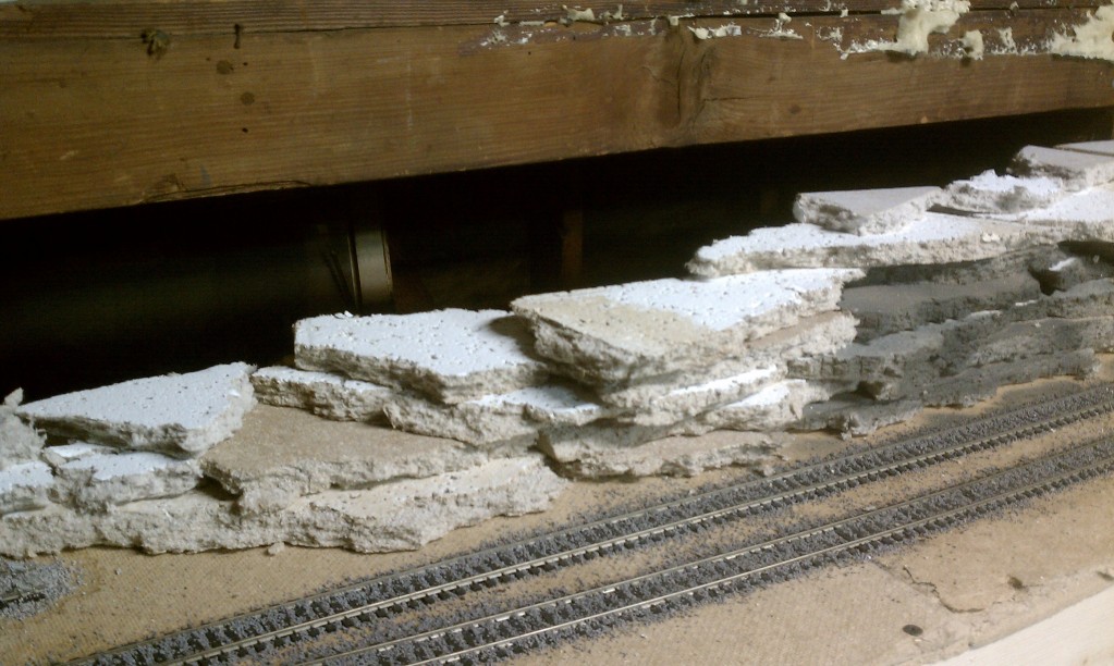

now simply break a piece off
then simply put it where you want your "rocks"
keep stacking till your satisfied with the height, you can glue them in place (with some white glue) or like me leave it loose until its senicked
then hit the airbrush (or paint bomb) and just paint all over it, don't worry about eveness, as rocks tend to be different shades, I use SP lark grey, but any kind of grey will work

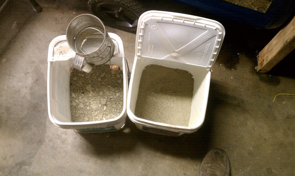

the scenery was done by using demagnetized and sifted decomposed granite. here's two buckets of "prepped" granite, you can find this in hilly or mountain areas (midwesterners....I wish I could help you on where to find decomposed granite) sifting was done by pouring it into a screened bowl (i think it was a collander from the dollar store) and shaking the collander into a bucket with the bigger leftovers going into another bucket.

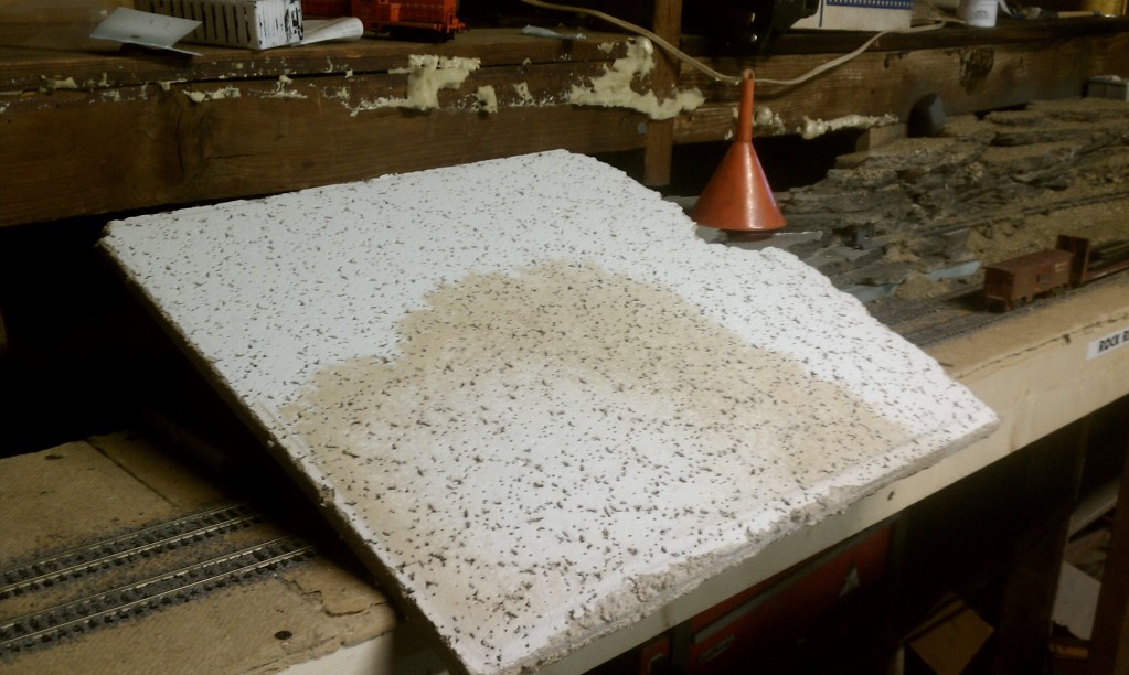

to apply the scenery I first saturated the area with "wet water" (water with a drop of dish detergent, in a spray bottle) then used an old flour sifter to apply the "dirt"

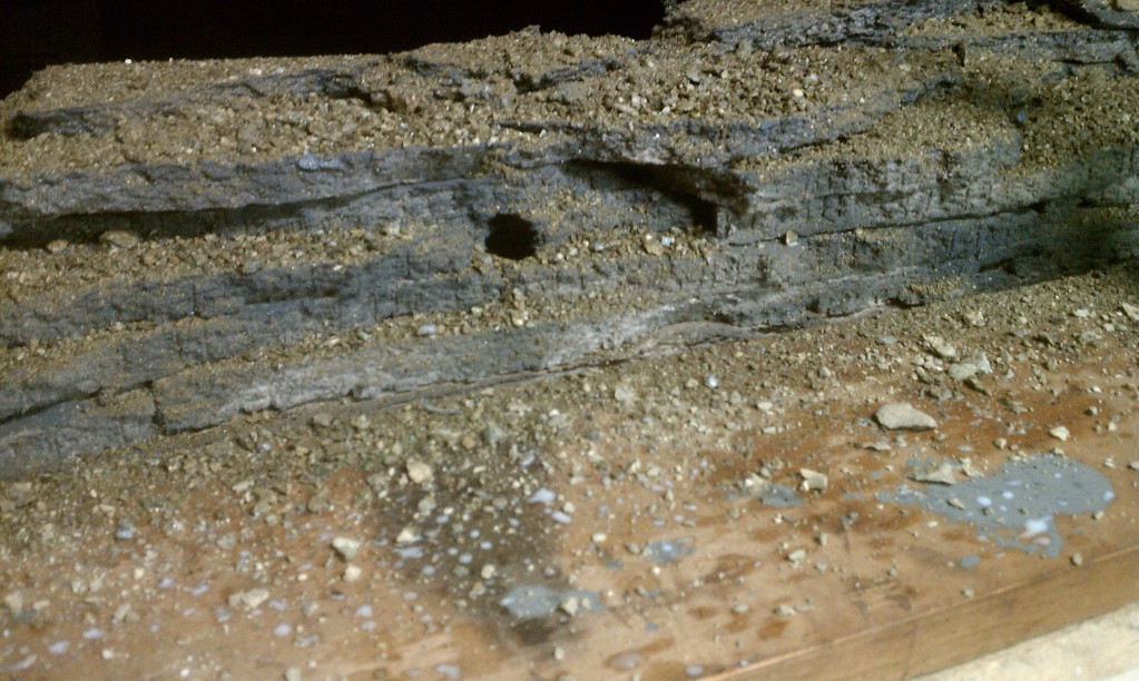

then I added the "bigger rocks" to give it a more rocky look

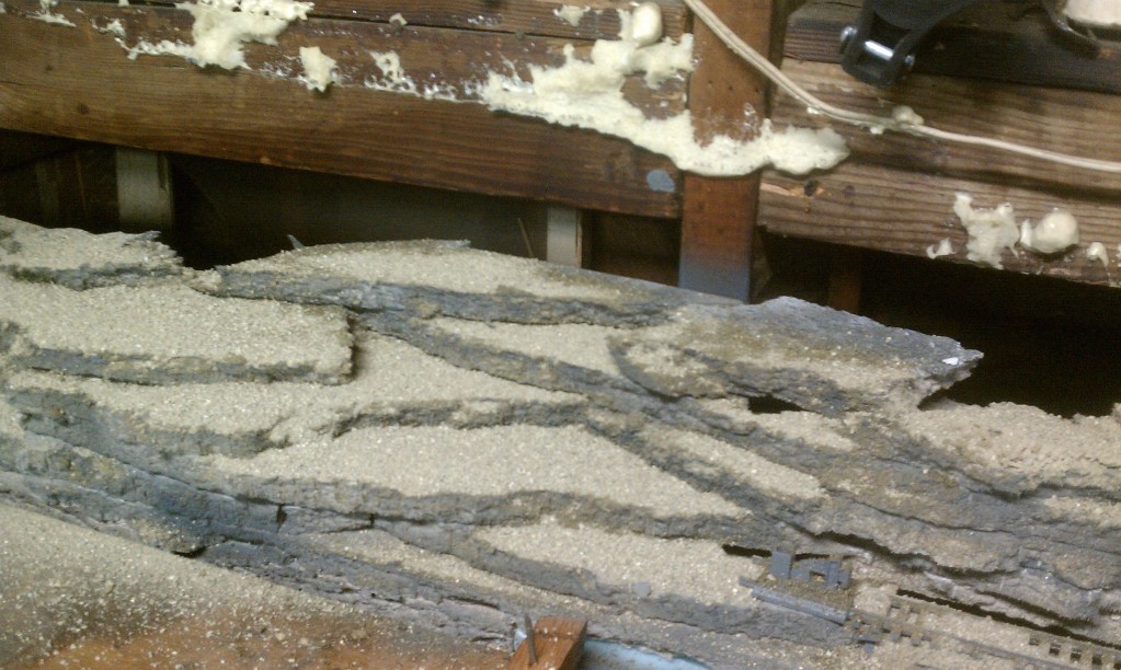

finally I wet it down again and then sprayed a 50-50 glue water mix (the cave was unintentional but it looked cool )
you may have to go over it a few more times, first "soaking" it and then adding the glue-water mix.
NOTE: when you are done, run the glue-water sprayer with the wet water to clean it I learned the hard way!
there you have it, and now rock ridge has a.....rock ridge!

 Posted - February 01 2013 :  03:41:02 AM Link directly to this reply  Show Profile  Send zebrails a Yahoo! Message  Add zebrails to Buddylist
Put teeny bones outside that hole.
If this was a "cut" for passage, you may want to add vertical slices from a narrow or jewelers file.
A narrow-shallow ditch between the bottom of the rock-face and rail-ties... a small culvert for possible "spring-found" locations just above.
Nice job!
