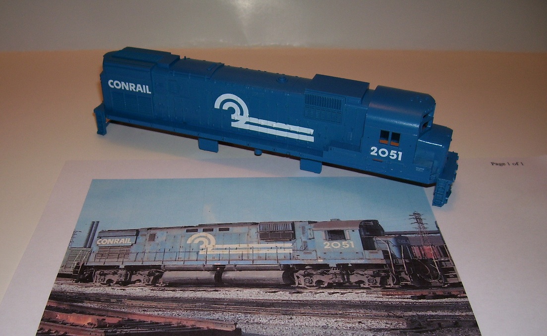

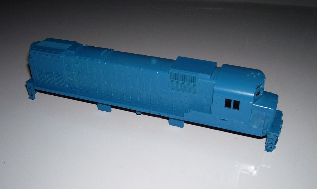

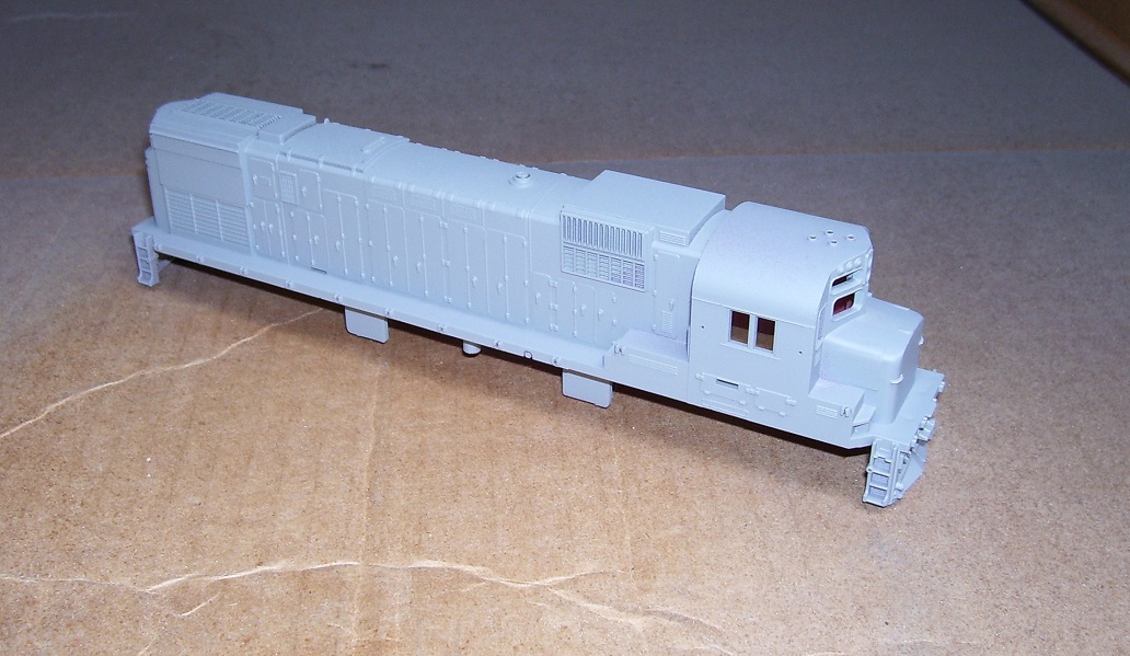

I couldn't find where I posted this before. I was asked to paint a C430 like this and started looking through the pictures. I cleaned up and old MU2 C430 shell and primered it over the original SF paint. I airbrushed the shell with Badger CR blue water soluable paint and then added the decals. I think you might be able to get the paint mixed at Napa and put in a rattle can.

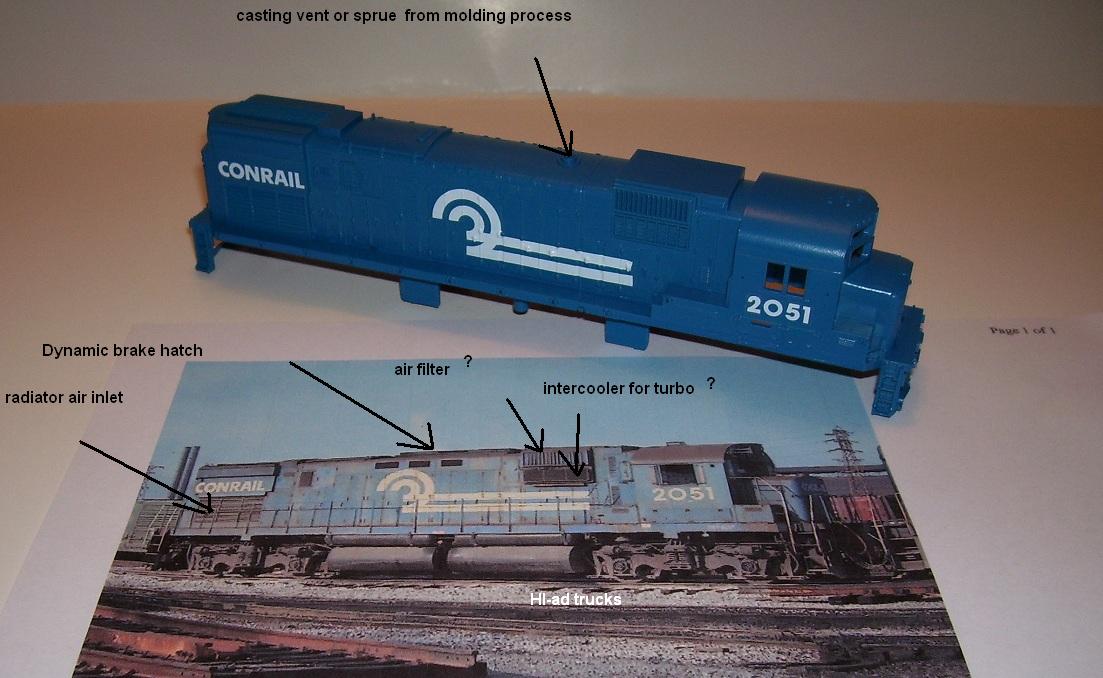

In that last picture of the shell next to the pic of the real unit, on the roof behind the cab, what's that box structure? Dynamic brake grid? I wonder why the box on the Tyco shell looks like it stands up a tad higher than on the prototype?

The more I look at the prototype picture, is that the dynamic brakes above the Conrail can opener logo? Maybe the box behind the cab is air intake, and the side parts of that box are filters or grids? Is this Conrail unit riding on Alco's Hi-Ad trucks? I wonder how Tyco settles on the then-new Alco Century line, and to model the C-430 and C-636 out of all the prototypes that could've been modeled?

Tyco did that C430 before Alco went out of business, I don't think anyone knew how few were going to be sold. A few of them had the regular drop-equalized trucks, the pair sold to the Reading anyhow. The vents on top middle of the hood are related to the dynamics, I believe, but you might google up and see if there are any specific articles on these or on the Century series in general for more information.

I doctored up the picture to illustrate some parts. I am not 100% sure on the air filter and intercooler. fairly certain, though.

I guess I never paid attention before, but WOW, the C430 fuel tank should look like something on the C630. That C430 really does look a lot better with a prototypical paint scheme though.
