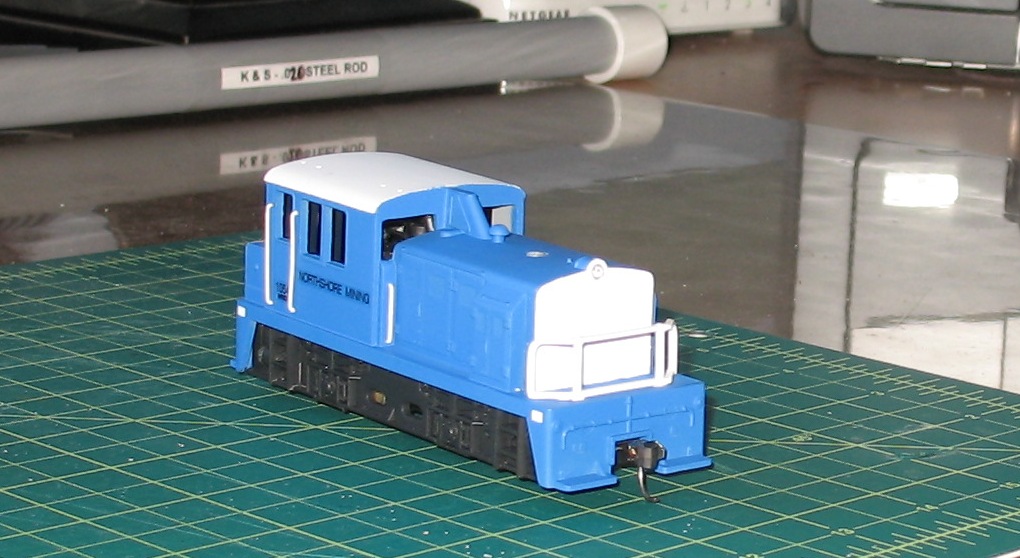

You may recall my recent MDT rehab project- the first diesel was done in a blue and white scheme for a northern Minnesota mining company:

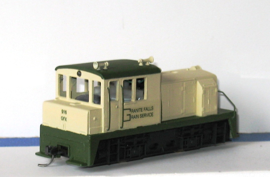

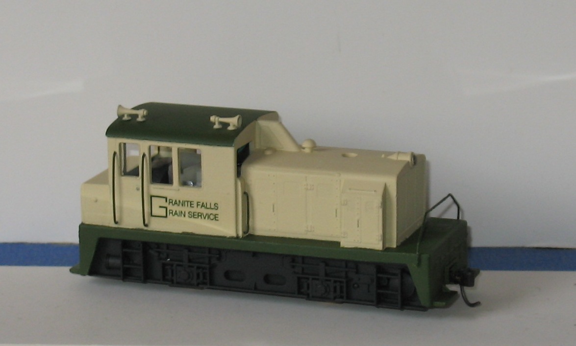

Well, I finally completed the painting and decals for the other MDT I was rebuilding:

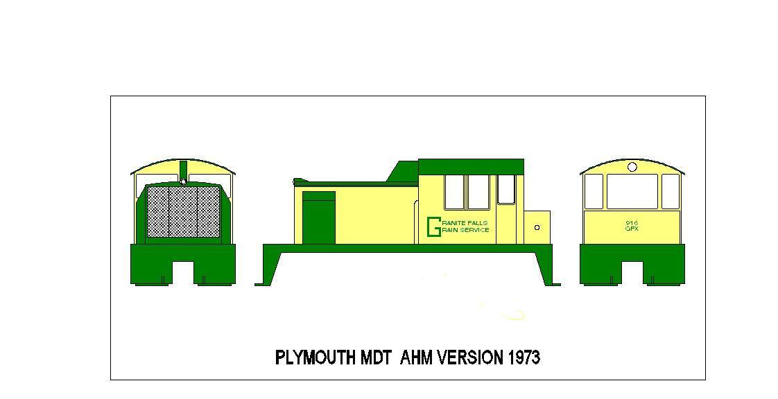

The original concept had a more yellow color planned:
I ran into trouble using Krylon Indoor/Outdoor Gloss spray paint, "Bright Idea", a corn-like color, as the edges of the model showed through the paint, and the paint itself was "heavier" than I wanted. I decided to switch to Model Master Desert Beige, where the texture is flat and the finer pigments lay better on the model, without blurring the details.
These Krylon colors work better on flat, less-detailed surfaces, as I was able to paint a box car easily with that same yellow color.
This leads me to think that it's time to become more of an airbrusher than I have been- I am a little hesitant about thinning paints properly, although I had no problem with Badger Modelflex Orange for my railroad color directly from the bottle, as it is pre-thinned.
I made the grabs and the front railing from .020 steel wire and reverse-wired a 3mm round top LED for the rear backup light (with a 470 ohn resistor, drilled where there was no light previously. The front light was replaced by another 3mm LED- a flat top- that used some reflective tape on the inside of the hood to enhance it.
As this model had a tight fit with the new motor, I didn't put any plastic tinted windows in- as was the case on the blue and white MDT model- but in close work at a grain facility, tinted windows would be a hindrance, not a benefit.
I made the decals with Bel clear paper, but used the RGB medium green analog color to the Model Master Medium Green I used on the cab top and the chassis for the lettering.
Granite Falls. MN sits southwest of the Twin Cities on the northern edge of the midwestern corn belt that runs through the center of the country, hence my desire to use a corn-like color in the scheme (the reason for the green is obvious). The actual town is very picturesque (as per the internet) and they do have grain elevators in the area serving the farming communties. The real town is within the "service area" of my MSL&W railroad, so it would be reasonable to see one of their engines up at the Sioux Lake Engine and Yard Facility being worked on by the shop and paint crews, to gain some income for the railroad.
As a late transition-era entity, the folks at the grain facility were tuned into modern graphics of the 1950s, hence the use of a large "G" and the remainder of the company name as it appears.(rumor has it one of the local high school drafting students came up with the logo in a scholarship competition- the young man went on to earn a mechanical engineering degree at U of Minnesota and recently retired from Mosaic, one of the large national agro companies).
Hope you like it- that ends my desire to work on the MDTs- two restorations are enough for my small pike. But, I never say never- if the right one comes along in reasonable shape.

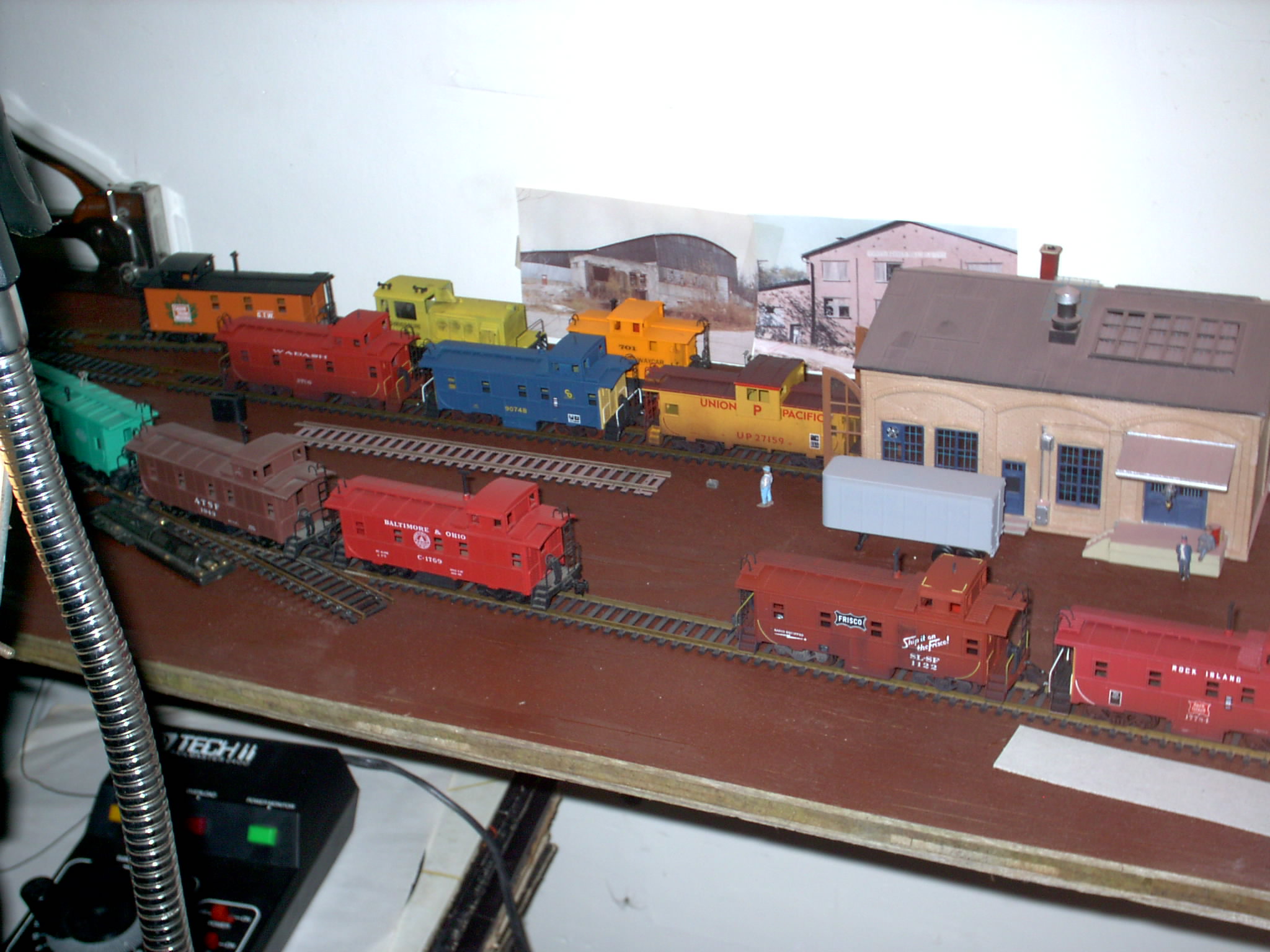

Nice job...I had one of those once I was fond of...but I didnt do any "inside" work on it.
In the background of this photo...the shop switcher...

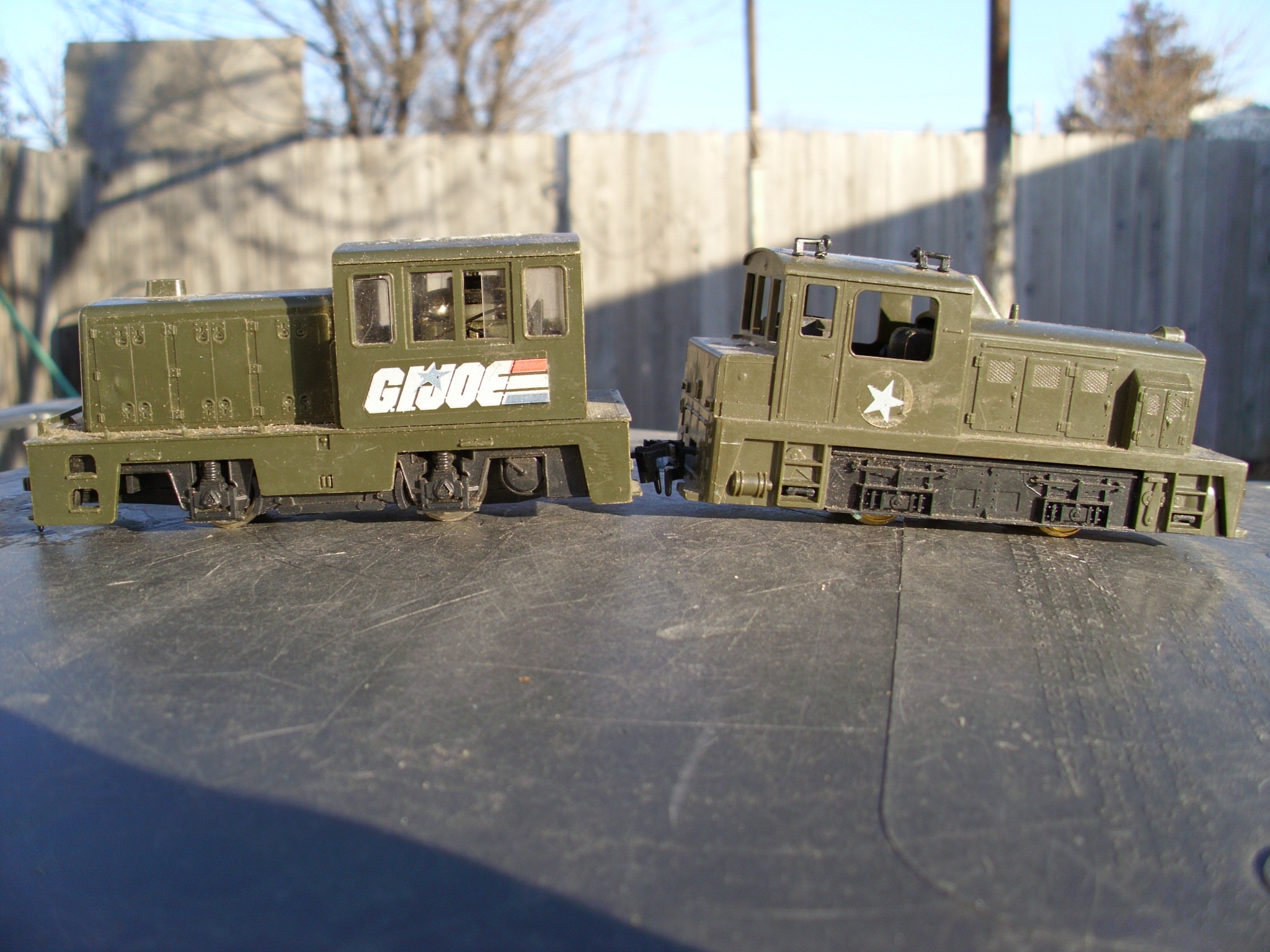

 Posted - January 21 2013 :  12:57:19 PM Link directly to this reply  Show Profile  Add microbusss to Buddylist
very good work
Maybe someday I'll get you to redo my G.I. Joe & Rambo locos
Jim
BN
 Posted - January 21 2013 :  4:54:49 PM Link directly to this reply  Show Profile  Add Jim to Buddylist
hmmm G.I Joe and Rambo locos?? do show pics!!! nice MDTs too!!!
 Country: USA  ~  Posts: 145  ~  Member Since: September 26 2012  ~  Last Visit: December 23 2013 Alert Moderator  Go To Top Of Page
 Posted - January 21 2013 :  7:28:31 PM Link directly to this reply  Show Profile  Add microbusss to Buddylist
well ok Long as caboose1 doesn't complain Which he won't
Well the Rambo loco was gutted by me years ago cause it didn't work
So its a dummy now

Jim
BN
 Posted - January 23 2013 :  9:52:43 PM Link directly to this reply  Show Profile  Add Jim to Buddylist
Very nice G.I Joe engine!
