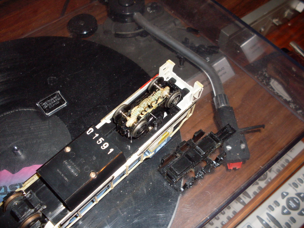

If they're the basic Life-Likes, they'll have only one power truck, probably up front. You'll need to remove the cover from the gears. It snaps over the bottom of the truck. The coupler box is part of it. Basically, you CAREFULLY pull up the coupler box and it will snap the cover off. This will expose the gears. You can clean/lube them and then snap the cover back on. Here's what it looks like.
The same can be done on the rear truck, but you'll just find pick-up wipers and wires. They only need to be cleaned to remove corrosion. When you put the cover back on, be sure the wipers are tucked into the right place.
Above all be careful, lots of fragile plastic. It's easy to snap the cover or break railings while handling them.

Thanks for the info, it helped when lubricating my F7 and GP38-2s!
Nice phonograph in the pic, too
