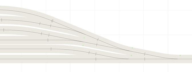

Atlas makes a relatively small snap switch. I would use that for a yard. Obviously, the design of the yard can help. A ladder style (lead in tracks, at the ends of the yard, are angled toward each other) yard runs out of room quickly. A way to get more room is have the lead in tracks parallel to each other. That probably didn't make much sense. I'll try and get a picture.

Here is what NCS is talking about:
Here are two other tricks for lengthening yard tracks:

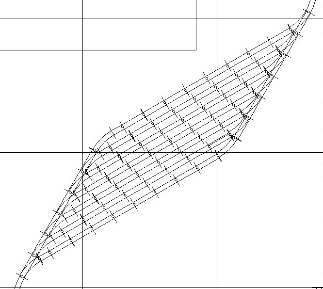

A curved, or pinwheel, ladder:
(Kenneth L. Anthony)

Thanks, Glenn, for chipping in with the drawings.
Which software do you draw those with?
 Posted - January 01 2013 :  12:15:00 AM Link directly to this reply  Show Profile  Add gmoney to Buddylist
I must confess I "borrowed" them. I should have given credit but I was short on time; will do my best to rectify that!
Edit: I did my best to give credit where credit is due, but could only find one of the drawings.:( If anyone knows who deserves credit for the others, let me know.
