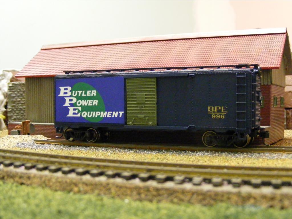

Well I said I was going to work on nothing but stuff for my layout this winter. Right up to the point where the opportunity came along to build a few unique xmas gifts for my friend from things I had laying around. There were 4 projects total, each one has been making my life as difficult as possible lol.
Some quick background. He owns his own business that sells lawn mowing equipment. I ALWAYS wanted to make a one off boxcar of his business name on the side. I thought that would be pretty cool. His other love in life other than trains is Porsches. He owns a few older ones that are 911's that go between autocross on the weekends and carrying him to work on nicer days. Strolling through a Walmart one night I spotted this.
I think it was like 74 cents or something. I have NEVER repainted a hot wheels car before. But the idea intrigued me. I fashioned up a paint scheme based off a older 911 race car that he knew real well. Then in a small twist stuck his personal racing number on it. This was what I came up with.
If I ever do another car again, it will be too soon. First paint job the paint crazed on it due to bad primer and the car had to stripped down again. 2nd time was a charm. However painting the hood was a pain since I figured it would look best spray painted. The paint leaked a bit around the masking tape so I had to do some touch up with acrylics. I had to do MORE touch ups when I dropped the thing once Then painting the bumpers blue came out very rough around the edges. I swapped the wheels from another car. However the chassis is narrower than the body that fits over it so it looks weird since the wheels sit so far in. Alas, at least its finished.
Next model was a AHM boxcar I had laying around. Remember what I said about a lawn mower business? First I built this little guy out of scrap.
Not to shabby I thought? I mean you can at least tell its a lawn tractor lol. Next up the boxcar received a repaint. I cut the logo out of his business cards and glued them into the space on the side of the boxcar after cutting the molded ladder rungs off. Added metal wheels and kadee knock off couplers. The reporting marks are again more dry transfer decals that I've been playing with. This was the end result.
Nifty little car, nice & clean. Where is the mower you asked?
The camera is throwing the colors off it the main boxcar logo isn't quite that blue. But this one I'm actually happy with. A little delivery photo, and PRR FA-1 helps shove the BPE boxcar down the unloading track while the Porsche checks out the load inside.

Awesomesauce! Some real creative thinking there, and I love the mower: looks great! I need to keep this kind of stuff in mind if I ever have the time to expand or create scenes - to kitbash my own details. Really great work as always, Chris.
Also like the decals you made - the alignment and kerning on the text looks straight and professional, which is not easy with dry transfers (nor appreciated by those who haven't tried). Superb!

I'm glad the mower is a hit haha. If it wasn't for display inside the boxcar I could up the detail a little further. Sand the edges off the hood till they are rounded. Add in a piece of flat styrene under the mower to represent the mower deck and another very small piece for a steering wheel. Tony my Dad use to be in graphic design, before computers, so the words "alignment and kerning" are not lost on me ;) I can eye ball that stuff pretty easy. Actually in the pics your seeing the bad side. The decals just transfered a bit rough the other side looks much better. First time using dry transfers, what a trip they stick to everything lol.

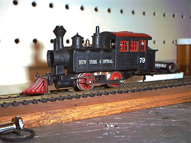

The teakettle....what a POS haha. Hyde are you refering to the drive wheels being two different colors? No clue what happened there, was like that when I got it. Both wheels are black now to hide that fact. No clue if it will run when I'm done. The motor I aquired from a kids battery operated hand drill so I doubt it would last real long at full power on a layout. That's ok though the whole thing is so shoddy I think this thing is going to be a yard display engine. I consider Teakettles a challenge though. From the shoddy driveline to their obnoxious looks. They were built for kit bashing lol. I didn't do anything major looks wise its more of a repaint. But still it does wonders for the looks.

Chris, the replacement drivers came from one of these. http://www.ho-scaletrains.net/ahmhoscalelocomotives/id87.html
I've done a lot of work on them, so I recognized them right away. A set of those would look better then the LL originals.

Those Tea kettles bring back the horrifying memory of rebuilding mine.
I found replacement gears from other locomotives and old toys but didn't like how it ran so I made a whole new gear system to drive one axle and made a set of new rods to drive the other.
Ray

Ray, please tell us more on the new gear set up! I have seen the Silvine/New One version of the infamous Teakettle 0-4-0T. A friend of mine has the newest version and its a ok runner. Wondering if that boiler could be retro-fitted to a better 0-4-0 chassis?
Originally posted by Redneck Justin - December 18 2012 :  9:51:09 PM
I think putting the boiler on another frame would be easier than what I went through.
I put a larger gear on the front axle and drilled new holes in the metal plates for a different idler gear. I also replaced the open frame motor with a can motor.
If the newer version doesn't run bad it might be worth finding new gears for.

Well I'll be a son of a......tonight for the first time in many years. The Teakettle hobbled (literally) across my test track on the work bench.
The tape on the front is just to hold the pistons on since that little piece you see at the bottom of the photo decided to break off. I knew something else would have to get in the way I'm betting on a fairly short lifespan with this motor. So the best I could managed was to just glue it down to the chassis. Oddly enough I got the gears shimmed about right. If the main gear didn't have the screwed up tooth it would probably make a attempt to run better. On the rear of the motor I glued on a piece of styrene to hold the motor down. The electrical contact you see on the picture was the one that was missing. I replaced it with a shoe from a slot car and it seems to be working. I'm amazed it moved at all. When Ray calls something horrifying that's a signal to abandon ship lol. Its going to need a whole new front pilot section. But other than that its basically down to cosmetic stuff and it will be ready to....ummm....hop down the rails.....briefly.

Nice job with the Tea kettle Chris.
I like the pilot.
How many teeth are on (should be on) the gears you need? Maybe one of us has them.
If I remember corectly, some of the gears from one of the earlier Life/Like diesels (Uni-Drive) would fit in the Tea Kettle.

That's a 100% improvement in the look of that old teapot. I like the wood beam pilots.
The worm on the motor looks like it's twin lead, which means it has two threads and will turn the idler gear twice as fast as a standard single lead worm. If you find replacements for the cracked gears, a single lead worm will slow it down and make it less toy-like.

Thanks for the complements on the Teakettle! I didn't intend to build a new pilot till the old one basically fell apart. All the pieces of styrene and most the balsa wood was just sitting on the bench haha. Though I'm pretty happy with it I definitely think I'll do something similar again with a little more effort. I'll check the gears Ray and see how many teeth it is.

The Teakettle did exactly what I expected it to do. It actually ran like a bat out of hell for awhile. Then promptly stripped its main gear Least we think that's what it did. However there is talk of getting it back on the rails again down the road its been well recived at its new home. The fact it was able to run for a decent while at all was impressive for the effort put forth. The redesign came out pretty well so I'd like to see it move again too.
The boxcar has performed well in revenue service so that's good. The caboose will wait till we get it some proper NYC decals.
