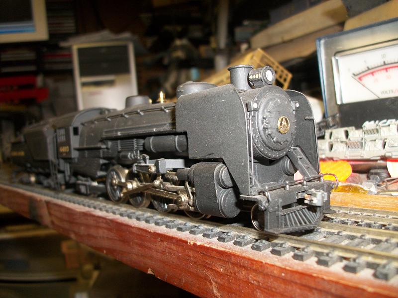

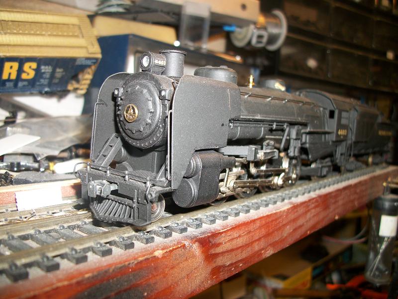

You have a MAJOR point there, I don't disagree, by any means.....The projector sheets, I got for free, and I have a case of packs of them! All came from the school that I worked at as they tossed them out when they replaced the projectors with digital screens, or "Smart Screens" that I myself, hung on the walls, of each classroom.
I just could NOT allow that clear plastic to be thrown away!
Which brings me to this:
The smoke deflectors "Elephant Ears" were made from "blister pack plastic,. as it had the correct curvature at the top to make them from scratch as there is none factory detail parts to fit the application on a B&O 2-8-2......Which, is close to what the B&O had as only 2 locomotives on the B&O roster had......The pictures I have of these 2 locomotives, the smoke deflectors are slightly different! I made a brass frame behind them, for mounting them to the boiler and boiler walk.
Just a good example of the uses of blister packs "plastic"....

You made the lovely smoke deflectors, for the 2-8-2 rebuild I envy, out of blister-pack scrap material? It certainly doesn't look like it was made of packaging material!
