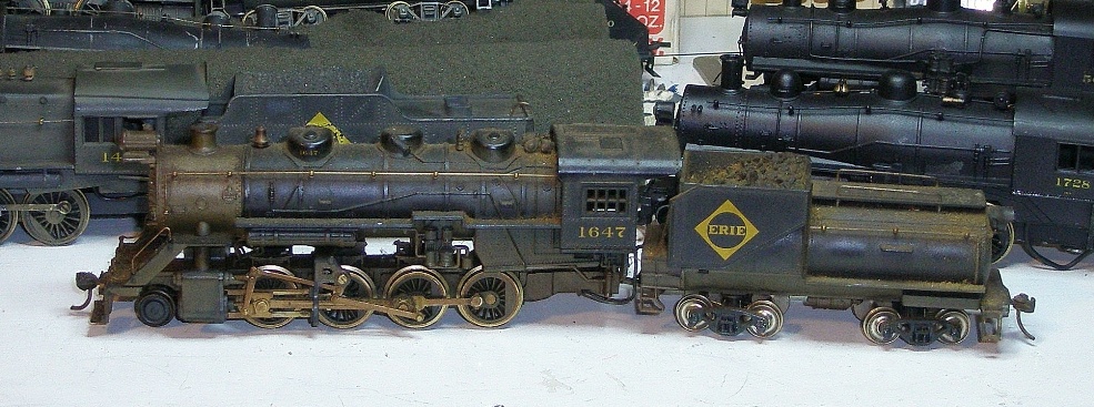

I too have done just what Justin is asking.....
I also took a TYCO 0-8-0, and turned it into a 0-10-0! As seen above!

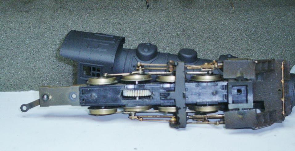

I have done 3 of them. This is a photo of the first one. You can see the worm gear and part of the frame of the Tyco-Mantua motor.
toptrain1 frank

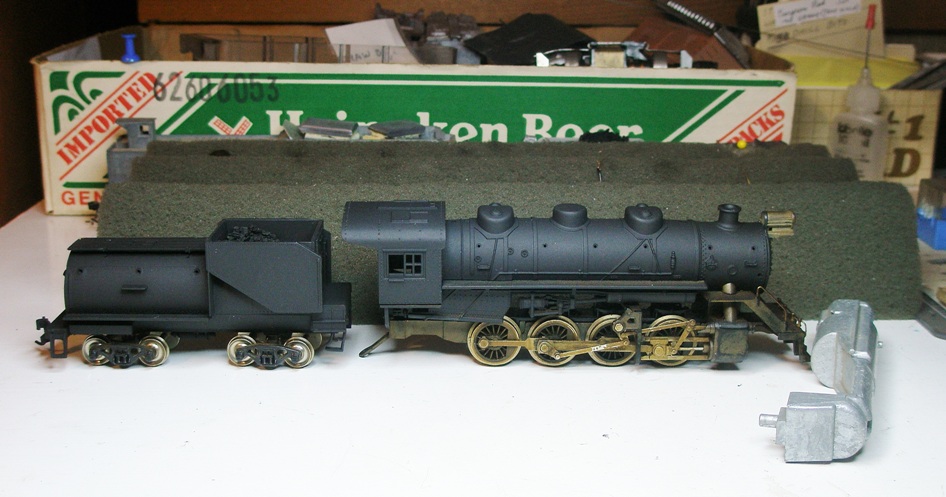

Last one is a engine I recieved from a friend Louie. It is nickotine coated. With a MDC vanderbuilt tender. I recieved it as a dummy loco. With the smoke unit removed and this tender added.

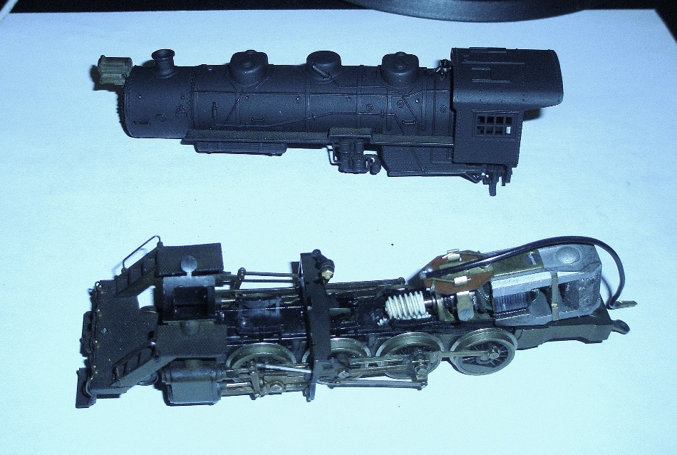

I cleaned up the boiler you can see I missed the head light and steps.
Here is the drive with the gear added.
Here is the frame done, with valve gear intact.

Frank, was the frame grinded down any? I can't believe that nicotene stained it that bad!

I could be wrong, but it looks like the gear Frank used is the larger gear from the Mikado and Pacific.

Ray you use what you got. Moer fileing had to be done. Same worm gear.

Justin , Just had to file out the hole.
