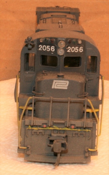

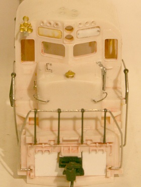

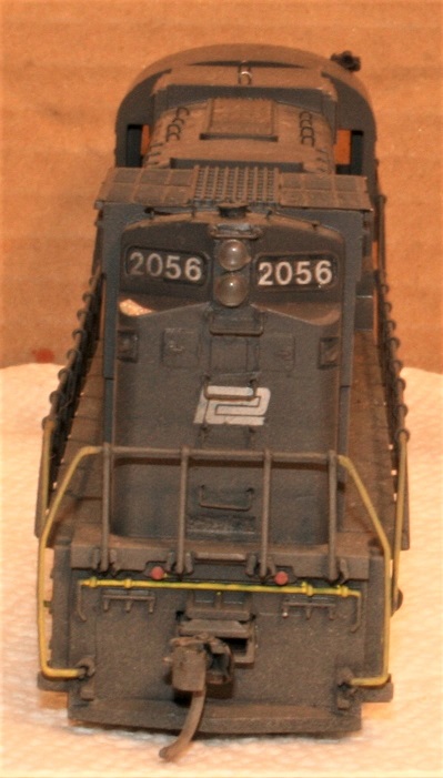

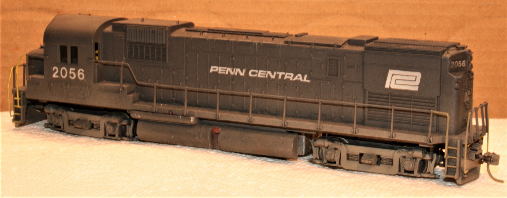

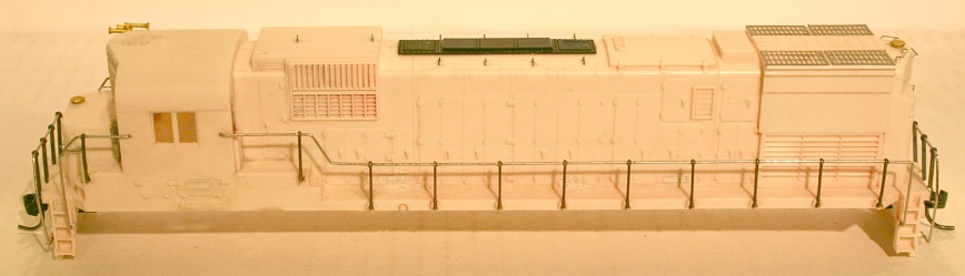

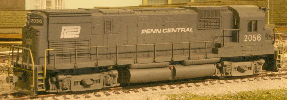

This is my latest project, I had a Rock Island Tyco C430 locomotive that had a dead power torque motor so I rebuilt this engine with a lengthened Athearn U-Boat frame and repainted it in Penn Central colors.
Here are some pictures of the project's progress..

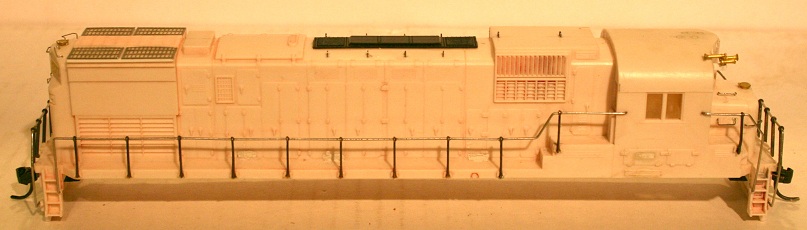

As you can see I removed the angular U-Boat style fuel tank and replaced it with plastic Alco fuel tank parts from Atlas. Other detail parts I added included hand brake, sand hatches, photo etched radiator grills, grab iron, lift rings, and horn. I also filled in the pilot and mounted Kadee couplers to the shell.
The engine runs like a charm and looks great, what do you think?

What a nice kitbash! You'd never know that once it was a Tyco!
Srenchin
CNRedAvatar
 Posted - November 17 2012 :  4:45:55 PM Link directly to this reply  Show Profile  Add Srenchin to Buddylist
Yes, its amazing what a new paint job, some details, and some weathering can do for an old Tyco model. Of course if you compared it to the new Bowser version of the C430 you would probably see a lot of discrepancies.

A really excellent kitbash. One of my favorite subjects Nice extra super detailing too. I wish I had done it first. Well done!
Creative,using the lengthened chassis and nice custom tanks.
This is a LOTW model.

That looks AWESOME! I've never been a big ALCO an......BUT, I would have a few of those if my 2 main railroads I model had them!
As mentioned prior to my posting, you would NEVER guess that was a TYCO! LOOKS AWESOME! Gonna be in CN paint?

Well done! The finished loco looks real sharp.

Another beautiful job! Do you have any pictures of what's under the hood, and how you lengthened the frame?
 Posted - November 17 2012 :  11:27:28 PM Link directly to this reply  Show Profile  Click to see EM-1's MSN Messenger address  Send EM-1 a Yahoo! Message  Add EM-1 to Buddylist
Nelson,
I don't believe Scott stretched the frame on that unit! The unit looks to have Athearn trucks, and the fuel tank seems to have positioned to the "tabs" that TYCO had on the true TYCO model in front and behind the TYCO fuel tanks.....
I could be wrong however, but I would say that the ends of an Athearn frame might be the only "frame" part used under this C430!
However it was done, was accomplished VERY nicely! (I re-power A LOT of shells with Athearn frames......)
With that being said, you look at my IHC FA-2, or ANY of my most current TYCO RF-16's, A or B units, and they will have Athearn frames, milled to fit the shells! As well as ALL my Bachmann diesels from the 1980's.....

Actually I had to use two Athearn 4 axle U boat frames for this project, when I get a chance I will post pictures of the modified chassis. It all came down to the distance between truck centers, as I recall most 4 axle U boats have 36 foot truck centers and the C430s have 37 foot truck centers. One scale foot doesn't sound like much but when you put an unmodified Athearn U boat drive under the C430 shell, the trucks do look to far inboard from the steps to look right. I fixed this by supper gluing two frames together adding one scale foot in the fuel tank area. Since I mounted my couplers on the shell, I removed the coupler mounts from the chassis and I also sawed off the sides of the angular style GE fuel tank to accommodate the new Alco style fuel tanks. As I said, when I get a chance I will post photos of the mechanism for further clarity...

Did you add the tanks to the TYCO plastic "tabs" that came down from inside the shell or did you fasten them, to the frame you made to fit?
Nice work anyway but was a "wonder" for me as it looks really good.....NICE work!

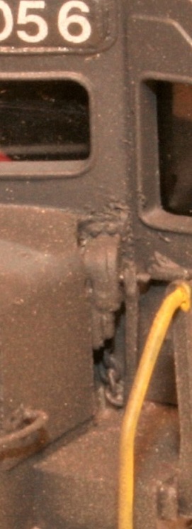

Another question on this model, did you use the TYCO pilot point thats at the bottom edge of your "filled in" pilots? I can't tell for sure, but that looks so much better then that gaping hole that was there for a swinging coupler!
I had a look but its difficult to tell what you had done in that area!
Originally posted by EM-1 - November 18 2012 :  12:22:24 PM
I'm glad you noticed the filled in pilots! I personally think one of the best things you can do to improve the appearance of a Tyco hood unit is to fill in the gaping hole around the couplers and then body mount the couplers to the shell. The Tyco C430 shell I had to work with was in excellent condition with pointed pilot bottoms intact. Of course it was only after finishing the model that I noticed that the prototype PC C430's didn't have this feature. Oh well, as I said before, if I wanted a perfect C430 model I would have just waited for Bowser to release their version. But what fun would that be...

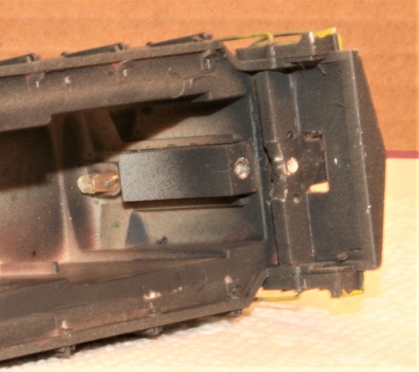

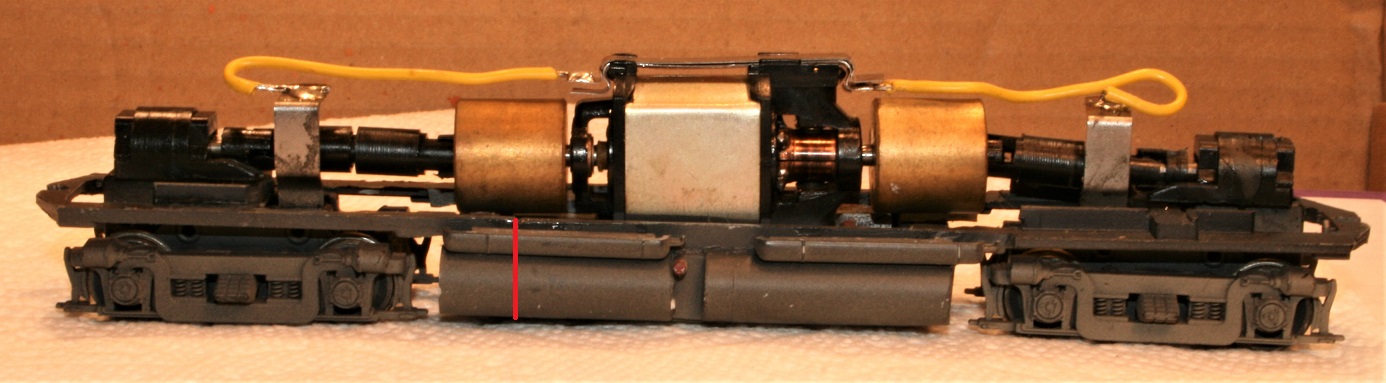

There has been quite a bit of interest in this old C430 project I made several years
ago so here are some new pictures of this locomotive. As you can see the shell
is just a standard Tyco shell with some extra details added....

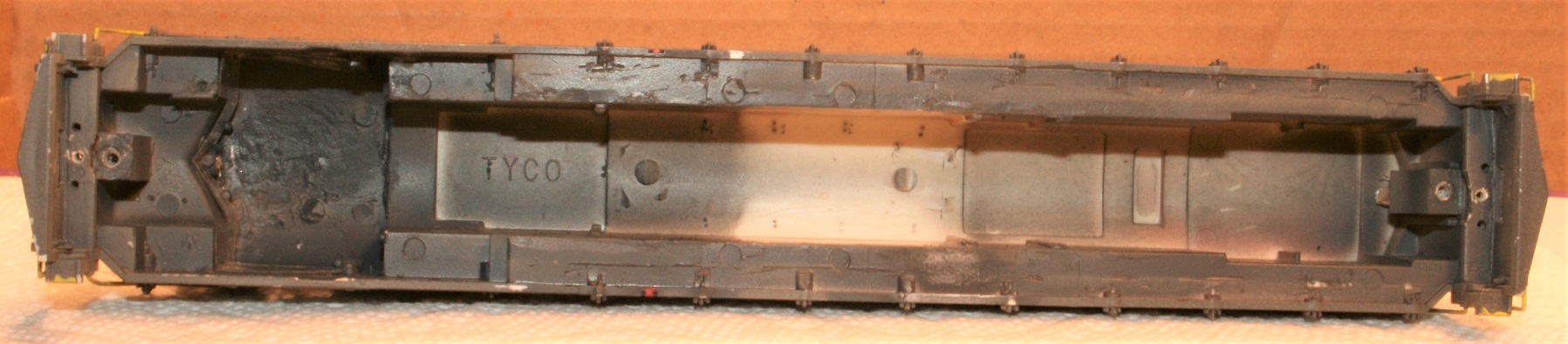

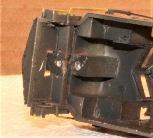

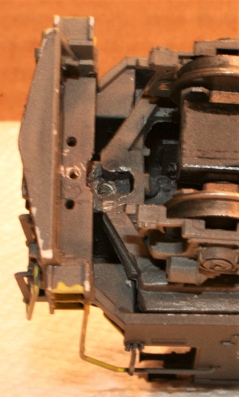

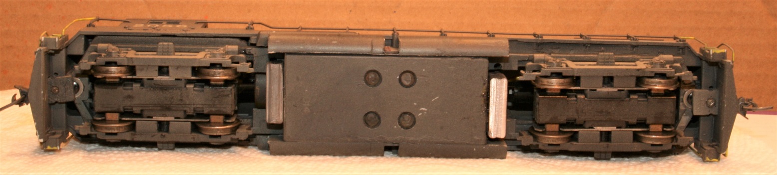

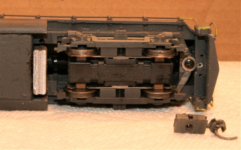

This is what the chassis looks like from the bottom, note the way I mounted the couplers to
the shell and the shell to the chassis....
To remove the shell, you first have to remove the couplers...
Here the screw holding the shell to the chassis is removed...

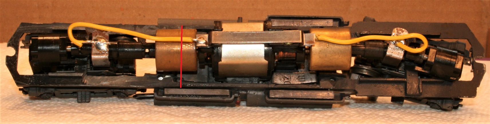

The chassis is basically an Athearn 4 axle GE "U-Boat" mechanism lengthened by one
scale foot. This was done by splicing two U-Boat frames together adding one scale foot in the fuel tank area,
the red line shows where the two frames were epoxied together. Note that I needed
to lengthen the drive line between the front truck's gear tower and the flywheel to accommodate
the stretched chassis. A manufacturer called "A Line" makes an Athearn Universal Coupling
Assortment kit that provides the parts for this modification.
This top view of the chassis also shows the splice line.
In order to attach the shell to the frame, I added styrene square rod to the interior of the shell
to create mounting posts...
Note how I used styrene plastic to fill in the pilot and provide a place to mount the Kadee coupler pockets.
The hardest part of this project was cutting the Athearn frames apart, I used a Dremel tool at the
time but now I would use my band saw. The rest of the project was pretty easy, just a matter of
applying detail parts and painting. Feel free to ask any questions for clarification.

229-132 Hand Brake (You will need to make a notch in the short hood next to the front cab door to add this part)

Remember, for my C430 I used styrene to also build up a place to mount my couplers and
to create interior mounting posts (made from .250 X .250 Strips) to assist in attaching the

The biggest flaw in my model are the truck side frames, Penn Central's C430 locomotives
rode on Alco's unique Hi-Adhesion trucks rather than on the standard AAR type B trucks
that are found on my model. When I made my model I couldn't find any "Hi-Ad" side frames
so I compromised with the AAR type B's.
However if I had to do this model over again I would purchase "Hi-Ad" side frames from
this 3-D printer here...
