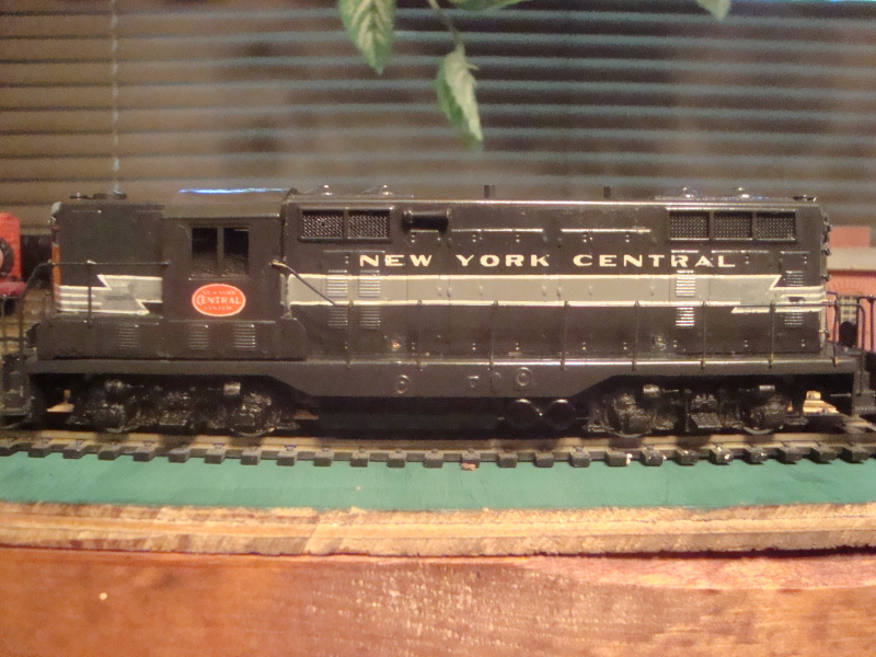

cadetpwr
 Posted - October 15 2012 :  2:19:59 PM Link directly to this reply  Show Profile  Add cadetpwr to Buddylist
She arrived in todays mail, I have her all torn down on the bench right now. The rubber tube from the motor to the one tower drive truck was hard as a rock, had to cut it off the shafts with my side cutter. All the old grease cleaned out, new grease added. I wanted to put the drive shaft coupler from an Athearn F unit in it, but I am missing the four pronged piece that goes on the worm shaft of the Athearn truck assembly. So I had to put a new rubber tube back in for now. Anybody got one of those four pronged drive shaft coupler pieces in thier junk box? Need to reglue 1 headlight lense and renumber 2 numberboards. The original paint is really nice. From the looks of the box, I think this is a first run model, box is narrower and has no markings of "Tenshodo" on it. Even the engine lacks the usual enamaled brass Tenshodo plates on it. Gears on the tower drive are encased in the truck casting, instead of exposed like later models I have owned/worked on. Once I upgrade to 8 wheel power pickup, she will run really nice, smooth now with just a bit of stutter when crossing over plastic turnout frogs, and this is with 4 wheel pickup and the original open frame motor. Mike

cadetpwr
 Posted - October 15 2012 :  3:14:17 PM Link directly to this reply  Show Profile  Add cadetpwr to Buddylist
Exactly as the real ones could come either way, with or without dynamic brake. NYC had them both ways. She runs better long hood lead, and with the extensive wheel wear, I am geussing most of her run time was in that direction. I do notice she surges as she runs, signs of a weak motor magnet. I have a gold case Athearn motor or a different open frame. Have to see how healthy that other open frame is. If it surges to, then I will yank this Athearn motor out of the junker its in and use it. Mike

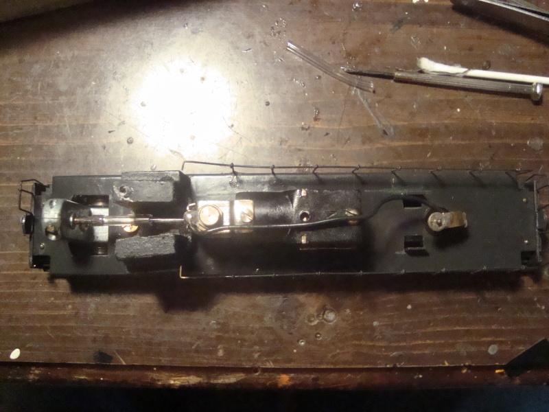

cadetpwr
 Posted - October 16 2012 :  09:41:43 AM Link directly to this reply  Show Profile  Add cadetpwr to Buddylist
Here are some fresh pics, not the one I lifted from the auction. No other progress, been busy with other stuff. Mike

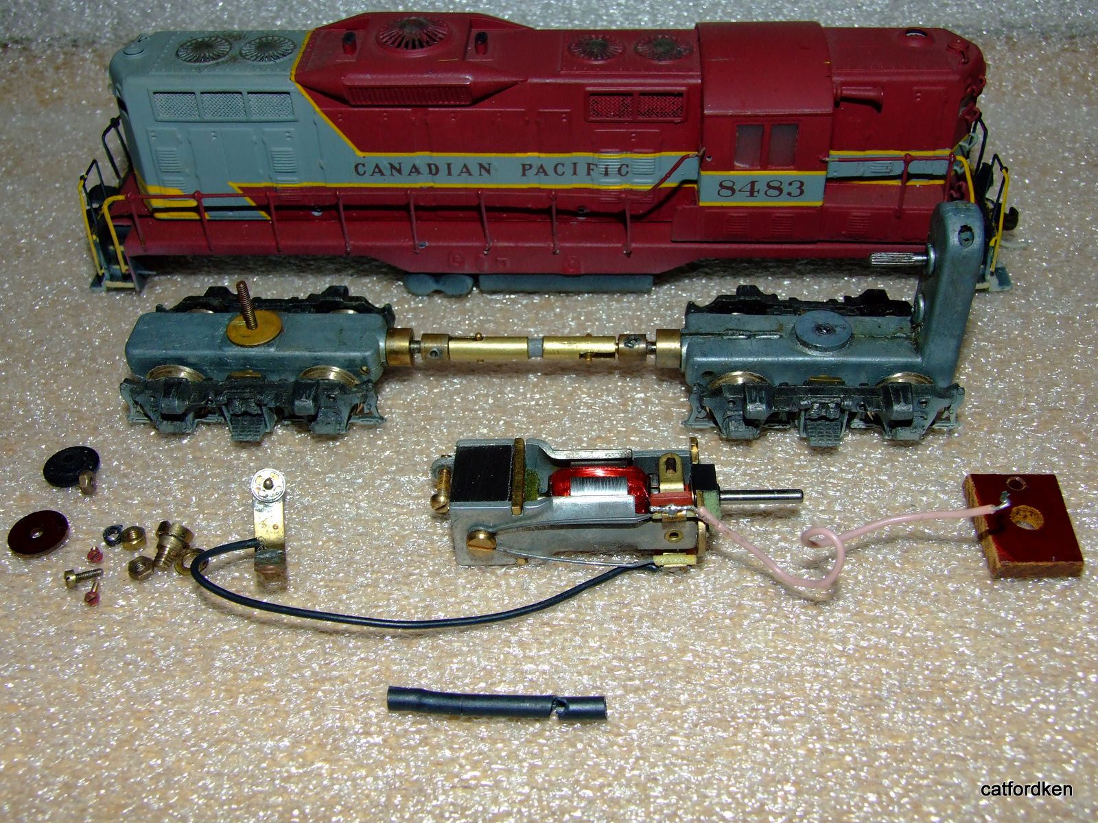

 Posted - October 16 2012 :  12:07:01 PM Link directly to this reply  Show Profile  Send catfordken a Yahoo! Message  Add catfordken to Buddylist
this should help ben understand ken

I found the Athearn part I was hunting, in a bin it didnt belong in! Replacing that rubber tube from the motor to the gear tower with some sort of dog bone or other shaft coupling that has a slip joint to it, really helps these models by removing any extra thrust action from the gear tower and motor bearings and removing any binding when the truck enters a curve. The Athearn F7 style drive shaft coupler just transmits rotational power to the gear box without any front to back thrust forces. This allows my original open frame motor to run much more smoothly. Your motor looks smaller than mine Ken. I thought Tenshodo aways used the larger open frame motor in the diesels. Mike
