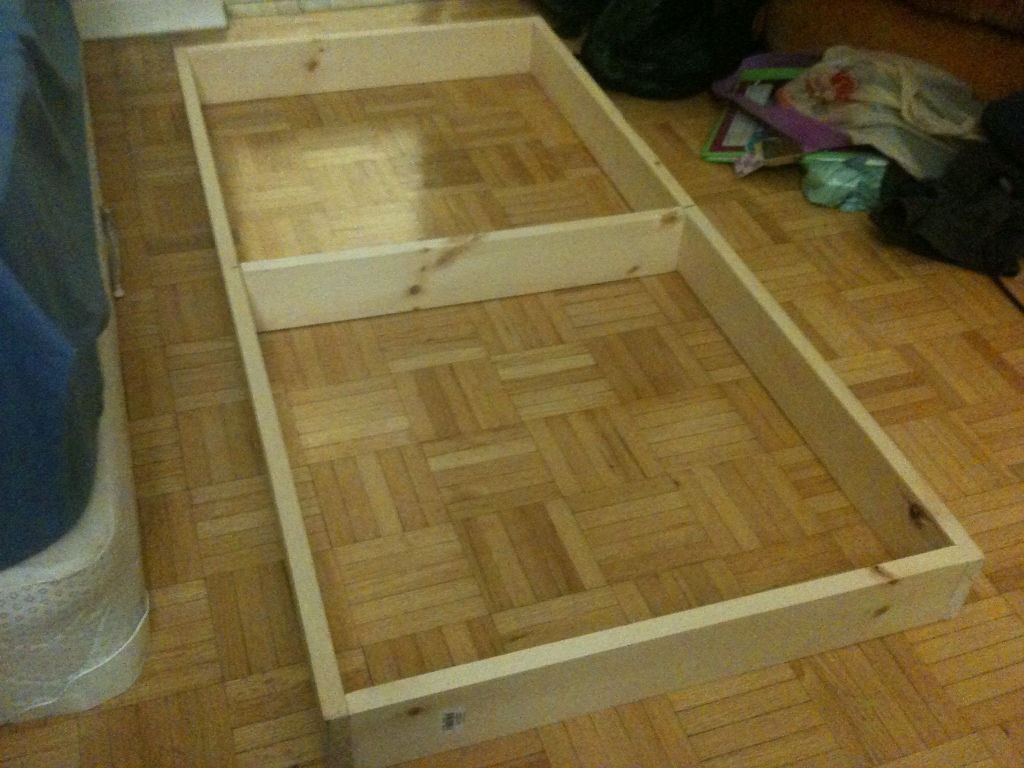

I've been planning this out for the past little while. Over the last week I've aqcuired all the basic materials needed, so I guess now is the time to start working on and documenting the progress of my newest layout idea
The layout is going to be made exclusively for Tyco Turbo Trains. I'm not sure if this has ever been done, but I think it will be fun. The theme/scenery I'm aiming for is futuristic/retro-futuristic
I'm building the layout in small sections for portability. To start off there will be two 4'X2' sections that will each hold a semi-circle of track. Basically I'm starting off with a circle...I can add more sections in later. Here's the first section:

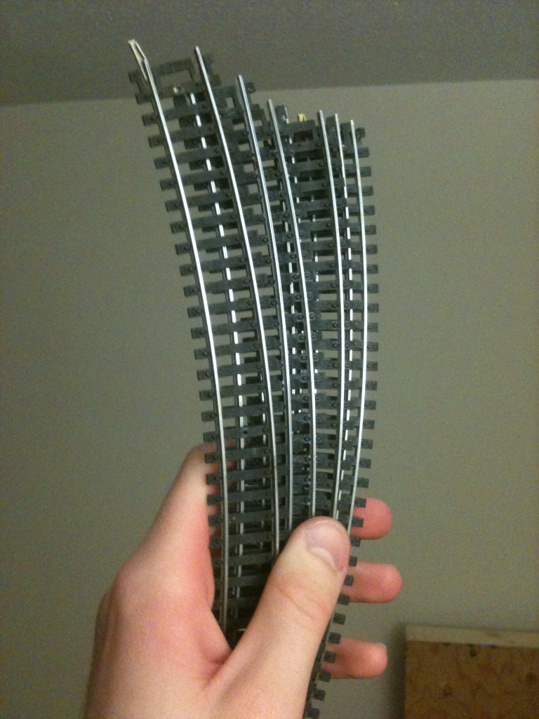

And thanks to a few members on the forum, my collection of steel track:
The first step is going to be cleaning up all those steel rails

Cleaning the rails... DO NOT use a solid track cleaner. Use a bit of petrol like Vaseline, coat the rails... Then use a non-abrasive, paper product to remove the petrol and gunk from the rails.
People, I learned to use certain "chap-lip" products. I have never had to "clean" the rails since I nailed it to my 4 X 8 piece of 5/8 plywood... that was done November 2011.
Using Homasote or similar paper-fibre/fiber product to rub the gunk off the rails will NOT scratch the rails. The Walther's "Brite Boy" puts tiny scratches in the rails. Any sort of rubber/erasure block with tiny specks of shiny material will get you cleaning the rails at least once a week.
Try rubbing one rail cross-ways or parallel to the ties... you will see the scratches.
Want to clean the wheels/flanges of locomotives? A small strip of track coated with cherry flavored/flavoured Chapstick, bumpers at both ends, wired, place locomotive on the rails, power-up the track, may need to budge the locomotive, the wheels will be cleaned and then turned over and use a Kadee wheel cleaner, there's a reason why the bristles are brass.

The best paper fiber product I have seen to clean is a brown paper bag - won't leave scratches. Mr. Clean Eraser works well also, in addition to the above suggestions.

Hey John. The problem with a lot of the track I have is not so much dirt and oil...it's RUST Will Vaseline remove rust? If it does that will save me a lot of time! The only other option I can see however is resurfacing the rails. Basically using something abrasive to take off the rust and then using extremely fine sand paper to take out as many of the scratches as possible.

] Will Vaseline remove rust?
NO
Rust is the by product of the oxidation of iron.
It can be physically removed by an abrasive or chemically removed by an acid.
Unfortunately if an acid is used it will still be pitted and rough.
I'd start with C L R or liquid Rust Out, liquid iron out mild acidic cleaners. Not sure what they have up there in in Canada. Try Home depot or Lowes. Avoid anything that says Hydrochloric or Muriatic acid in the warning
once cleaned 400-600 paper and finish with 1000 wet sand
then protect from further oxidation with the Vaseline or lip balm

Thanks for the tips Fred. I picked up some CLR and 1000grit sandpaper this morning. I THINK I finally have enough cleaning supplies to deal with the various states of the track

Cheez, try soaking those rusted sections in white vinegar. It's amazingly effective, and safer than products like CLR... it just smells worse.

I've heard vinegar removes rust. Maybe I'll give that a try as well. I gave baking soda a shot last night...it did a little, but not a whole lot.
Originally posted by NickelPlate759 - October 10 2012 :  3:41:52 PM
not a bad idea to start with something as mild as vinigar, even lemon juice.. if that doesn't cut it then C LR which is composed of a mild blend of organic acids

If the oxidation is bad enough it will leave pitting behind, but that's from the rust, not the vinegar.
 Posted - October 11 2012 :  07:59:36 AM Link directly to this reply  Show Profile  Click to see EM-1's MSN Messenger address  Send EM-1 a Yahoo! Message  Add EM-1 to Buddylist
I used to use white Vinegar at the old Body shop I worked at to clean 1030's chrome bumpers and stuff with, you'd be amazed what that stuff will do to blisters and such!
Needless to say, we were getting the bumpers ready for re-Chroming so....Worked well. I wish I had pictures to show what it done......... VERY little sanding was required only in the worse places of it did I have to sand, and yes at this body shop, hand sanding for that was thee only way it was done, no hand tools! your hand, was the tool! I just wished out of all of them, I would have taken pictures of the 1933 , Plymouth 5 window Coupe! Was a gorgeous car what it was done!

After about two hours of sanding and polishing tonight, I have finally turned rust into gold...err, steel I started out on the rails with 600 grit sandpaper, working my way down to 1000, and finally 2000 grit. So far I have 16 pieces, more than enough to start my layout. The TT power re-railer will be cleaned in the next few days and all the sections will receive nickel rail joiners. Here's the fresh, shiny rail
