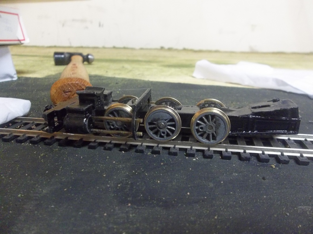

I've only had this 1950s MDC-Roundhouse 0-6-0 for 2 days and i'm already far along with its restoration!! Within these 2 days i've stripped the entire engine down, and made almost all the needed repairs on it! The biggest thing was cleaning those filthy corroded drive wheels! It took an hour just to remove all the gunk off the wheels but now they shine like new! Also all the rivets that hold in the rods have been cleaned and they also shine! The frame, cab, main rods, yoke bar, cylinders, and gear cover plate were painted today! The frame has been almost fully reassembled! The cylinders are back on and the yoke bar is back on as well! After the wheels were cleaned I put them under the frame, oiled the axles then did a rolling test and everything checks out A okay! The side rods, boiler, and wheel faces need to be painted. This will be done within the next 2 days. Enjoy the following photos of the restoration! I will continuously post on this topic everytime work is done!
SCVR #2s frame after paint, and reassembly! Wheels under frame for rolling test

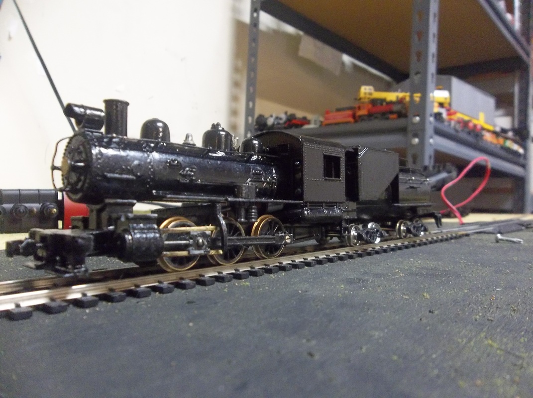

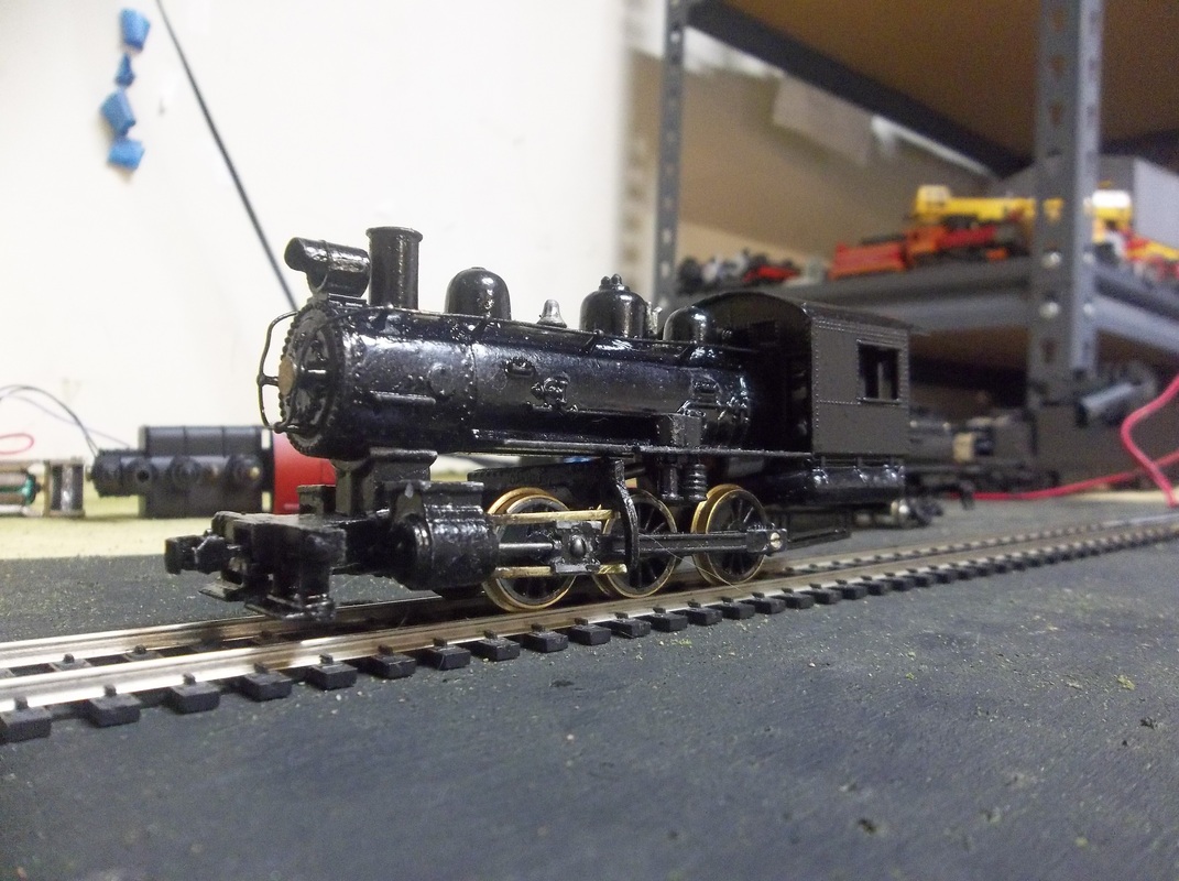

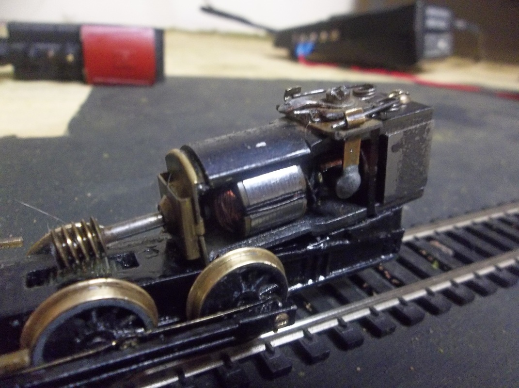

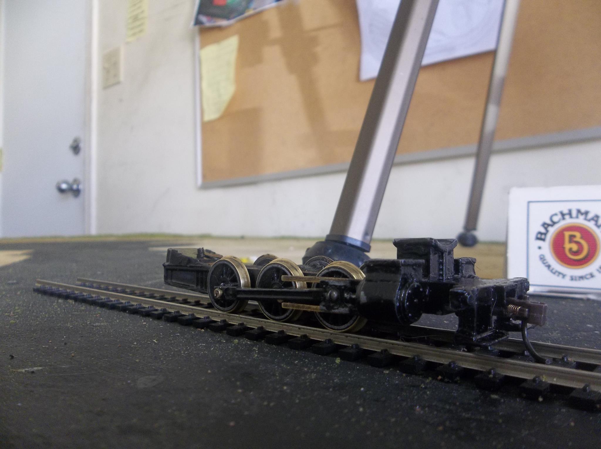

Lot of progress and a lot of struggles with my 0-6-0 #2. I always seem to struggle with MDC engines! Of my 3 that I have i've struggled with all! Anyways, rods, drive wheel faces, and boiler were painted!! The cab is back on the boiler and it looks fantastic! the running gear was where my struggles were coming from. I reinstalled the side rods and put that assembly back under the frame, and screwed the plate down to secure it in place but it seemed to tight and it wouldnt budge so i dont know whats wrong. When I put the motor on and moved it with my fingers the wheels just sparked and YES they are on the correct current sides! So I don't know why the running gear is so locked up even when fully oiled. I have it in pieces again and made sure the axles and bearings were sanded and clear of any paint but still no sign of improvement. oh well, it's time to start constructing my new layout so it has to be set aside. I did reassemble it fully for photos the other day!
here's the shiny newish engine!
had #2 borrow my IHC 2-6-0 #7809s tender which ironically is an MDC roundhouse tender
here's the motor, hope the problem isn't the repairs I made..

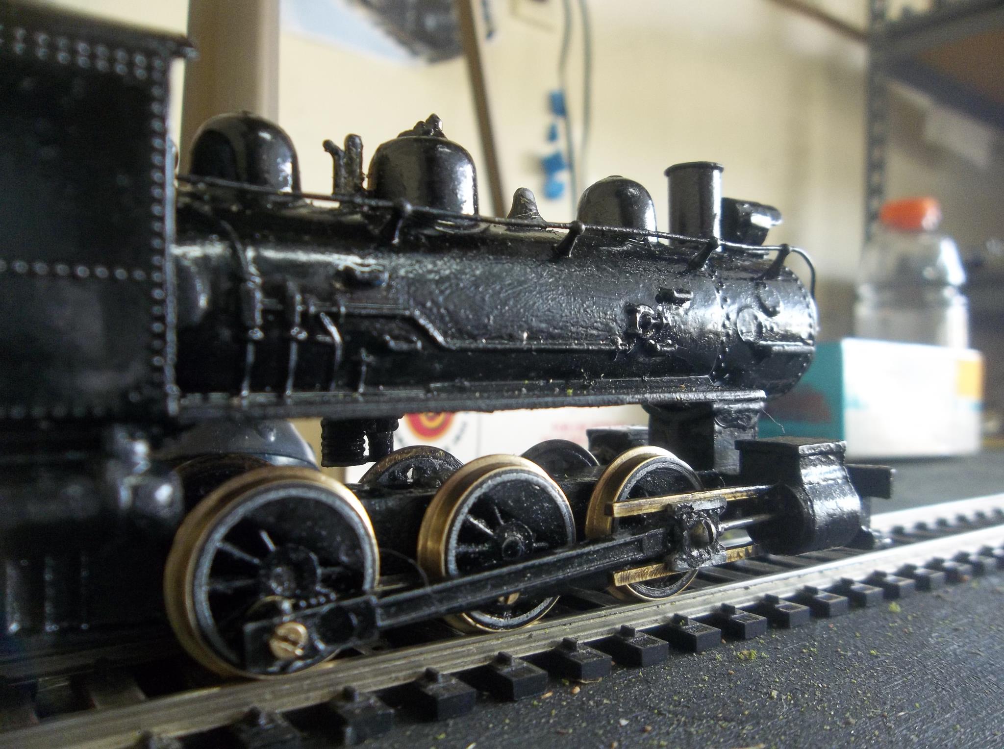

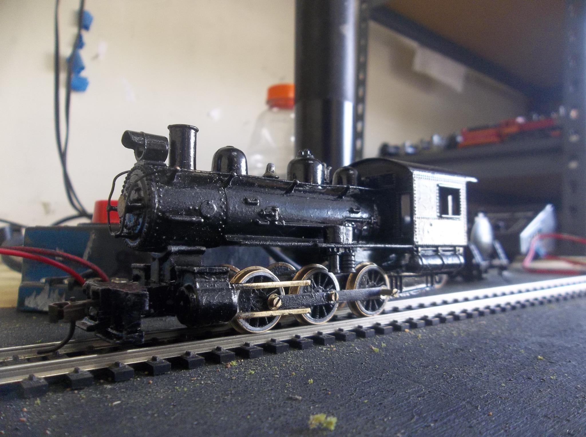

Well it's been a while since the last update but boy have i been working! Additional frame and axle work was needed and has now been completed! The drive wheels are back under the frame with the plate screwed down! Also using seperate power to test #2s motor it works great!! I'm not sure how it's supposed to make connection to power the wheels? One of you guys out there will have to help me. Anyways the side rods have been installed and so has the left side main rod! Additional valve guide work is needed on the left side! But it passed it's rolling test! See photos below! Also i installed a new knuckle coupler to the pilot beam!
here's the right side after main rod has been installed!
boiler back on to keep most of it in one piece
close up of her main rod

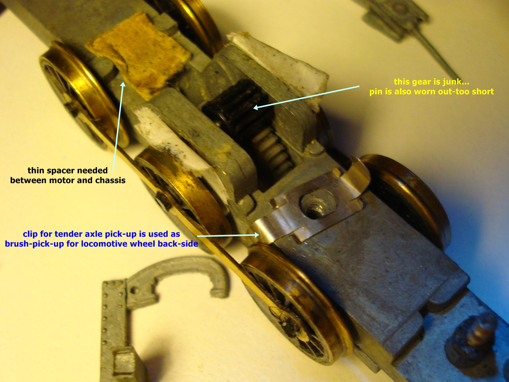

 Posted - October 08 2012 :  04:37:12 AM Link directly to this reply  Show Profile  Send zebrails a Yahoo! Message  Add zebrails to Buddylist
" ...I'm not sure how it's supposed to make connection to power the wheels? One of you guys out there will have to help me. ..."
I forget what you call the ( ) part behind the valve guides, but there's one screw that holds it into the chassis, just ahead of the motor worm-gear...{the yoke?} while my own mdc 0-6-0 loco needs new drivers, I have made a wheel-to-chassis-to-motor connection...
You may know that the motor needs direct contact to the chassis, it being the "ground" for the motor... engineer-side drivers to rail, fireman-side wheels/chassis of tender the other "red" motor contact/brushes...
Those tender-truck "clips" that allow contact from the wheels-axle to the tender chassis... looks like : --O-- with a hole in the middle for the truck to be mounted...
Well, I mounted one of those to the part (yoke ) behind the valve guide, screwed to the chassis with one set bent on and making contact with the back-side of the front axle wheel.
Hence, making the connection from rail-wheel-chassis-"black"-connection of the motor.
You said you've got good connection for the tender-chassis-wire for the left side/red polarity.
I've got a smooth-running all-metal version as yours... my plastic-cab & tender version needs new driver/quartering done.
p.s. Nice work on your restoration!
p.p.s. wanna buy this loco in-need-of-help?
The motor is near mint, Sagami, made in Japan.
p.p.p.s. Hyde, I hope you don't mind me ridding on your coat tails, that is adding and relating your need of help to my direct experience of the mdc 0-6-0's.
