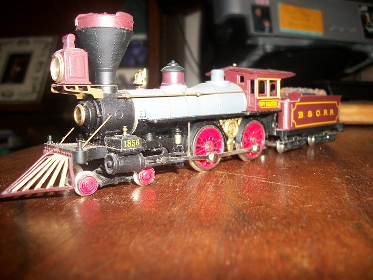

Guys,
Another pretty nice B&O model.....The Rivarossi 4-4-0, "William Mason":
I done alittle work to it, not alot tho as it looked really good almost as it was, I just could NOT stand the molded in color driver spokes and I painted them to match, polished all the real brass on it, and added a more yellowish light in the headlight, with directional lighting. It also had the original motor replaced with a decent size can motor and a more thin drive shaft that I made from brass wire (.060 thick) and then blackened.
I also added brass domes, painted as per prototype.....As you see it here, its all factory, I changed this and now it looks much better and I'll get pictures to show of whats been done to it!

I've never seen it offered in this scheme. Is it AHM vintage, or one of the IHC issues? If the cylinders and domes are brass, that dates it to early 70's or before.
That will make a great looking consist.

Yeah its a rare one for sure, its actually Rivarossi! Not IHC, I actually think its an AHM vintage from the days that Rivarossi made the loco's for them, as it has both names in the parts at different places!
It has brass domes, and cylinders, it also "had" the original Rivarossi "Coffee Grinder" motor in the tender.
And the nice thing is, its all factory painted! The only things I painted on this model was the driver faces, and the pilot wheel faces and I touched up the paint that was on the brass domes.
Other then that, it remains a factory paint job, and thank God for that one as decals for this one are impossible to find!

That William Mason is definitely a custom job. It was never offered in B&O, and they definitely never painted the domes & cylinders. They were only offered in V&T, WA, and KC&St.L.
Whoever did it did a wonderful job. That was a lucky find, John.
The Reno I bought recently has the original open frame motor too, and they were noisy. The later round motors were much better.
It's funny that during the IHC era Rivarossi was still producing their own 4-4-0's with new RP25 wheels, but using the same Mabuchi can in the tender that Mehano used. It seems that RR and Mehano still had a close relationship and shared molds and parts (the E8 is another example) long after RR's relationship with Bernie Paul soured. He brought a baseless lawsuit against them and Con-Cor and burned that bridge.

Good call! I had to go look at that loco again and its NOT decaled at all! Its screen printed, that 1968 sheet you posted isn't the same year! This locomotive had a silver (unpainted, unblackened) motor, I wonder if this wasn't something done from the company of AHM just at the time it was going to become IHC, with rivarossi locomotive for the time that this locomotive was headed to the movie set? I say this as its about the same era when it was to be in the movie that Disney World put on (For the life of me, I can't remember the name of the movie but was like 25 or 30 years ago!)
I can tell you, it surprised me that its actually screen print lettered. As when you mentioned that, I had to look to see if it was decaled or not! (You can tell the difference from decals to screen printing in the finish under light at the right angle.)
I don't have the box to it but, I wonder on it now!

You know.......Something just dawned on me! This locomotive as you see it in the pictures, I could NOT stand the fact that the drivers, did not match the rest of the paint, the maroon color, SO I took some I think it was Tuscon red paint I had from Floquil and its a DEAD match on color......I don't think I could get that lucky again!
Anyway, it looks MUCH better that way and I'll have to get pictures of this! I also touched up the paint on the brass domes as well......EVEN tho, they were NOT brass colored in real life, I still think the tops of the domes would have looked AWESOME polished brass to go with the rest of the brass trim!
Another thing that got me was the brass trimmed boiler straps, and the ornate thing between the drivers.......These sections/parts are plated plastic to look like brass!
What have I gotten my hands on this time!?

John, I noticed that too: they never painted the boiler straps on these. The Early J. Bowkers had separately applied boiler straps plated in gold chrome, but not the 4-4-0's. There are firms that will do custom work like this, in fact one of the IHC guys I know has sent out a bunch of the old AHM C-424's for custom painting in LV burgundy with yellow lettering, and they look much better than Roco's paint jobs. It's possible that someone paid to have it professionally done.
That's a Genoa, as it turns out. The Reno had a round headlamp and straight stack; the Genoa has the spark arrestor and square headlamp. You said you added a yellower light to it... does this mean there was a bulb in there already? Only early versions of the Reno were illuminated, but the Genoa and Inyo with the square headlamps weren't, so if it was illuminated it's custom.

I'm not sure but I can tell ya the boiler straps are gold plated! This I found a nice touch....
As for the headlight, yes it was lighted, HOWEVER, that wasn't factory....Someone had added a bright white Minitronics tiny 12 volt bulb in there....I took it out and will use it on adiesel, as its small enough to replace atleast one lens in a diesel! This is when I added the more yellowish bulb to look like fire as these were oil lamps!

Hi John how is this a little fixeruper ! Hey you need a dome.

Yeah Frank, when these pictures were taken is when I first got the Wm. Mason.....It now has the missing dome, and the drivers have been repainted to match the maroon paint.....
Not to mention for its size, it runs pretty well!
