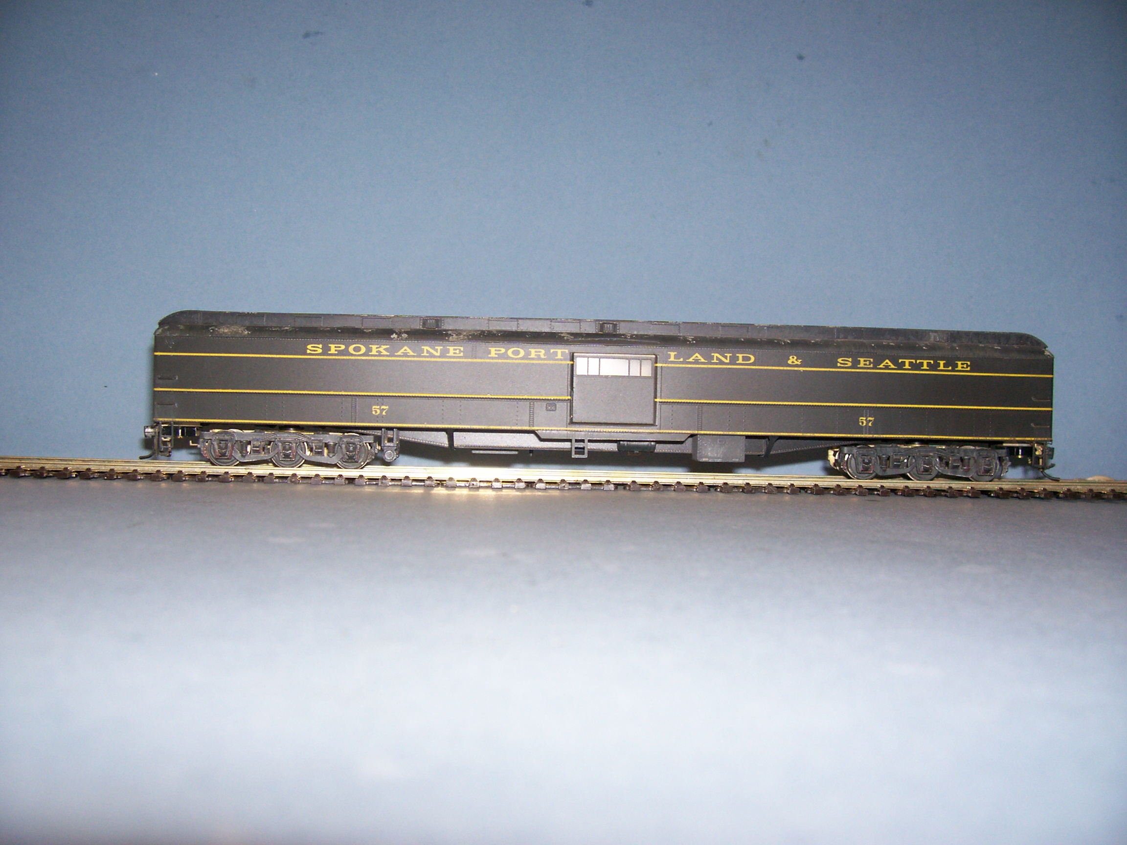

 Posted - July 03 2012 :  1:37:04 PM Link directly to this topic  Show Profile  Send catfordken a Yahoo! Message  Add catfordken to Buddylist
need to know if its prototypical car ie one door and its correct name,ken

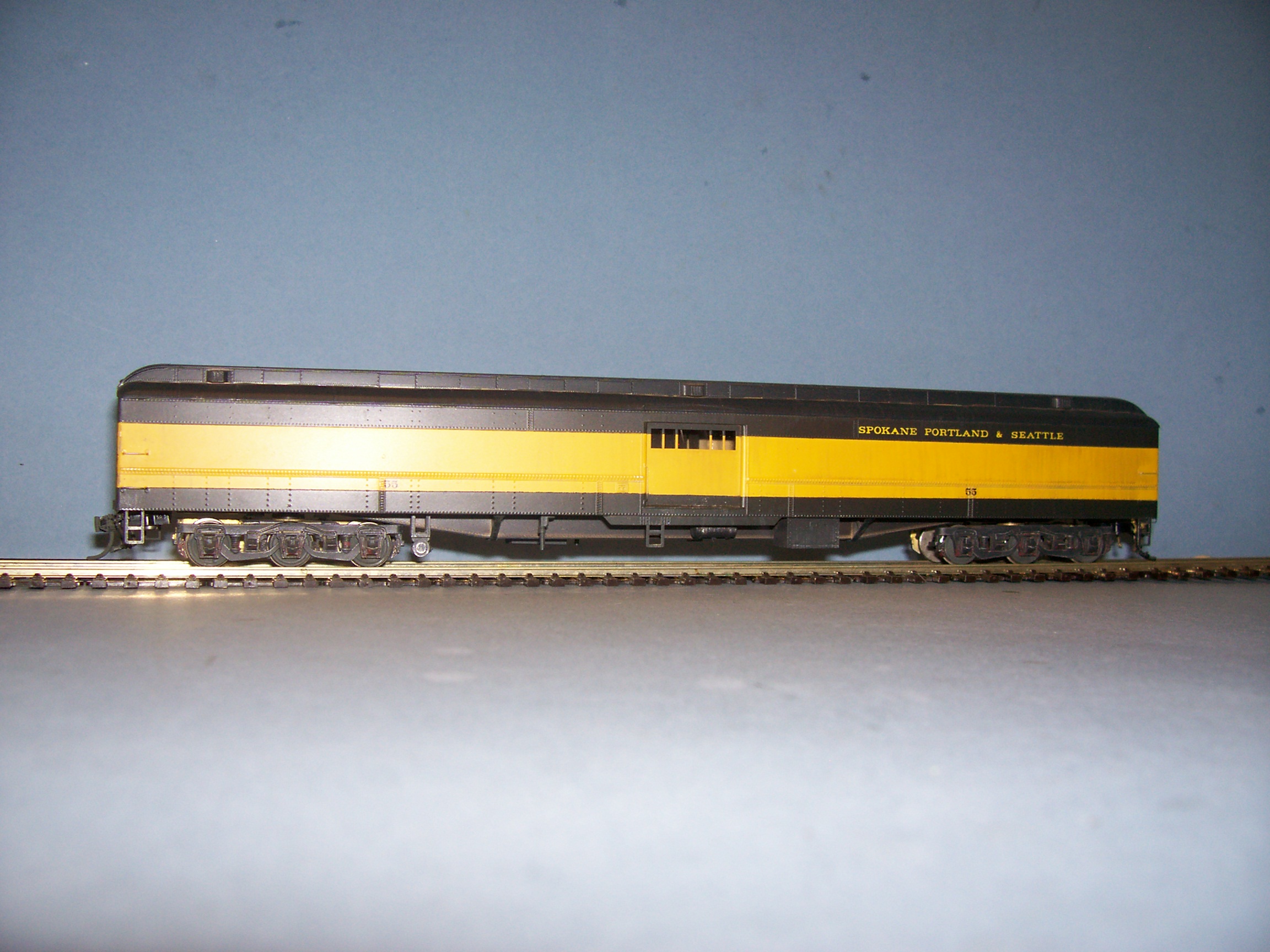

terrific thomas,got these pair of cascade models coming in a lot of frisco and southern items,boxed and 2 different versions heres the other,ken
weird combo,half brass half diecast

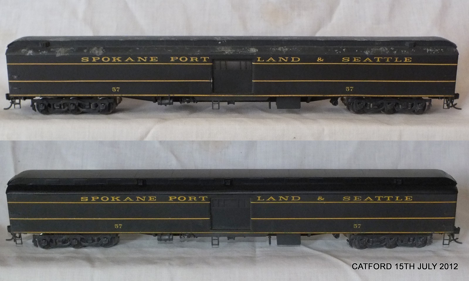

 Posted - July 13 2012 :  07:08:51 AM Link directly to this reply  Show Profile  Send catfordken a Yahoo! Message  Add catfordken to Buddylist
items arrived today,well pleased,from what i gleaned from internet,to have both versions together is rare,even though ones roof needs a repaint,came with info sheet to boot ken
/tyco/forum/uploaded/catfordken/20120713070449_013.JPG
the ends are different as per info sheet

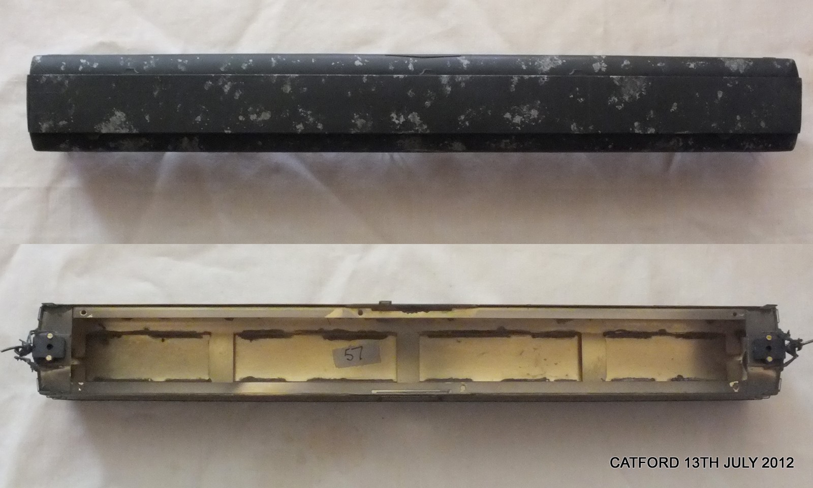

 Posted - July 13 2012 :  07:59:58 AM Link directly to this reply  Show Profile  Send catfordken a Yahoo! Message  Add catfordken to Buddylist
looking at the roof on the car above,i thought it was diecast,but its not,its brass,so wondering what the grey patches are ken

 Posted - July 13 2012 :  11:27:09 AM Link directly to this reply  Show Profile  Add shaygetz to Buddylist
Originally posted by catfordken - July 13 2012 :  07:59:58 AM
Looks like dezinc, Ken. Just as zinc pest stops the hearts of us train collectors, dezinc stops the heart of model steam folks. It's the zinc in the brass that's trying to get out...not an issue on our models, but in a boiler it eventually leads to pinhole leaks
 Posted - July 13 2012 :  11:39:29 AM Link directly to this reply  Show Profile  Send catfordken a Yahoo! Message  Add catfordken to Buddylist
ho bob anything to stop or cure it ken
 Posted - July 13 2012 :  11:53:08 AM Link directly to this reply  Show Profile  Add shaygetz to Buddylist
A good sand and paint should fix her right up...
Oh...and...be glad it's not a Mamod SE1...
 Posted - July 13 2012 :  11:55:13 AM Link directly to this reply  Show Profile  Send catfordken a Yahoo! Message  Add catfordken to Buddylist
I can imagine bob,thanks ken
given a dust over of paint after a rub down,will leave 24 hrs then tone down with dull coat
