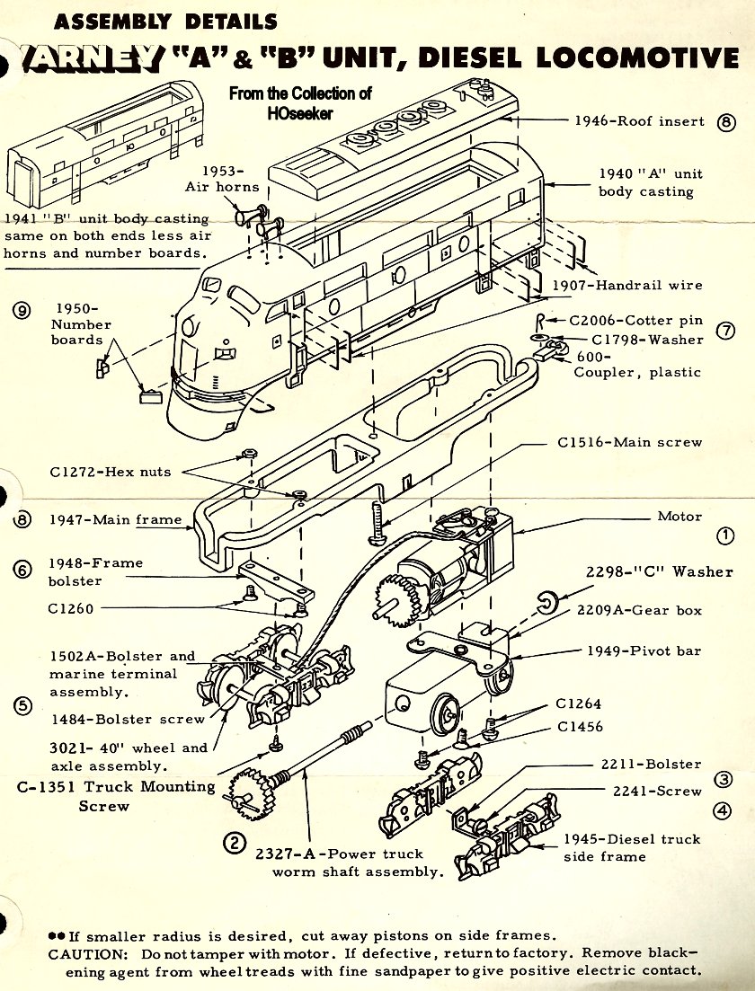

I got this engine for a buck or two at the last train show. I knew it was a fixer-upper, but so far I haven't had much luck with it. Anyone know what drive is in this engine. The magnets are strong, and the motor turns fine (thanks to a LOT of Labelle 107), but she still goes really slow and the winding gets scalding hot within seconds under load. Though I think the winding insulation may be shot, I want to get an ID on this engine before I go any further, Any ideas as to make and year?

It is a varney or life like drive. If gilbert it would say so.

http://www.hoseeker.net/assemblyexplosionvarney/varneyfab3pg1.jpg

Thanks again everyone. She defintely matches that diagram. Sadly, I think she's going to become the "dummy unit of the week". I've cleaned her to death, and yet her winding heats up very quickly, so I think the insulation on the armature wires is shot, leaving her with a shorting motor. Oh well,

The frame and drive are from a Varney F3 circa 1950s. The Santa Fe F7 shell did not originally come with it.

I figured it was a different shell, since it didn't quite fit on the chassis. I finally gave in and converted the unit to a lighted dummy. I narrowed the problem down to the winding, which I believe was burnt and was shorting out, causing the huge spike in temperature. I'm keeping her and the drive parts around, however, in case I find another Varney diesel with a good motor but which is missing a few pieces.
