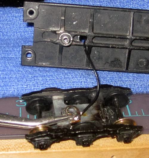

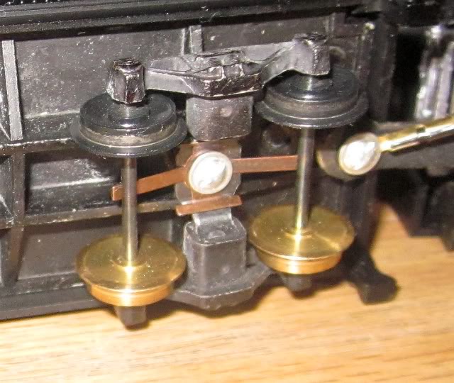

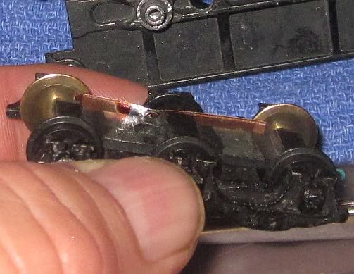

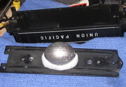

 Posted - June 26 2012 :  6:42:02 PM Link directly to this reply  Show Profile  Add shaygetz to Buddylist
The first set of wipers were for my 2-6-2 Prairie, the second set for my 4-6-2 Pacific. In all cases, I add weight to the tender using a 3 oz egg sinker mounted with epoxy putty...
The extra holes in the floor of this Pacific's tender are for the wires that go to the new wipers...
Edited by - shaygetz on June 26 2012 6:43:47 PM
