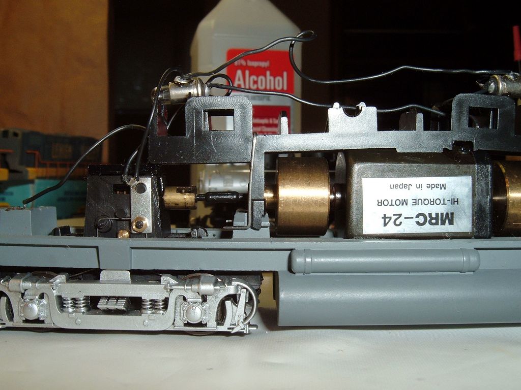

siouxlake
 Posted - June 16 2012 :  11:10:11 AM Link directly to this reply  Show Profile  Add siouxlake to Buddylist
Here is what I am referring to w/respect to the motor clips:
I added a bit of heat shrink tube to the arc of the paper clip as a friction grip for the motor.
Siouxlake/ Ron
 Posted - June 16 2012 :  7:29:00 PM Link directly to this reply  Show Profile  Add NickelPlate759 to Buddylist
That's a good fix, Ron. I've done the same thing with paper clips, or brass and steel wire.
I recently did this to repair my MRC/Lima C-420. The 4 legs of the motor retainer end in an upside down T, and 2 on one end snapped when I tried prying them loose. Bending a square U out of steel piano wire was the perfect fix, and actually makes it easier to disassemble.

 Posted - July 10 2012 :  9:06:05 PM Link directly to this reply  Show Profile  Click to see EM-1's MSN Messenger address  Send EM-1 a Yahoo! Message  Add EM-1 to Buddylist
Siouxlake/ Ron
Originally posted by siouxlake - June 16 2012 :  11:10:11 AM
Ron, you looking for a new part? I have plenty of them laying in the parts bins!
