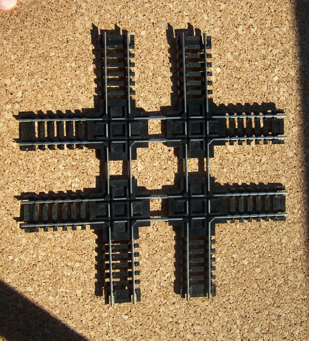

I have decided to go ahead with my L shaped deck railway, and this is the piece that I had to decide on, whether to make an over/under crossing and have a sharp grade, or spend the money and make a flat crossover. Not like I'm going to be running long coal drags or anything on this proposed outdoor HO railroad, so having the train short enough so it doesn't run into itself is no problem.
That's almost $50 worth of crossings I bought to make this piece, I. used a Dremel to cut off two adjacent sides on each 90 degree Xover, and there's 2.5 inches between centers. Turned out pretty nice, I did it in about 30 minutes time. Hope to get the railroad up and running this year sometime. Will probably have no scenery, but it will have 3 islands, and all flat terrain, thanks to this quad crossover I made. I'll bet no one else is likely to have used this in their layout scheme.

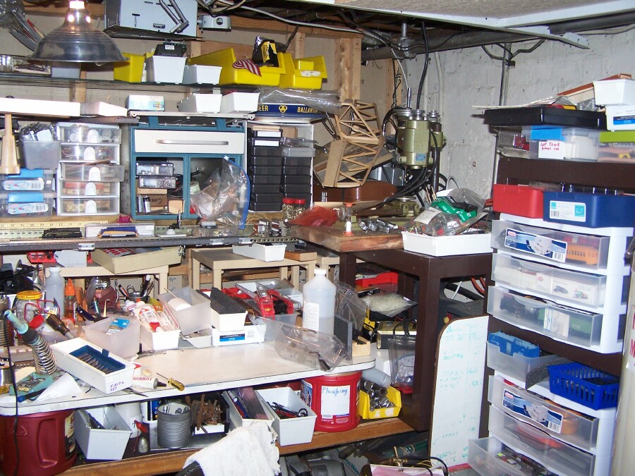

While I was at it , I cleaned off my workbench again, and got it presentable enough to work on. I have GOT to try to keep it clean, I bought two Sterlite 3-drawer units to get all the HO engines off my bench and into something to keep them dust-free and ready to work on.
Rather cosy area in my basement corner, but useable. IF I can keep it cleaned up and not junked up.

NICE shot of the work area!
As for the quad crossing, yes, I have made 2 of them in the past, not for my own layout, but for others.....

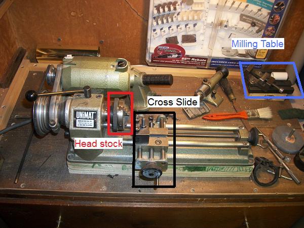

Question tho...... you have a unimat......what do you have on the cross slide table? OR is that the tool rest for the lathe (sorry difficult to tell from the picture) but it looks like you have the wood lathe headstock plate on the cross slide, is that right?

Question tho...... .what do you have on the cross slide table? OR is that the tool rest for the lathe (sorry difficult to tell from the picture) but it looks like you have the wood lathe headstock plate on the cross slide, is that right?
Originally posted by EM-1 - June 09 2012 :  10:12:45 PM
Basically it's configured right now for a mini drill press. Unfortunately it sat down at my Aunt's farm for years, and all the specialty bits and chucks were seperated from this Unimat. I managed to retrieve it when my Aunt could no longer live at her home, but never did find all the other bits and pieces that went with it So far, I haven't used it much, but it is available again when I need it's services. I'd have to look at it to see how to reconfigure to a lathe, your "headstock" and "cross slide" comments aren't making sense to me, as I haven't worked much with convertible machines like this. The motor is rotated vertically to use currently as a drill press, I assume it can be mounted horizontally again for the lathe option. I've just had no use for a mini-lathe, it was more useful to me the few times I used it as a drill press.

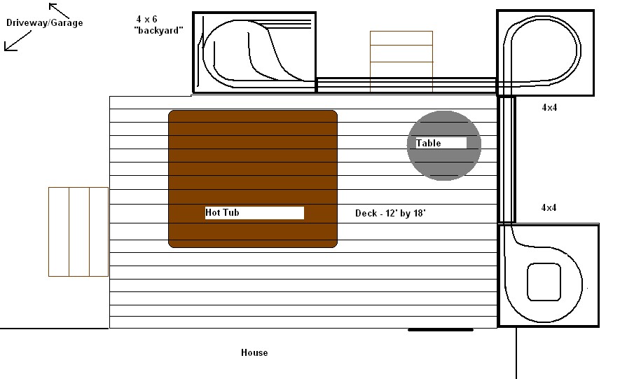

Here's my proposed outdoor HO modular layout, will be mounted on the outside of the deck railing, so to be viewable while sitting down at the table. So far the only two pieces I have are the two C-channels to mount the track on to run between the 3 main modular sections I will have to build. Once I get the support framework figured out, I can move on with this project.
Like most of my projects, I will dream about it, and dawdle doing anything on it, and maybe I'll get something accomplished this year. I hope to, anyway.

I took an existing picture I had of my Unimat, and edited it to show different parts in the picture.... if you look behind the motor, you can see the headstock column, this is what makes your Unimat in the "Drill Press" state, as you'll see in my picture its in the "Metal Lathe" state......I want ot get pictures of mine added so that it can be seen in different set ups!
See:
Let me know if this helps you to understand a Unimat....and what I was talking about on yours!

Looks like a neat plan Jerry :) If you're using nickel silver track, rain won't hurt the rails will it?
 Posted - June 11 2012 :  11:26:07 PM Link directly to this reply  Show Profile  Send AMC_Gremlin_GT an AOL message  Send AMC_Gremlin_GT a Yahoo! Message  Add AMC_Gremlin_GT to Buddylist
Originally posted by DaCheez - June 11 2012 :  10:22:04 PM
I'd say probably not. I don't intend to leave it out in the rain. But it probably won't hurt it much if I wipe it down quickly.
 Posted - June 12 2012 :  06:00:27 AM Link directly to this reply  Show Profile  Click to see EM-1's MSN Messenger address  Send EM-1 a Yahoo! Message  Add EM-1 to Buddylist
Jerry,
I actually just now seen your diagram of the out door layout your planning! VERY interestin g idea!
I will say, I have done some crazy outdoors trains mostly in G scale (I have alittle G scale myself) But I have had a few customers have me lay track and out of the 3 of them, 2 used a mix of brass and nickle silver the other used all stainless steel track......
I must say the nickle and stainless steel stuff worked the best! HOWEVER, the G scale stainless steel stuff was the best ot owrk with as this customer had me lay a railroad crossing through his driveway!
Anyway back to HO, as long as you use ALL nickel silver track, you shouldn't run into any problems! HOWEVER, BE sure that (depending on your location) winter weather isn't an issue as the snow and ice can and will wreak havoc on your rails! Other then that, which is a simple remedy if its a semi-permant plan you have, cover it all use with a heavy, "supported" tarp and you'll be good to go! (cold won't hurt it) but ice and snow will.....which you want to keep off the track as much as possible.....

 Posted - June 12 2012 :  10:59:07 PM Link directly to this reply  Show Profile  Send AMC_Gremlin_GT an AOL message  Send AMC_Gremlin_GT a Yahoo! Message  Add AMC_Gremlin_GT to Buddylist
Jerry,
Originally posted by EM-1 - June 12 2012 :  06:00:27 AM
Well, I intend it to be modular and I can put it in the garage or basement when not in use. I definitely don't intend to leave it out in the weather much. I may make a sun cover for it to leave it out in non-rainy weather, and pull it down if weather is going to get bad. The trick is to make it easy to tear down and put up, like an indoor modular railroad. So we'll see how that progresses this year.
