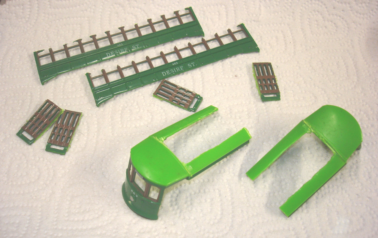

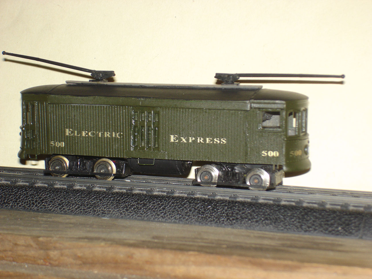

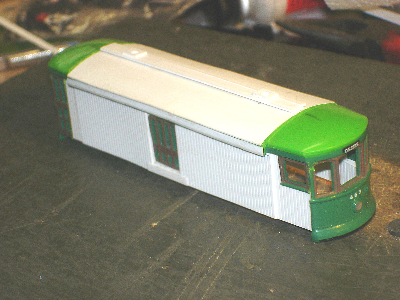

Some of you may remember the ugly green trolley--Streetcar Named Desire--that I tried to give away. I can't stand throwing stuff out so decided to try my hand at HO kitbashing, quite a stretch for me because my regular hobby is O-scale.
So, I decided to do what the traction companies often did with wood cars--convert it into an express car.
First, the slice and dice. Most of the express cars I looked at were in the 30-36 feet range, whereas the green trolley was a scale 40 feet, so I had to take some out of the middle. I also got rid of the deck roof, because most pictures I saw had the regular flat rounded roof. Cut the sides off, but saved the doors.

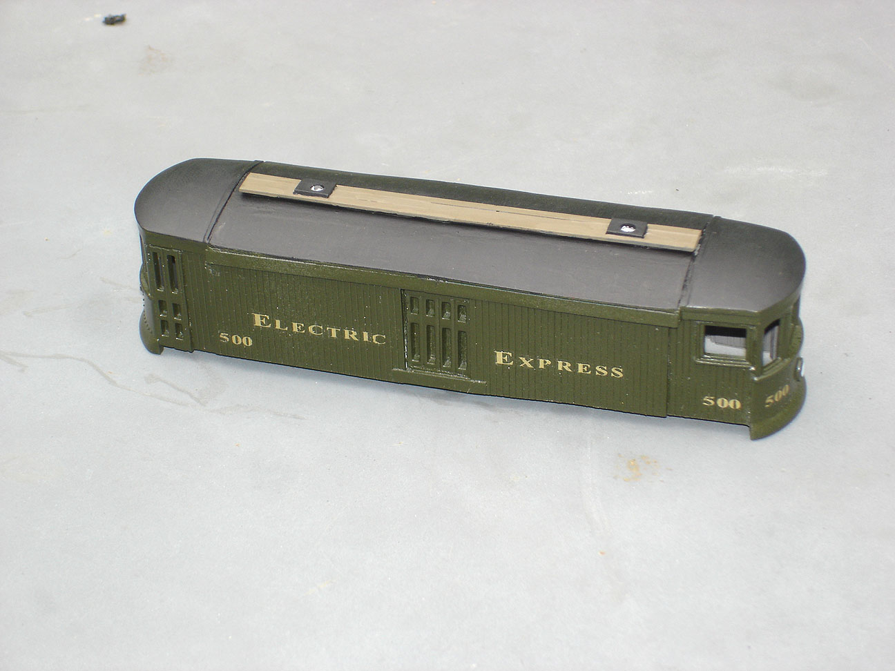

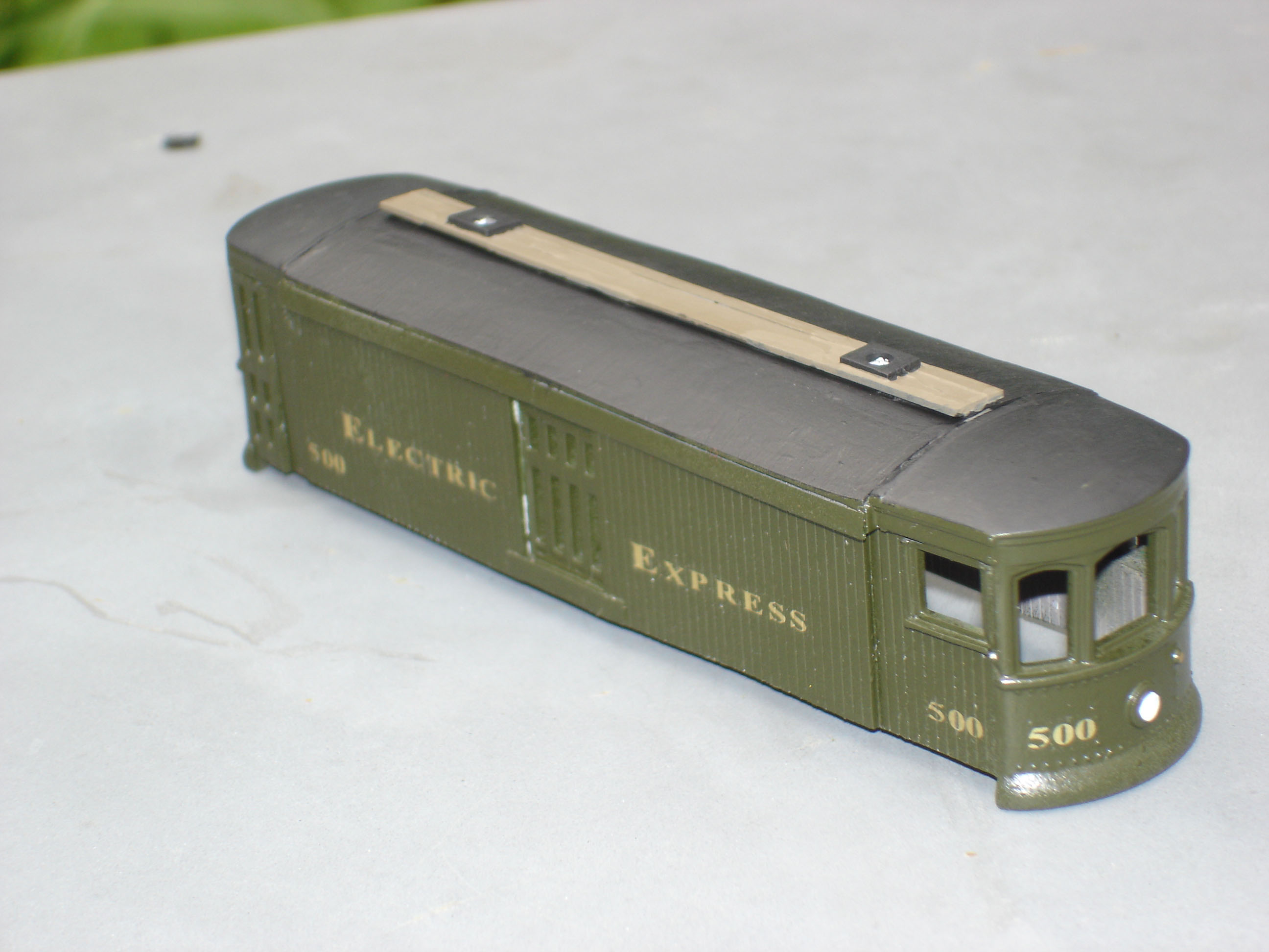

Then, I glued on sides made of scribed styrene, used two doors as baggage doors and the other two as single side doors, and made a side window from the windows in the sides. I patched in the roof with .010 styrene and added a new roofwalk.
I chose the Electric Express Company as my prototype because they had a lot of express cars of many different types, though I did not follow a specific car. This was an interesting operation in southeastern, central and western Massachusetts, wherever the New Haven Railroad controlled the streetcar lines. The company was a great service to farmers in small towns that had streetcar service but no steam railroad connections. In 1907, the company shipped 10,000 barrels of apples, as well as tons of milk and oddball stuff such as greenhouse ferns. This car is numbered for the Boston-Worcester area, but could appear elsewhere in Massachusetts because these were pooled cars.
It's a little rough, but I'm not unhappy with it as a first HO effort. Now I have to figure out how to motorize it. I have some trolley power trucks but will need to fabricate a chassis for them. Maybe if that comes out I will splurge on some real headlights.

 Posted - June 06 2012 :  10:20:07 AM Link directly to this reply  Show Profile  Send catfordken a Yahoo! Message  Add catfordken to Buddylist
hi bruce,amazing what a bit of imagination and sum skill can do to a give away,nice piece ken

 Posted - June 06 2012 :  11:30:35 PM Link directly to this reply  Show Profile  Add NickelPlate759 to Buddylist
Awesome transformation, Bruce! The scribed styrene really changes its whole character. I guess you can make a silk purse from a sow's ear.

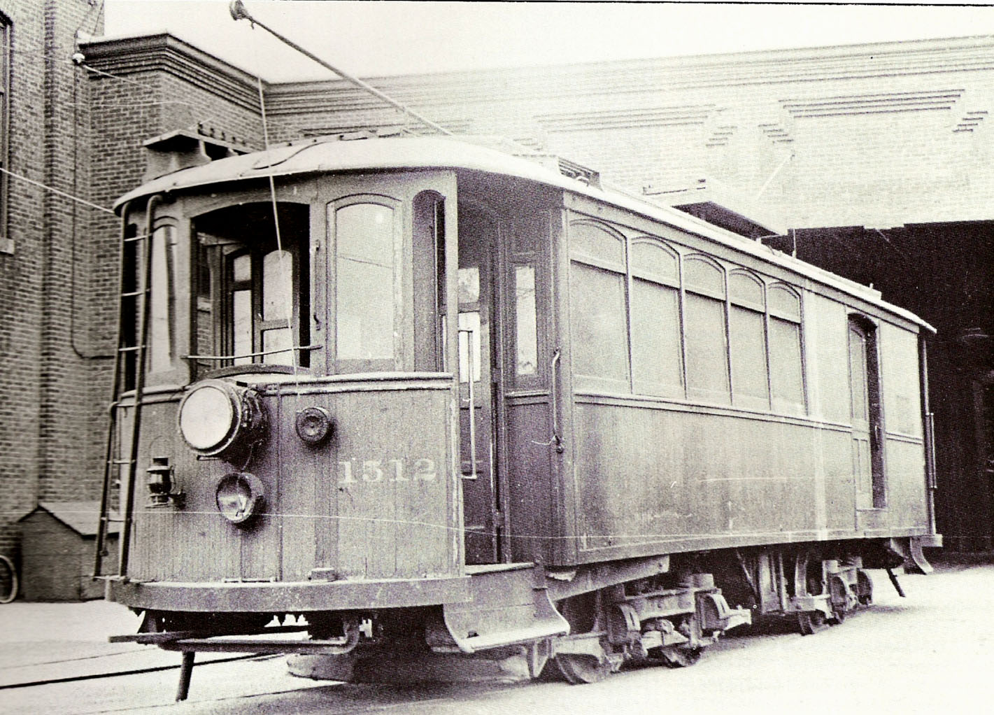

Here's a picture of a funeral car:
This was named "Oregon" (don't ask me why) and ran on the Danielson, Conn. to Providence, R.I. line. This photo, from 1938, shows it after it was converted into a work car, so subtract the extra headlight, ladder, and roof platforms to get an idea of how it looked. This is from an excellent series on New England trolley freight by C.A. Brown in SHORELINER, 1987-1988 (the magazine of the New Haven Railroad Historical and Technical Society).
This would convert nicely from the Ugly Green Trolley, since the five side windows are the same arched type. The arched loading doors might be a bit of a challenge, as would motorizing, of course.

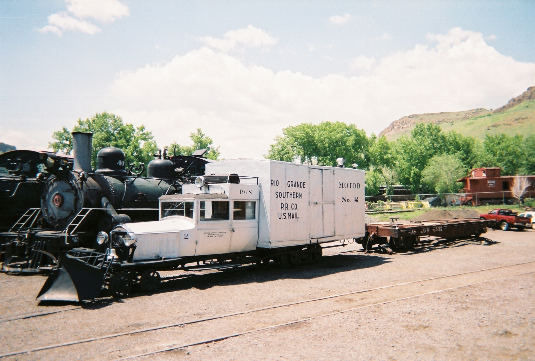

its Geese, NKP & now the real one
ALL Geese will be at the Colorado RR Museum next weekend!

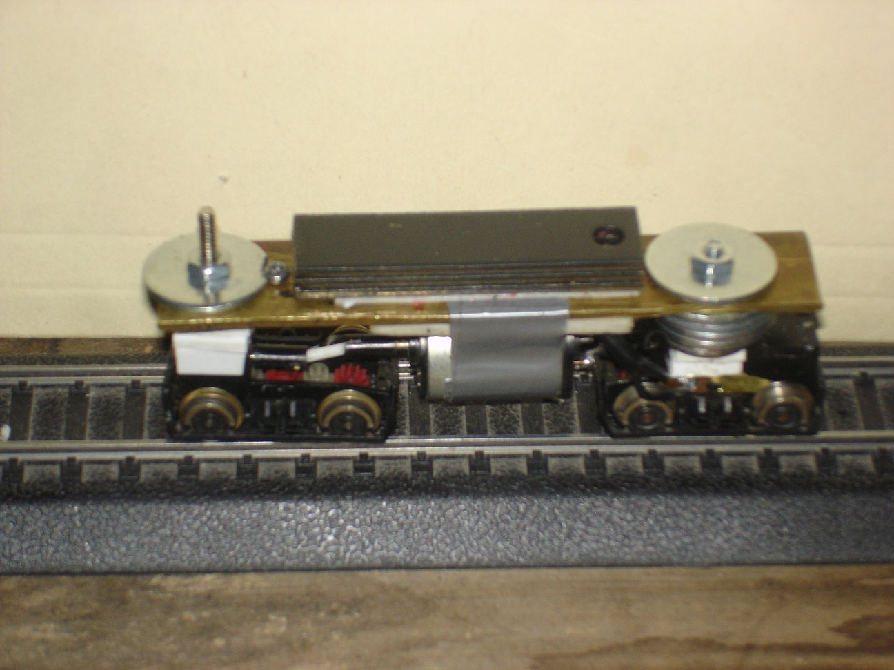

After looking into after-market powered chassis for my green trolley/express car, I thought I'd give the geared trucks I had a second chance and save the $$. These trucks, which my friend had before he died, look to be German. They all had traction tires, so I took them off the truck to which I attached brass wipers. Then I glued on some machine screws set into styrene blocks, added a piece of brass, and just kept adding washers. Miraculously, it runs pretty well.
Those of you with machinist skills will be appalled, but I had to work with what I know, which is duct tape, styrene, and superglue.
I attached the body by padding it with foam. A lot of work, but something unique, I think.

Too cool...oughta be a pullin' beastie. You got the truck spacing spot on too...
 Posted - June 18 2012 :  11:22:22 PM Link directly to this reply  Show Profile  Add NickelPlate759 to Buddylist
Well, as the Mythbusters have proven, you can do just about anything with duct tape.
That trolley is supersexyawesome, Bruce. What is the motor from, and does it power both trucks?
Edited by - NickelPlate759 on June 18 2012 11:31:57 PM
bruceclouette
 Posted - June 19 2012 :  08:02:10 AM Link directly to this reply  Show Profile  Add bruceclouette to Buddylist
The motor was in the bag with the trucks. There are couplings on the truck worm gear and on the motor connected by a spline. But because the wheels all had traction tires, I couldn't see how to pick up the current unless I removed the tires from one truck.
It runs OK with just one truck powered, a little better forward than reverse. I guess it's typical, but this thing probably goes 100mph scale if you put the transformer on full. Can't make it creep, but it does run a normal trolley speed on low.
I think my friend had purchased these power trucks with the idea of powering an unpowered unit, maybe even the Ugly Green. I still have one geared truck (why he had three beats me) if anyone wants it to experiment with. No motor, though.

I myself would have bent some brass stock and made a mount type item to hold the motor but thats just me!
Otherwise you did good, and it looks GREAT! I bet with the washers, it added some weight to hold it to the track at 100 scale MPH!
