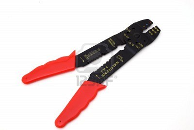

To get the original gear off the motor, a puller won't do it, because Rivarossi worms are an extremely tight fit. I use an old pair of wire strippers like these:
Trap the shaft in the smallest wire gauge hole that allows it to move freely, rubber band or tie wrap the handles shut, and prop it over the jaws of an open vise. Some really good raps with a hammer on a small enough punch should start to push it out of the worm (heating the worm may help if it's really stuck). Once you've got it started, a puller should be able to do the rest.

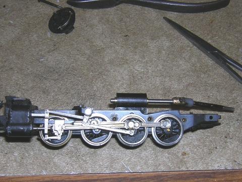

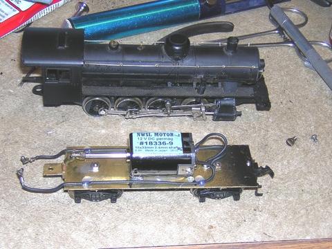

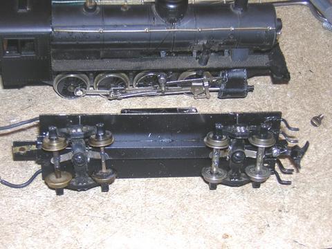

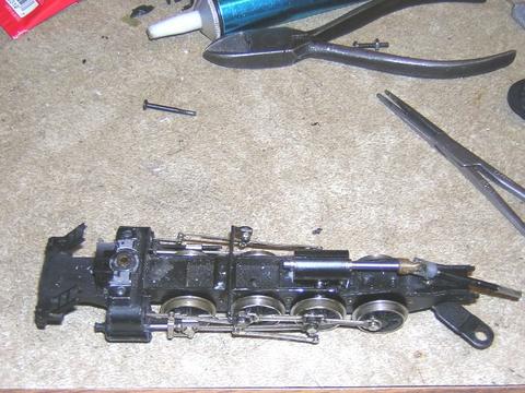

I remotored my original Riv 2-8-0 I bought new in '65 or '66. Maybe as late as early '67.
Tender mounted motor, frame exploded while in storage for 40 years, which held the bottom part of the gear reduction
In have the Menzies Machine Shop driveshaft and u-joints in it when stored.
NWSL, and Sagami on a new brass tender floor. I can post photos if you like.
I did the series on the Yahoo remotor and repower group a couple three years ago.
Runs FAR better than it ever did.
Dave
This is the chassis with the NWSL installed.
Top view.
New tender floor, of brass.
Motor installed on new tender floor.
Dave
