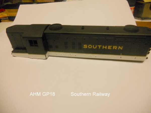

One of many projects I've started.

i can't tell, is it green or black? what are you doing just a repaint in the southern tux? i love 'em.

Black. Tuxedo scheme. I need to add the paper element filter to the roof. Already painted the frame. And when I get around to it, add some aftermarket handrails. Got a micro mark
HM-5 motor for it. It's practically a drop in replacement.

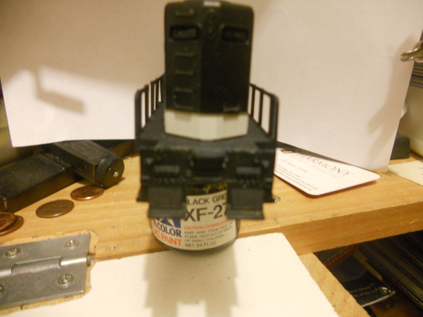

Did a little more with a GP18. The pilots on these are disgustingly too small. So I added scale size pilots.
Ray Marinaccio
RayAvatar
 Posted - July 28 2012 :  10:59:17 AM Link directly to this reply  Show Profile  Add Ray Marinaccio to Buddylist
Nice work.
Swapping the pilots is a great idea.
I have filled in and detailed the original pilots on a few of those. Swapping the pilot like you have done looks alot easier.

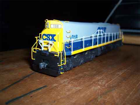

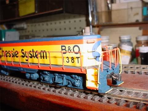

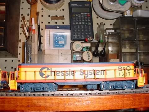

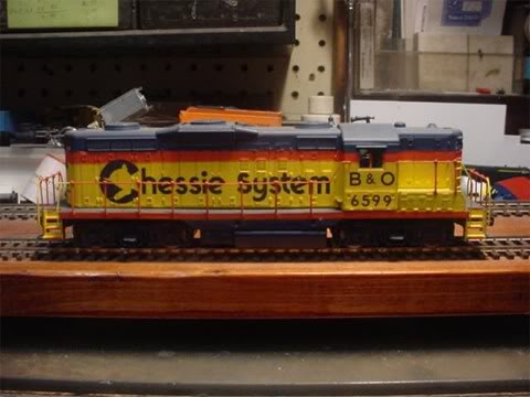

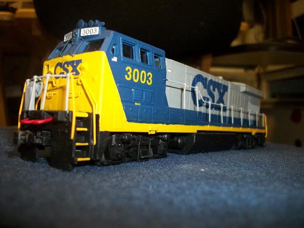

NICE work! I picked up this posting from one you added the link to it in. I got a few GP-18 projects done in much the same means you did!
Here is one of my renditions:
THEN, to really modify these loco's I made this:
ALL from a single AHM GP18!

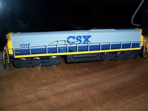

Then I have to say, want bigger stuff? The ALCO 3 axle unit, I believe its the C-630, makes a wonderful base to an MT-6 slug!
ALOT can be done with those older units, and as you know and can see, look really good at the same time!
And before I go and leave it at this, YES every slug I have built, is powered!

What did you use for a motor in the Chessie slug?
Not the original AHM motor??
The MT-6 slug is an interesting looking creature.
 Posted - June 27 2013 :  01:50:17 AM Link directly to this reply  Show Profile  Click to see EM-1's MSN Messenger address  Send EM-1 a Yahoo! Message  Add EM-1 to Buddylist
Paul,
YEP! The factory motors were used in ALL the slugs I've built. I lower the motor into the fuel tank further in any case or way I can when needed but believe it or not, you know how that fuel tank has that interior frame work that the clip snaps into? REMOVE it. Then glue the fuel tank in its place, SOLID! Mount the motor to the inside of the fuel tank with Silicone, OR a type of removable glue of your choice, hold it upright and true 90 degrees to the top shell. Add your wires from the trucks and off to the yard tracks he's ready for assignments!
The MT-6, that's a BEAST! It took a bit of work to get an IHC ALCO C-628 it was, (I think I said C-630 above) to become what you see as my MT-6....That slug, even has custom turned flywheels in it!

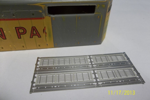

Started my second GP18 project many months ago but, I got some neat details parts recently.
These are some stainless steel photoetch radiator grilles. They are made by Plano. Fantastic looking detail. They even have the tiny condensation drain holes and rivets. Plano has a bunch of photoetch detail parts.
