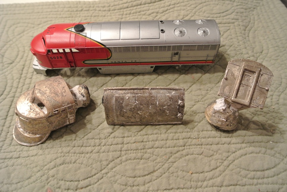

Here is my latest project, turning an old AHM C-Liner into a work of sculptural art. I am casting it as a trinket box in bronze/copper alloy using the lost plastic casting investment process.
 Country: USA  ~  Posts: 867  ~  Member Since: December 21 2013  ~  Last Visit: December 08 2016 Alert Moderator
metalsmith1
REAAvatar

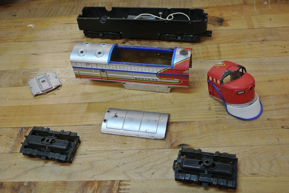

 Posted - February 14 2014 :  02:26:05 AM Link directly to this reply  Show Profile  Add metalsmith1 to Buddylist
These things always had awkward pilots so I put my own spin on the design.

 Posted - February 14 2014 :  02:28:32 AM Link directly to this reply  Show Profile  Add metalsmith1 to Buddylist

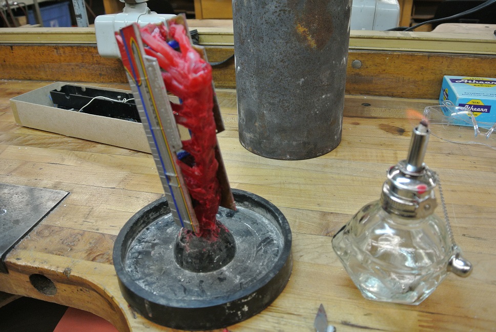

Here is the body all sprued up with wax.

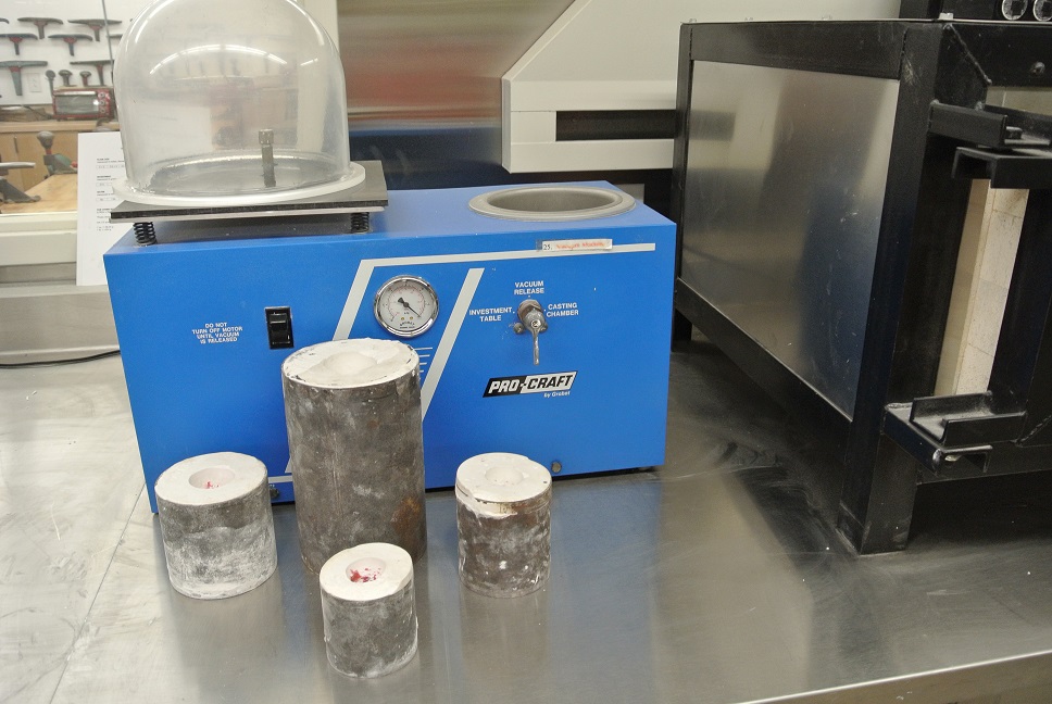

These are the casting flasks all filled with investment plaster and the vacuum mold machine. They are ready to be fired in the furnace to the right.

 Posted - February 14 2014 :  02:38:56 AM Link directly to this reply  Show Profile  Add metalsmith1 to Buddylist
Keep in mind this is an art piece and not a scale model so forgive me for my un-prototypical changes to the styling of the carbody. The roof hatch is going to be hinged with a release button located in the round roof vent behind the cab.

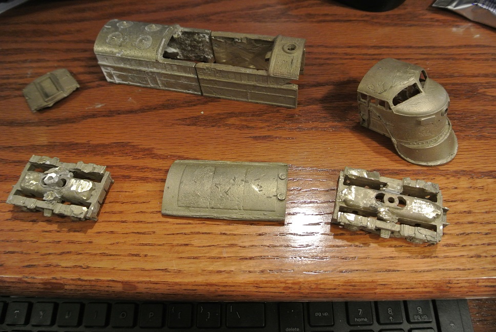

 Posted - February 20 2014 :  02:55:01 AM Link directly to this reply  Show Profile  Add metalsmith1 to Buddylist

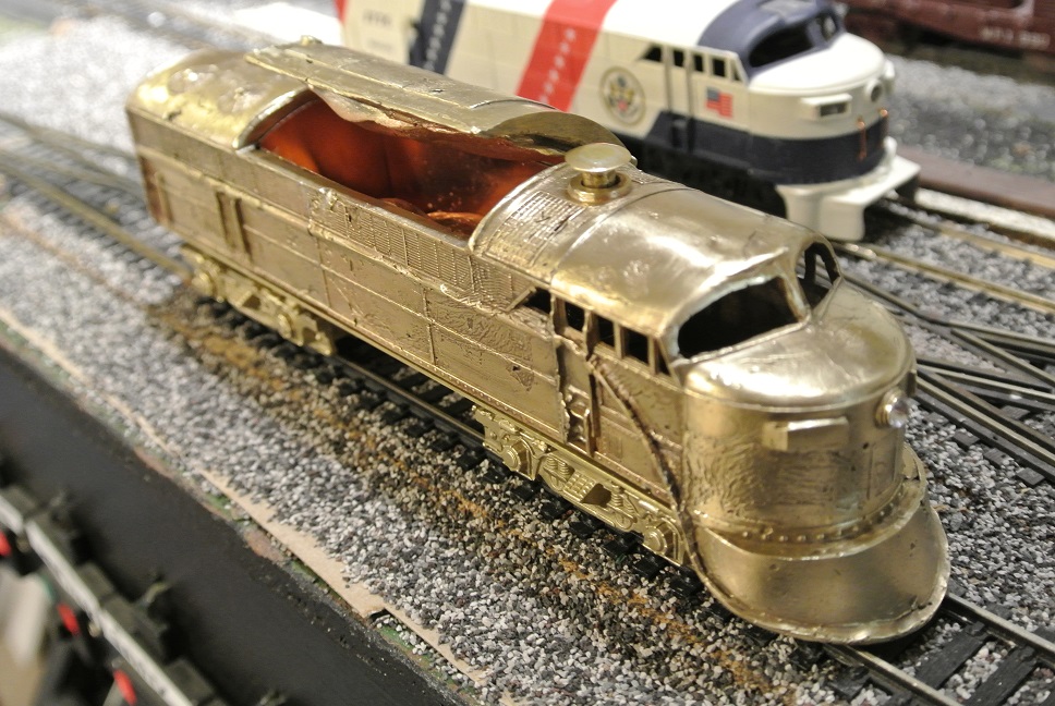

Here is the latest progress after having cast all the parts in bronze. The next step is to get everything soldered together, stay tuned!

 Posted - February 20 2014 :  6:17:10 PM Link directly to this reply  Show Profile  Add NickelPlate759 to Buddylist
I'm amazed at the truck castings. they look like perfect replicas. Did you need a 2 sided mold for them?
metalsmith1
REAAvatar
 Posted - February 20 2014 :  7:26:46 PM Link directly to this reply  Show Profile  Add metalsmith1 to Buddylist
The final finish will be an aged patina similar to a pair of bronze baby shoes. The truck castings are perfect replicas of the originals because the original plastic trucks were used in the molds. In this process, wax sprues are attached to the originals and then (invested) in a special investment plaster. These are contained in flasks witch are then heated in steps from 300degrees to cure the plaster and then 900degrees to burn out the plastic. While the flasks are still at 900, the metal is heated in a crucible and then poured in to the cavity left behind by the burned out sprues. We use a vacu-form machine that sucks air form below the mold to pull the metal in to the mold for better detail. After 5 minutes, the still hot mold flask and casting are submerged in cold water and the investment plaster basically explodes out of the flask ( that's the fun part)! You then have a finished casting that must be de-sprued and cleaned up.
 Posted - February 20 2014 :  11:56:44 PM Link directly to this reply  Show Profile  Add NickelPlate759 to Buddylist
Cool... a sacrificial master, and a sacrificial mold. I thought it might be a one-off casting.

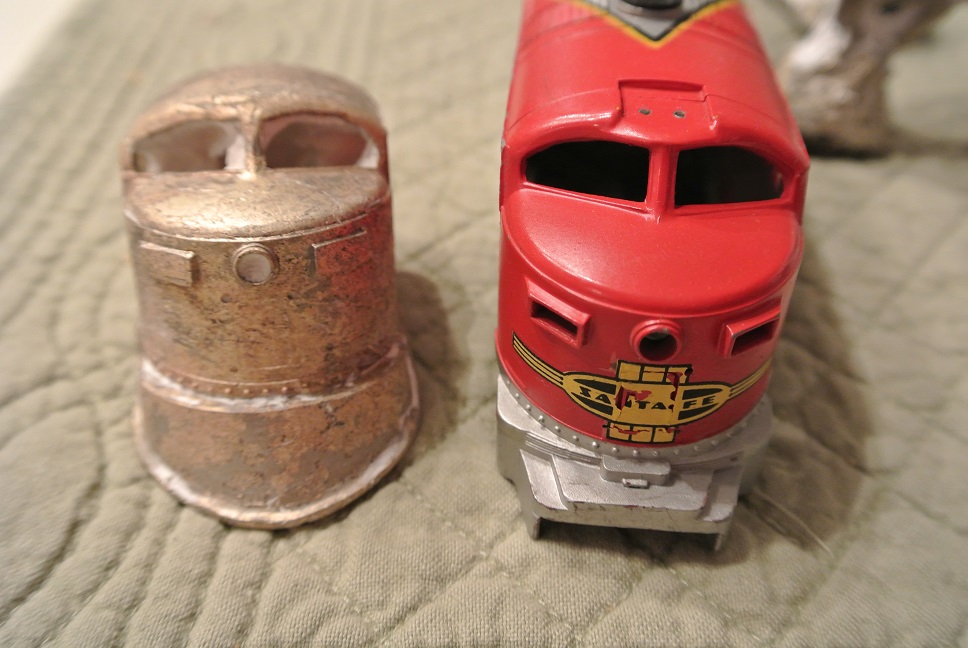

Here is the finished sculpture about 98% complete. Still needs a little tweaking and fidgeting but I'm pretty happy with how it has turned out.

 Posted - February 26 2014 :  12:35:02 AM Link directly to this reply  Show Profile  Add NickelPlate759 to Buddylist
That is so cool. I love the push button dynamic brake hatch.
