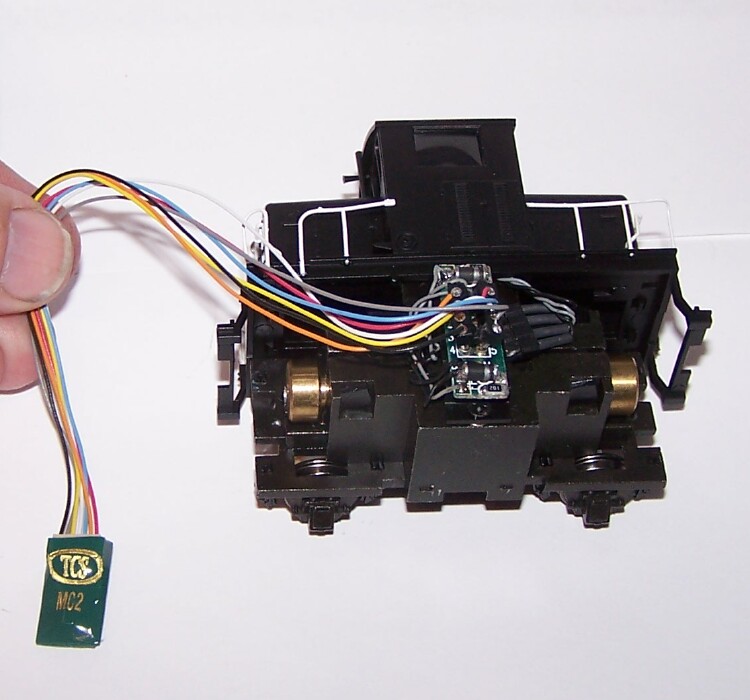

I got lucky last year, my closest-to-work LHS put out this nice MDC critter, since I like Hustler type switchers, I just had to have this undecorated one to let my fertile imagination sow some seeds of switchdom. Anyway, finally ordered a tiny TCS MC2 decoder to fit off Ebay a few weeks ago, and after downloading the appropriate files to both fix the factory problems and install a decoder, I proceeded to upgrade it today at work.
One problem I discovered when I researched it online, is that that MDC installed the LED diodes and wiring backwards at the factory. Long as you didnt' use lights, you would be ok but using that circuit would fry the decoder's light circuit. So following the directions, I used a SMD pincher-type desoldering tool to remove the diodes and turn them around, then reversed the gray and black wiring to the LEDs. Got that done at work this morning in about 10 minutes. Nice to have the right equipment handy! THen, I proceeded to raid the obsolete parts bins at work, and made a set of socket plugs to wire in the decoder harness. after cutting apart a special IC machine socket, I soldered the harness wirings into the two 4-pin halves, after reviewing the pin-outs of the 652 NMRA fitting. Got that soldered up, and then packed everything up to bring home.

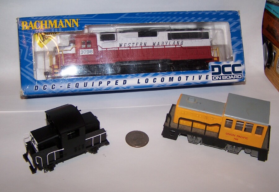

Got it out after cleaning up my PC area to do a little wiring work. Proceeded to try to install the decoder and wiring harness, but hit a snag, I REALLY should stop trying to save so much of the harness. Would not snap together with that much wire inside. So, gonna have to desolder the harness, shorten it, and then reconnect the wires. Oh well, lesson learned. I'll work on it tomorrow night. Here's some pics of the unit and a new Western Maryland GP40 I just bought at the same hobby store, $25 with a decoder on board. My 2nd WM engine ( got a BL-2 for that 1st one, ).

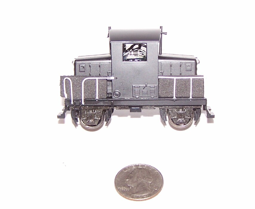

Wow, that critter looks small next to even the Hustler!
Tiny little thing! I intend to pull an open-sided tourist car with it.

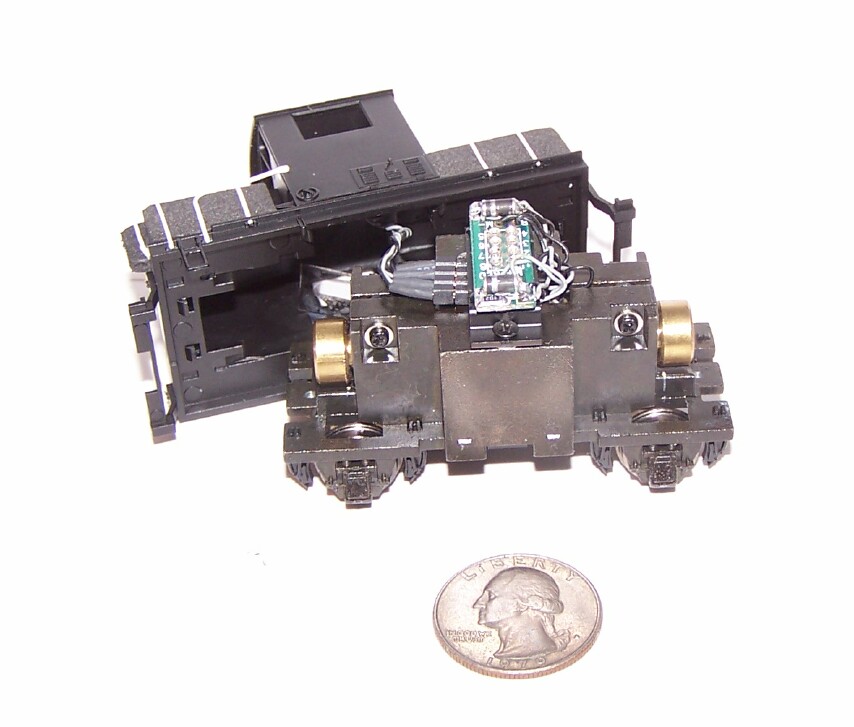

The inner guts of the Model 40 EMD unit
Unfortunately, too much wire, so cut it down about 70%, and will resolder tomorrow night.

I just finished reworking the over-long wire harness at work this morning, it fits in nicely now, and I was able to close the shell and put it all back together. annoying to see the harness thru the windows, but not much room in there. I'll see about adding some blackout in there later, but I want to test it tomorrow at my club's Open House. Should be fun little engine to chug around the branch lines!
