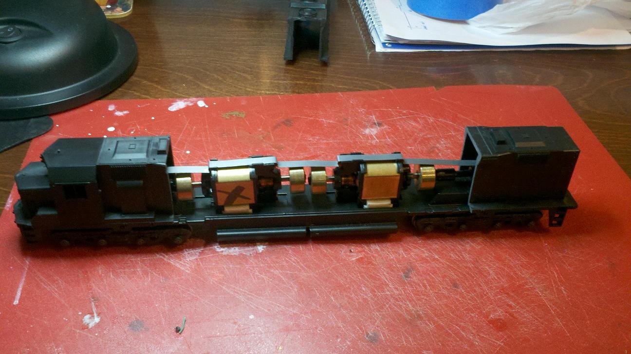

The best fit to answer the question is an older, Blue-Box era, Athearn DD40. It would have the space to fit, metal chassis, and with the drive couplers and shaft, will fit something larger. Two 540-size motors leftover from another project were deemed worthy donors.

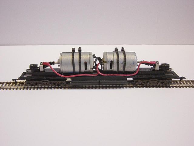

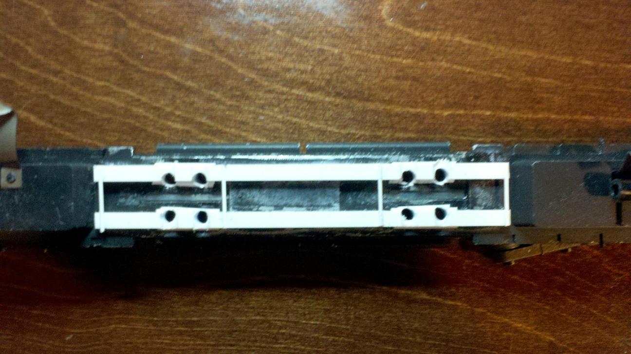

The first step was to mount the motors. They were connected to a DC power pack, and run to determine shaft direction. With the motors mounted back-to-back, they would need to run in opposite directions to allow for the same shaft direction. Spacing was determined on the frame, and then new mounting rails were constructed using .100” plastic stock. This will serve as an engine cradle, and also allow room to connect to the ground strips that will be under the motors. This is the same ground that the stock assembly used. Holes were then drilled through the new strips where the existing Athearn mounts were located. Cable ties will thread through these to hold the new motors in place.
The ground cable is 16-gauge wire, and with a crimp connector on the end, was bolted to the grounding strip after drilling and threading a hole for the connecting screw. Once in place, liquid tape was applied to the connecting for insulating under the motor. The positive leads were also drilled and bolting to the existing clips on each end, and then both positive and negative leads were soldered to the correct clips on the end of the motors. These were covered with liquid tape.
The motors were connected using the original Athearn couplers and shafts, although they needed to be trimmed down to about half of their original length. This is due to the overall assembly being so much longer, but it does all fit.
Motor testing followed, and these are strong. The squeal that you would hear from an R/C car? Now on a train. One of the initial concerns was whether the load may be too great for a DC transformer, but the MRC 1370 was more than capable.

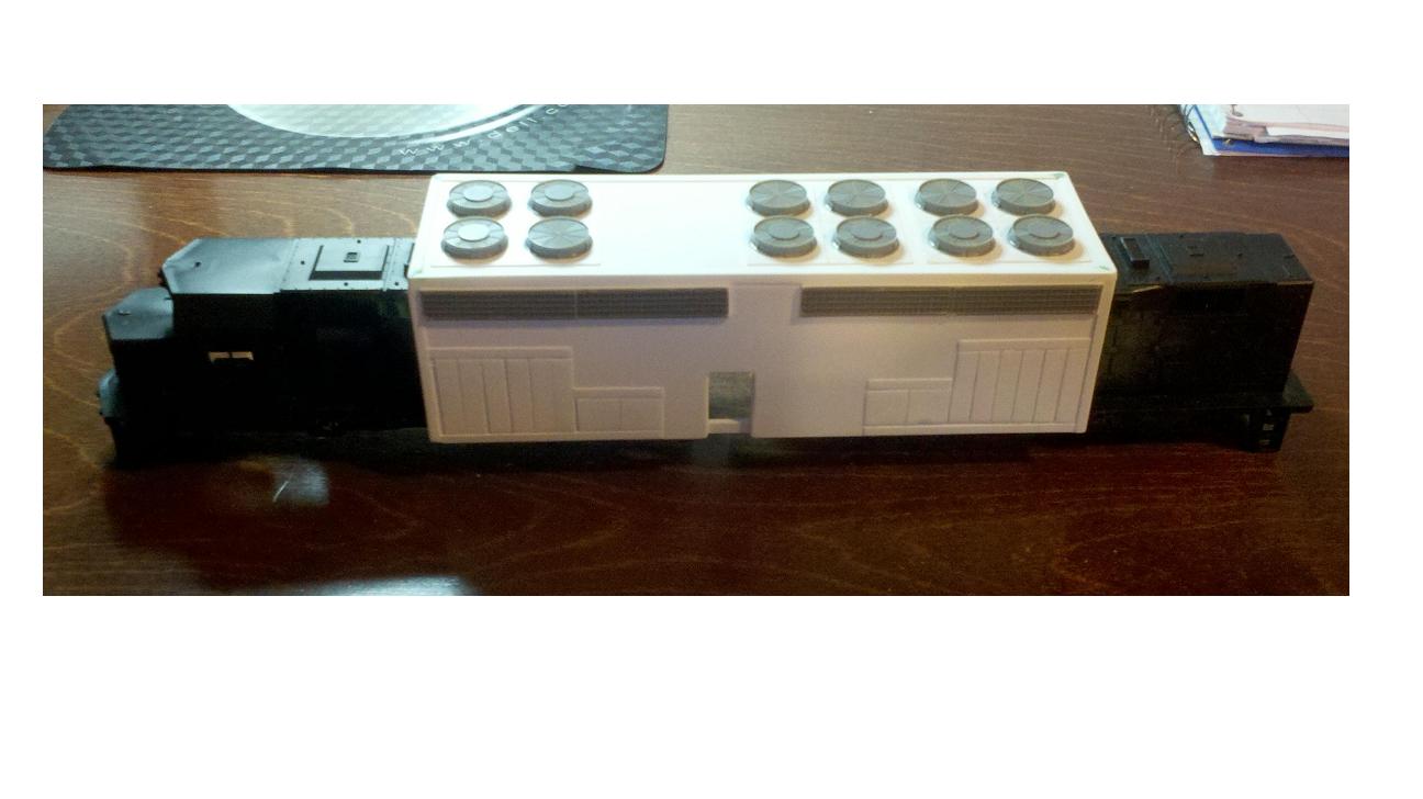

Modifying the shell was the most time-consuming part of the build. Many measurements later, it was determined that 158mm needed to come out, just aft of the forward stack. Slow and steady with a razor saw, and trying to keep the cuts as straight as possible, was key. Once complete, the cut ends were then block-sanded to square. These were then snapped on to another DD40 frame. Because of the necessity to keep them straight, it is easier to built the new section on-frame.
The new box is 158mm long, 45mm wide, and 45mm tall. It is built using 0.060 plastic sheet, then strengthened were possible using 0.060” strip. To try to minimize gaps and filling, there are angle pieces mitered in the corners. Side panels were simulated with 0.010 pieces. The vents are from Cannon and Company for EMD units. The fans on top are from Detail Associates; both are from Walthers.
