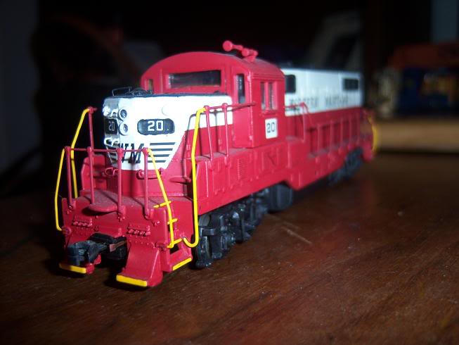

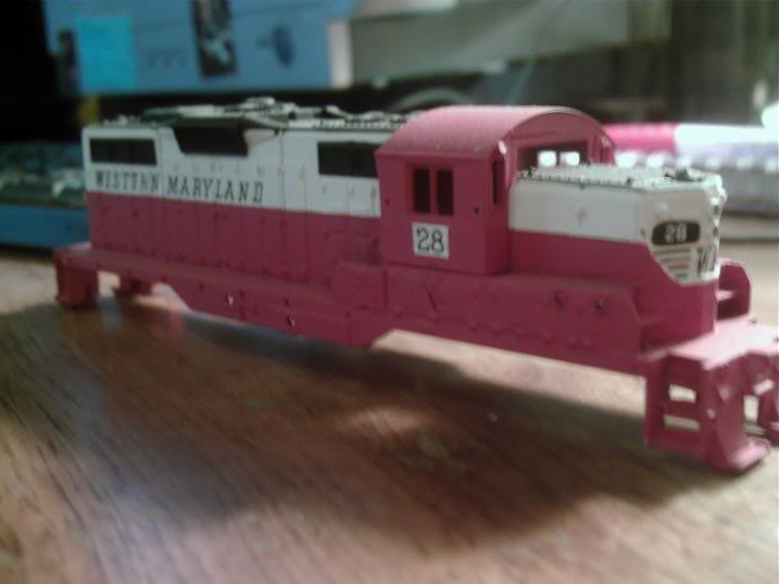

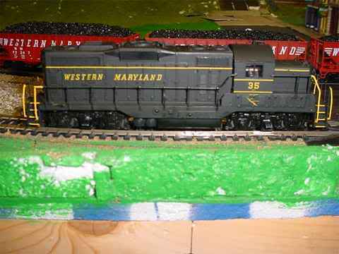

 Posted - March 31 2012 :  03:55:53 AM Link directly to this reply  Show Profile  Click to see EM-1's MSN Messenger address  Send EM-1 a Yahoo! Message  Add EM-1 to Buddylist
Anything like this:
Or this:
and then:
I custom made all these and I have one in Chessie System WM as well that I haven't got pictures online yet!
