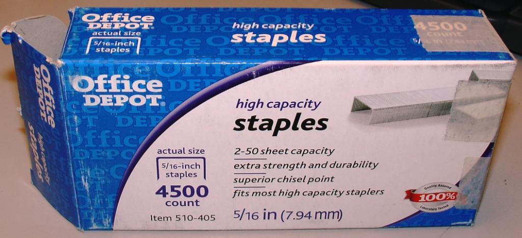

One other item: Office Depot high capacity staples have a longer leg- they are 5/16th inch (7.94mm), according to the box, with a chisel point, than standard sized staples. I found that underdrilling the hole size just a tiny bit, say the difference between a 70 and 76 mini drill bit (by hand, of course), enabled me to secure the staple point into each hole without CA glue.
I then trimmed the back ends (unless this is not needed for clearance) with a nipping plier- and then, applied a toothpick dot of CA on each just to be safe.

It just dawned on me that you may be asking for the width of the staple, not the leg length.
That 5/16th inch refers to the leg. The image on the box, at actual size, measures 1/2 inch across.

1/2" would be way out of scale. At 3/16th" the smallest I've found it scales out at approx 16" in full size.
