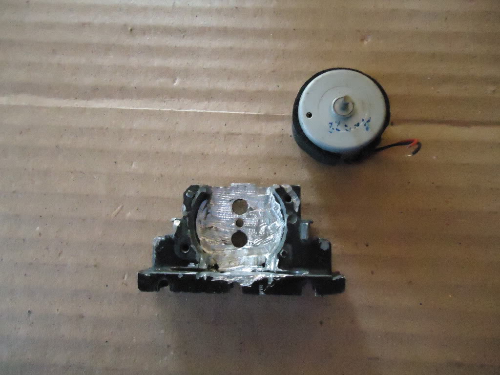

well I tried my first frankentorque on a c630 and discovered not only the shaft too big but the same problem as another member with the center wheel, learning this i got frustrated and popped the 3 pole motor from the shaft out in anger....
but it gave me a twisted idea
grabbing one of my athearn trucks from my scrap box i fitted it onto the old powertorque shaft, to find a pretty good fit, soooooo Im gonna try a modified tank drive and see where that goes.

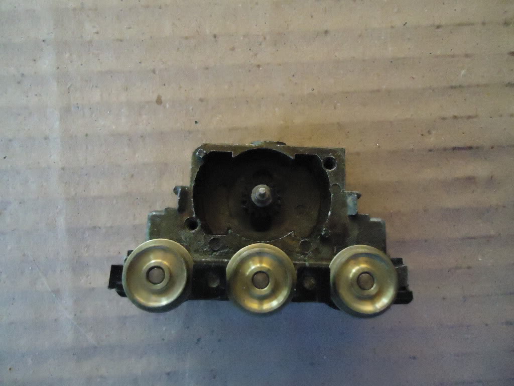

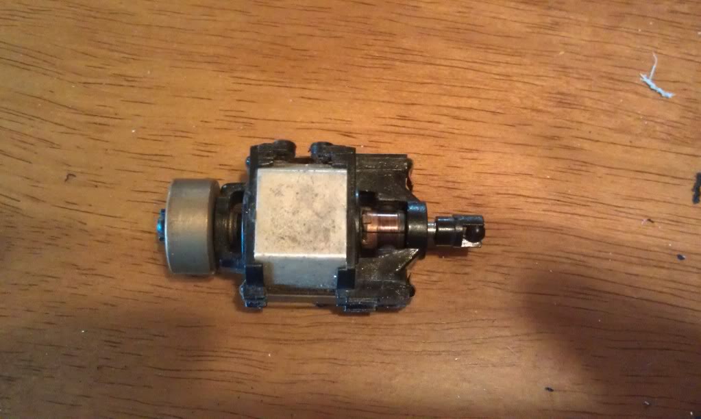

Ok here is the frankentorque that I used (notice the shaft diameter)
Next two photos are the v2 version gearing...

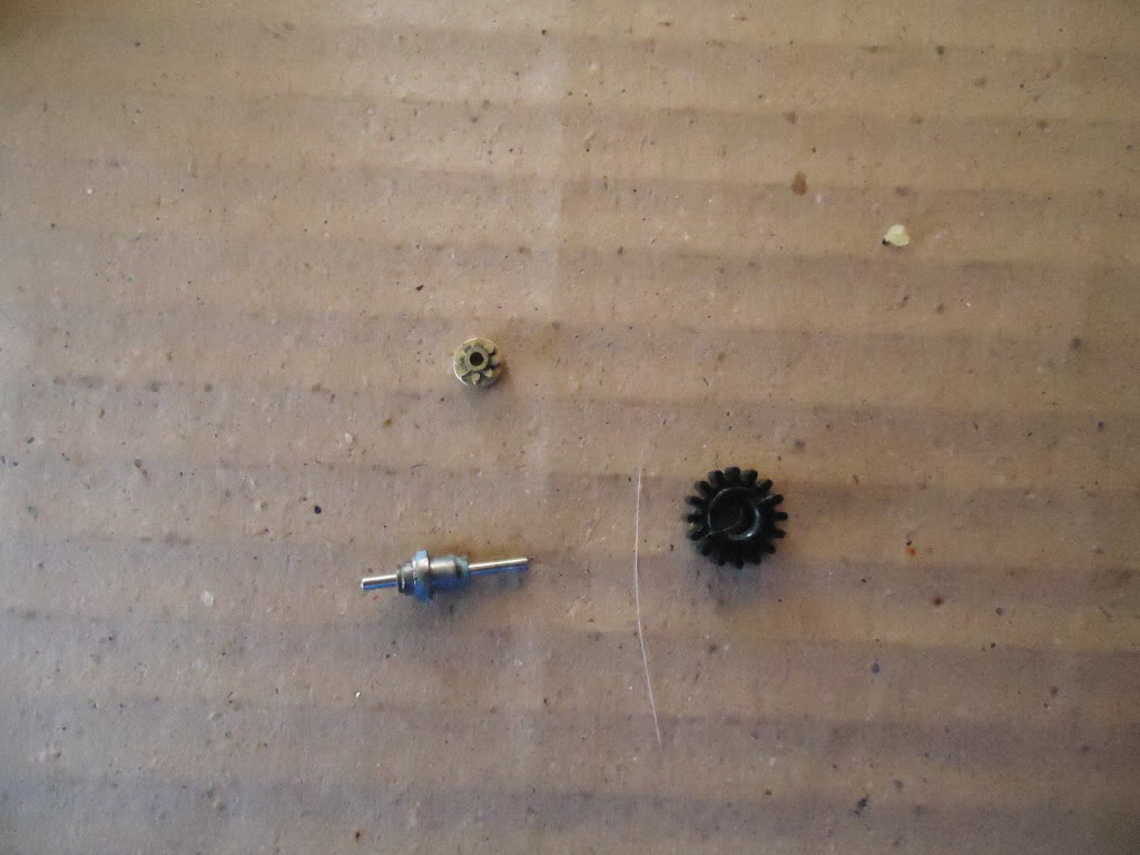

Shaft from the old PT, Athearn gear, and pt gear:
Next step will be to drill a shaft and install a worm gear..

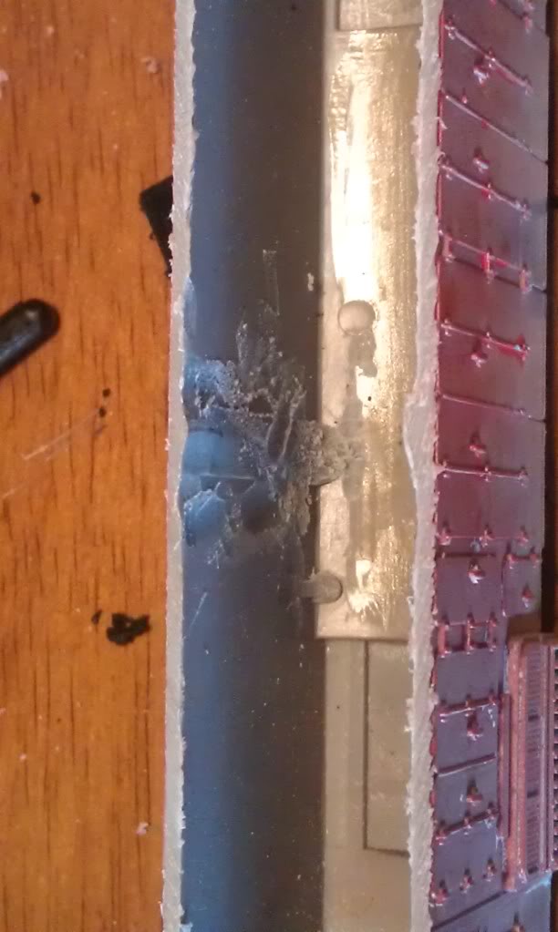

however I had made progress on another C636 project which is using a model power chassis (dang you Hypo) this project involved a PH III c630 and one of the more recent 628 chassis
one of the things I also did was replace the motor with an athearn switcher motor,

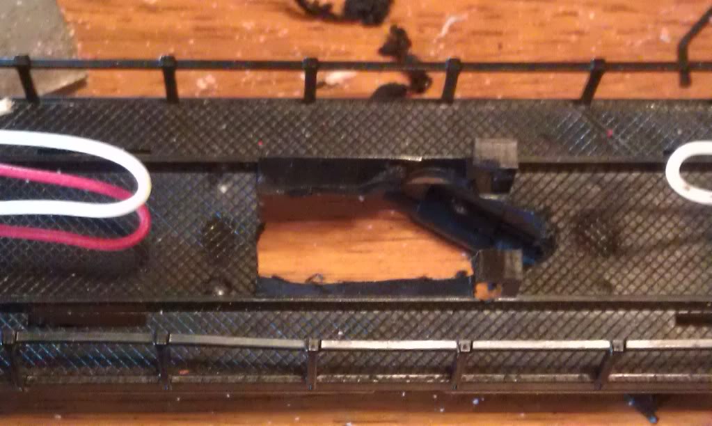

fortunately all the MP drive lines matched up perfectly only issue motor wise was I mounted it upside down to clear the long hood better.
Also I had to open the floor up a bit so the motor would sink in, right now I'm just doing rough clearing with a dremel as my file set is "stored" somewhere

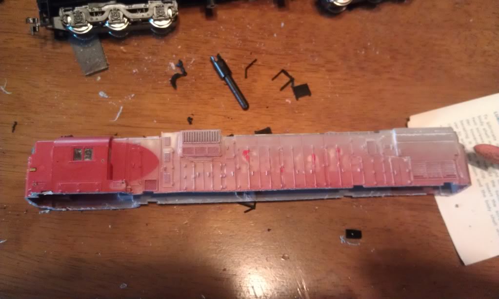

another oopsie I noticed was the cavity inside the 630. I had to "hog out" not only the mounting lugs but some other lugs or flash near the ceiling but after the main cut on the 630 body and hogging out the ceiling it fit fine.
Here's the body cut, so far everything fits with little to no putty, not bad for only having a saw and a dremel that was accessible...ok that was not within my brother's line of sight
