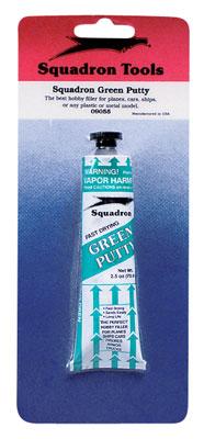

I was wondering what's the best thing for using to fill holes in plastic? My kitbashing project has alot of holes I need to fill! Then what grits of sandpaper do I need to smooth it all up when it cures?

I use Squadron Green Putty. After letting it set for a day or more, I wet sand it with 400 and 600 grit sand paper. One thing I've found is that the putty shrinks, so sometimes it takes a couple applications.
