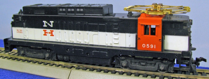

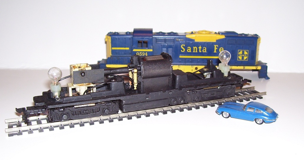

Is this a Lionel chassis that was also used under the Athearn Rectifier? It came under the Geep shell seen behind but it has Alco Type B-B trucks under it. Looks like the same chassis under the NH Rectifier on the right, in the current post about Rectifiers. Other pics of similar Lionel Geeps have the Blomberg truck like most EMDs used.
The chassis is marked Lionel but the shell isn't but the Rectifier below is.

This chassis looks the same including the trucks. Some versions of the GP used the Blomberg trucks.

The answer is No. The chassis in the picture with the 0594 Santa Fe shell was introduced in 1965. The last year the New Haven & PRR Rectifiers were cataloged was 1960. The Lionel Virginian Rectifier uses the Athearn Hi-F drive.

Are you saying its a chassis with the same trucks but a different design? The '60 catalog shows a PRR Rectifier and a GP, next to each other, and they appear to have the same Alco type trucks and chassis.
Are the Rectifiers powered by one truck too?

Lionel used the Athearn High F Drive in 1958. In 1959 they introduced their own chassis, which was 8 wheel drive using Neoprene O rings. The 1960 chassis is similar to the 1959, Lionel added more weight and larger drive shafts. The chassis was modified in 1963 again. This time it was 4 wheel drive, power to only one truck. In 1965 they changed the chassis again, different drive train, still 4 wheel drive. The final chassis was a direct drive unit issued in 1966. It had the motor mounted directly over the rear truck.
The New Haven & PRR Rectifiers were issused with the 1960 chassis. The 0594 Santa Fe GP-9 used the 1965 chassis. All of the Lionel GPs and Rectifiers shells will fit any of the chassis.

I'd really like to keep this the way it is but that's a good option. It does need the brakeman's side front step repaired.
I bought a B&O Athearn GP 7/9 shell at a show and found it doesn't quite fit.
The '61 Lionel Catalog shows a GP NYC with BBs #0596, and a NP GP # 0579 also with BBs and two PRR rectifiers with BBs and Blombergs # 0581 in th '60 catalog.
I think the Rectifier photo looks like the same trucks and frame as the GP but is it the same mechanism? My SF GP is shown in the '63 catalog link above, with the B-B trucks.
So this is the wrong chassis for the SF GP?

Alco Fan, The Santa Fe GP-9 was cataloged from 1963 to 1965. You have the 1965 version.

Are the cabs different, that is the version I have has a short length and a higher roof arch than some of the earlier GPs at least in the photos or illustrations?
Also would it have come with handrails in the box or without?
Edited by - Alco Fan on October 25 2011 5:52:47 PM

The Athearn and Lionel shell are different .

Can you tell me how to get the wheels out to replace the traction tires on the Lionel?
originaly posted by waw47
The NH Rectifier picture that I posted here is a switched out mechanism?
Any thoughts on the hand rails on the GP, with or with out?

just so I know Is there a Lionel name on the bottom of locos or what do I look for?
That SF loco looks abit odd with big bulbs inside

The bulbs remind me of automotive bulbs for headlights.
It is marked Lionel and New York City USA I think. It's probably the first one I've ever held.
Once I soldered the wire to the power truck it runs strong but needs traction tires badly.
Edited by - Alco Fan on October 26 2011 7:46:44 PM
 Posted - October 31 2011 :  9:44:42 PM Link directly to this reply  Show Profile  Add Alco Fan to Buddylist
Answering my own question here I did manage to pop out the axles and replace the traction tiire with the Calumet brand, those like the clear Goodies scrunchie. It took quite a bit of prodding with a small screw driver and removing the coupler mount on the front of the power truck, I was suprised I didn't ruin the trucks. It did run better but man is it noisey even when compared to the Athearns of 15-20 years ago.
