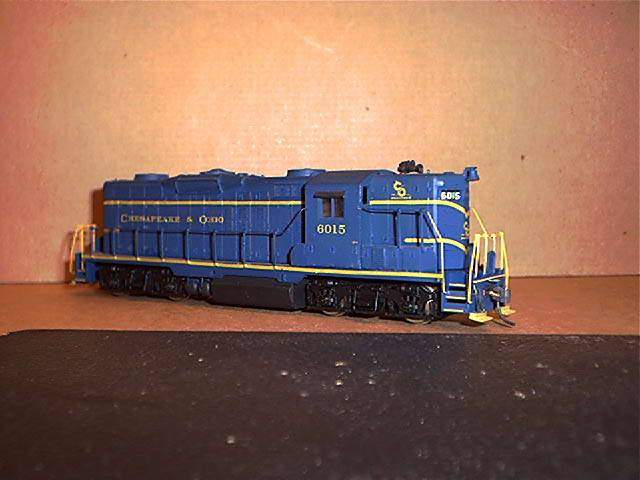

well a few years ago i bought an old ahm western pacific gp18. when i got it about half the handrail had broken off in the mail, so i broke the rest of them off & put it back. the other day i started digging through all my stuff & came accross it again. i put it on the tracks, & turned on the power, & boy i thought a real deisel war running through. man that thing was loud. i took it apart, greased up the gears, oiled the motor, & man that thing runs like a champ. i had to replace the flashing light on the top, i managed to break off one of the wires. thank goodness for radio shack! the only problems i have with it is the handrails missing, & it just looks small. were the ahm gp18's anywhere near scale?
what all handrails will fit it? or is this going to be one that i have to make a set for? anyone got a frame with all the handrails on it they would sell? remember i'm cheap.
i would also like to put flywheels on it. are they available?

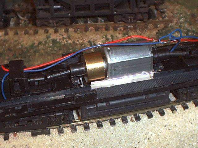

I built my own railings for the GP18s and other Mehano locos.
As for adding flywheels, I added only one on a can motor because of the limited space between the U-joints on the trucks. I kept the driveshafts as long as possible to prevent vibration due to sharper drive angles of shorter driveshafts.

The body shell appears to be very close to scale accuracy. The end pilots
on the frame are way too small for scale. Handrails can be fabricated by buying stanchions
from Smoky Valley or Precision Scale and bending your own wire handrails.
Or maybe a set of handrails from a TYCO GP20 might work. I am not sure,
just an idea.
I have remotored one loco using a Kato HM-5 motor and added flywheels.
Fits very well.

You can mount flywheels on the existing motor or a replacement can motor. Space will be the limiting factor though. I managed to mount a single like Ray. 2 smaller flys might fit, but would have less mass.
