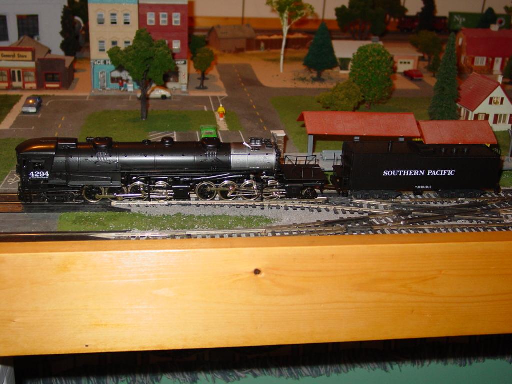

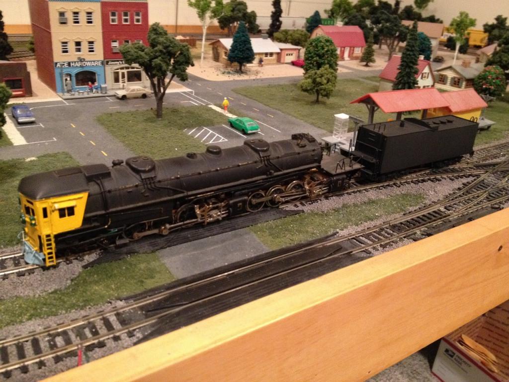

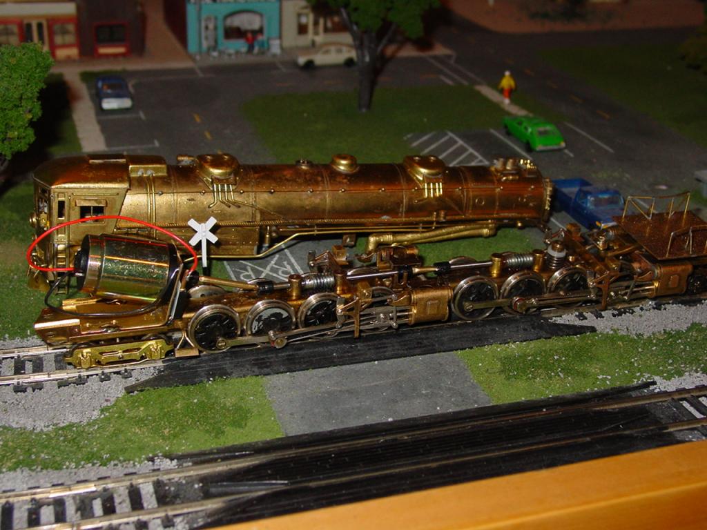

A couple months back, I picked up an Akane 4-8-8-2 Cab Forward at a train show. The mounting points were broken, the motor had a broken winding, and it had an awful paint job.
The paint was all brushed, and the yellow and blue were so heavy that all of the details were covered! Stripping it all off took some work...

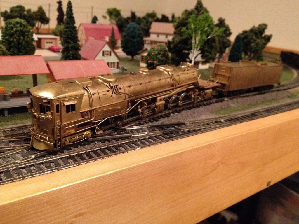

Looks a lot better! I managed to repair the Akane motor, and it's a very good runner, but I like top end coreless in my brass.

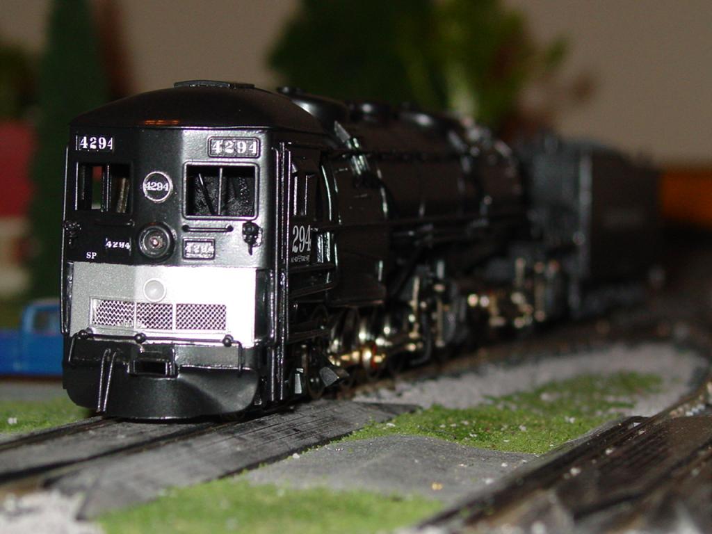

The new Faulhaber motor is a fantastic runner, and barely draws any current at all! I'm sure I'll find a use for the Akane motor eventually since it is a good runner. I also replaced the stock marker lights, since they looked awful. And now, I've finally got it all painted and finished!

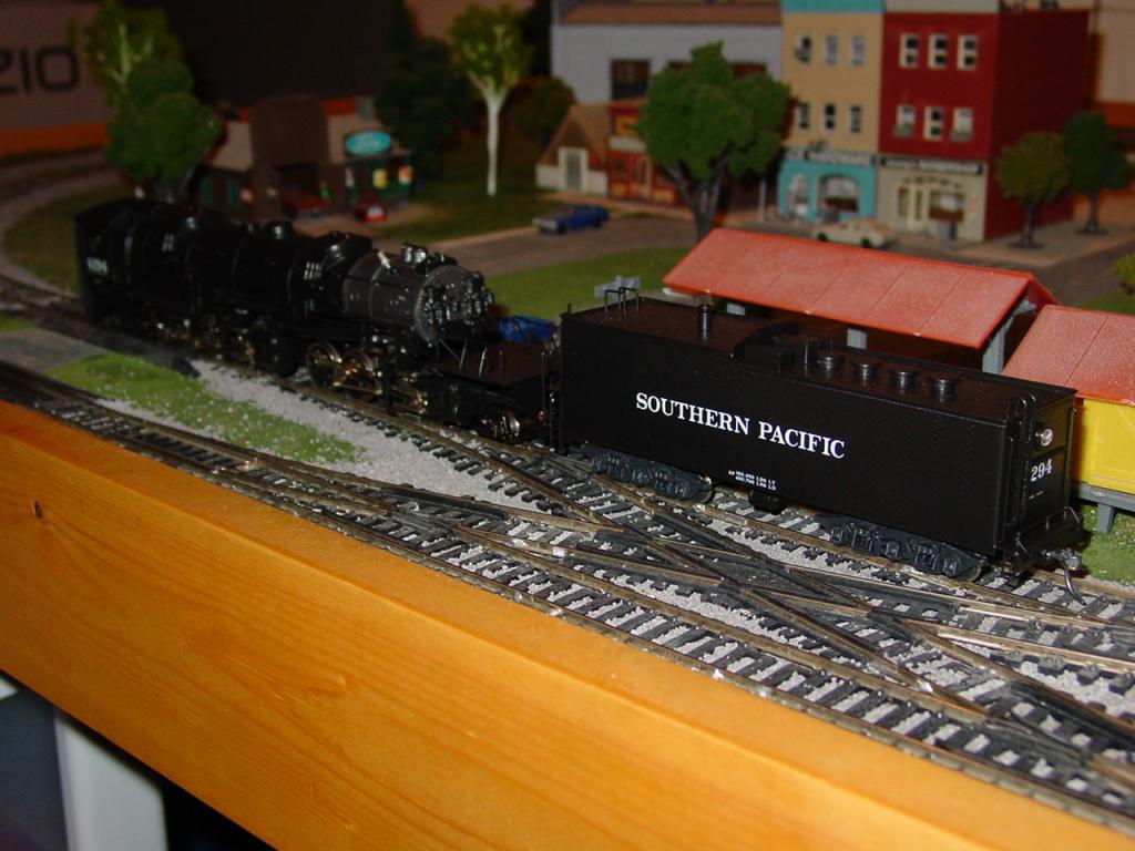

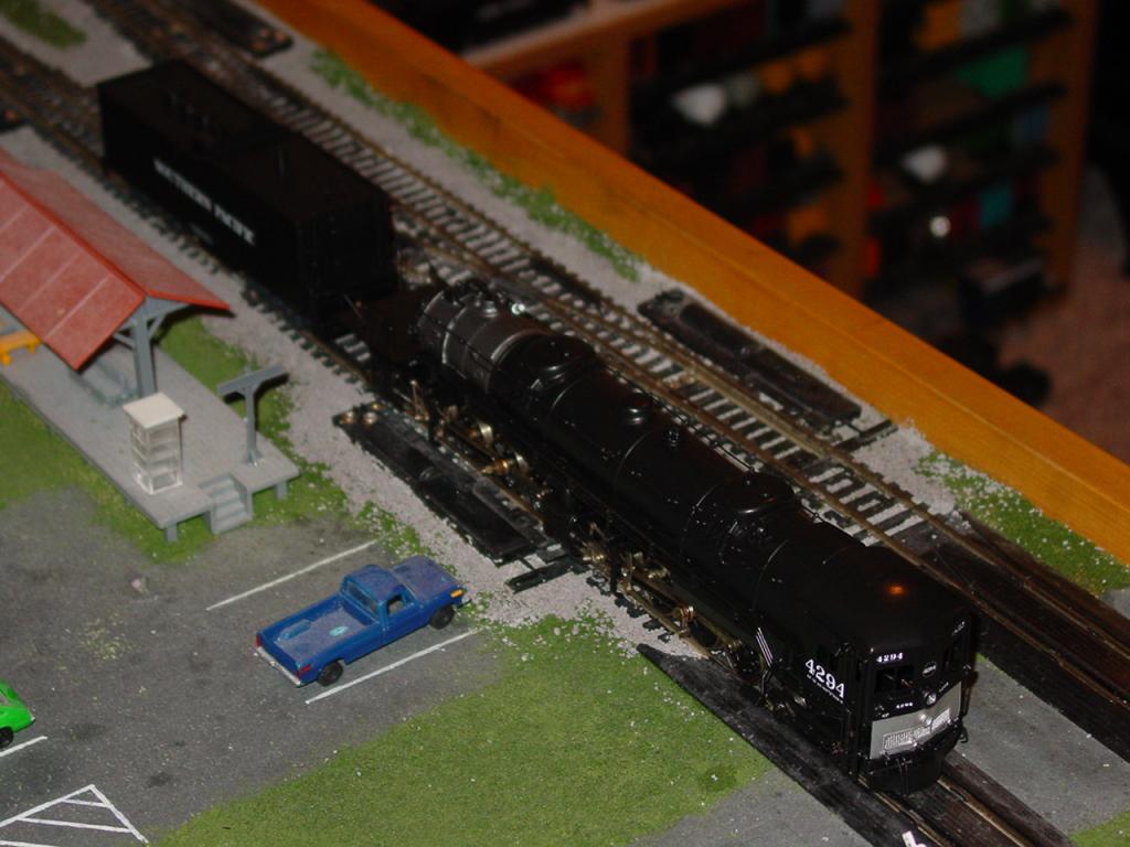

I think it turned out great! The smokebox and the band on the firebox are painted with a blend of Scalecoat II black and silver, and I made the firebox paint darker since that's how the prototypes often were from what I've found (went through tons of photos to be sure!). The only problem is that the Microscale number board decals were slightly too large, so I had to leave the "X" off the beginning of the top front numbers for them to fit.
To make it run on my 22" radius, I had to make a longer steam pipe to the articulated engine. It was difficult, but I think I've finally got it running really well on my layout. If I can ever get a room or basement for a larger layout, I'll certainly be running this one on larger curves, because it barely handles the 22" radius even with the new steam pipe!
According to the build certificate in the box, this one was made on November 13th, 1961. It's held up well!

Mustangs_n_Trains, I like the speed-up gear tower idea in that Allegheny! The Cab Forward is a bit slow at 40 MPH, so I may have to try that eventually.
NickelPlate759, he did like the repaint and restoration! There are a lot of interesting what-if's out there, but this one really needed that paint gone. It looks far better in the picture than it did up close.

Yup, still have it! I did swap the motor for a faster one though. As smooth as the Faulhaber is, the top speed with it was only about 40 MPH.
