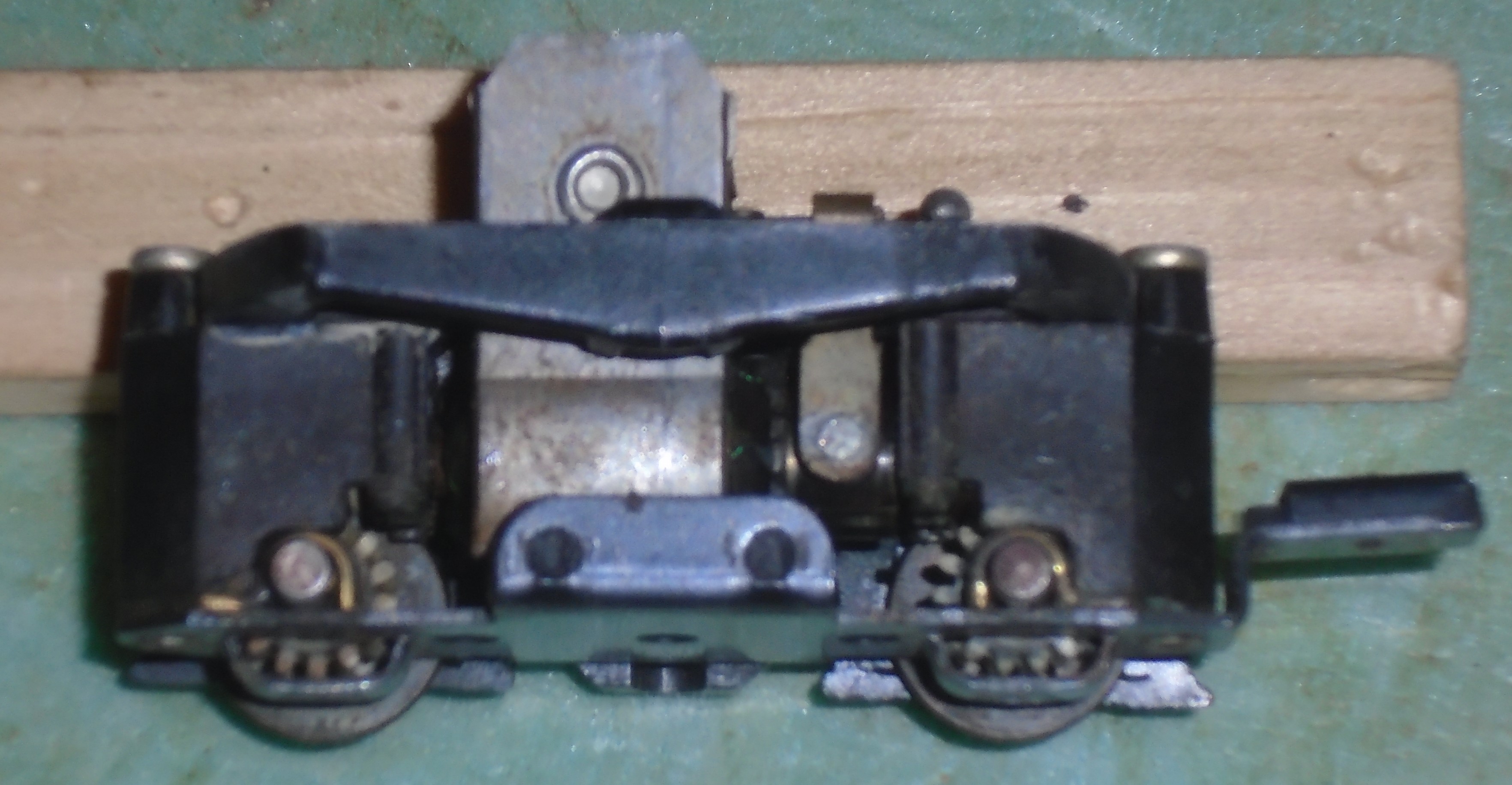

You shouldn't need to drill out the rivets on the motor truck to clean the gears, as Tyco diesels with MU-2 motors are indestructible, and can run well with only a little oil on the gears and clean brass contact wheels.
How dirty/corroded are the brass contact (or pickup) wheels on both the motor and front (dummy) trucks? If the brass contact wheels are dirty, the locomotive will not be picking up power well from the rails, hence why they won't run.
Hope this helps. I have many Tyco MU-2 diesels in my collection and have never once drilled the rivets out on the motor trucks. Just some lubrication and clean contact wheels will do the trick to get those old F9s running well again.

I’ve cleaned the brass wheels. Those were easy to buff up to a decent shine. I’ve got to get some correct oil and hit the gears. I’m away from home till next week, so it’ll have to wait till then.

Here's a tutorial that I've used for all of my mu-2.
