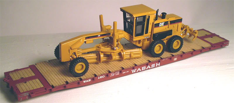

I'll post pics as I go along with this project...
The flat is an old Walthers 53'6" General Steel Commonwealth Flat Car decorated for WABASH. As you can see in this image, I've sliced off the cast-on grab irons on the ends and above each step. Also removed the steps.
I bought Details West Grab Iron Brackets 22"-wide (#6209) and Tichy Train Group Stirrup Steps Straight Side Mount (#3038) and will be adding them to the Flat Car.

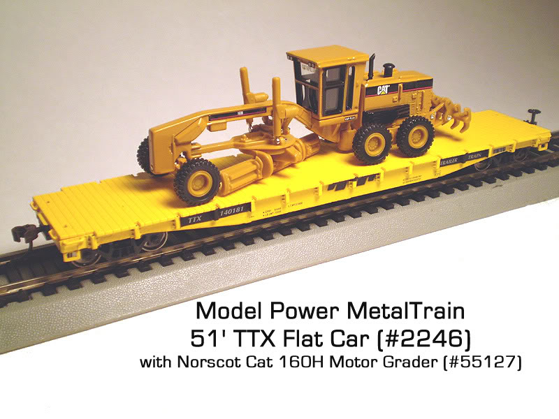

Originally posted by Hypoponera - November 20 2006 :  2:10:15 PM
I wondered if anybody would call me on using a WABASH Flat Car with a new Cat Grader, as the Wabash merged into the N&W back in '64. Okay, yeah it isn't correct.
Here is my other Flat Car getting worked on right now, again with the Cat Grader...
Problem there is the Model Power Flat is from the MetalTrain line and certainly needs no extra help in the weight department. Had planned on putting a pair of Boley HO-scale military vehicles or tanks on this Model Power metal Flat Car.
The Wabash flat is light and needs something heavy. I know it isn't correct, but then I also did a custom painted Wabash Athearn GP50 some year back, so I guess I'm covered. [}:)]

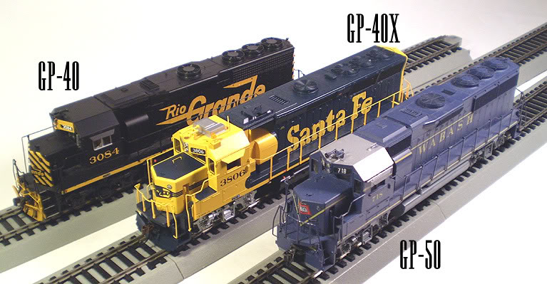

 Posted - November 21 2006 :  10:56:06 AM Link directly to this reply  Show Profile  Add Tony Cook to Buddylist
There's my custom painted Wabash GP50 sitting with the new Athearn GP40X in Santa Fe and an Atlas Rio Grande GP40. The Wabash GP50 was done in the late '80s or early '90s.
Did this pic a week or so ago, when someone asked about spotting differences between these models over on the Atlas Forum. You know we TYCO guys gotta help those poor Rivet Counters on the Atlas site from time to time. [:D]

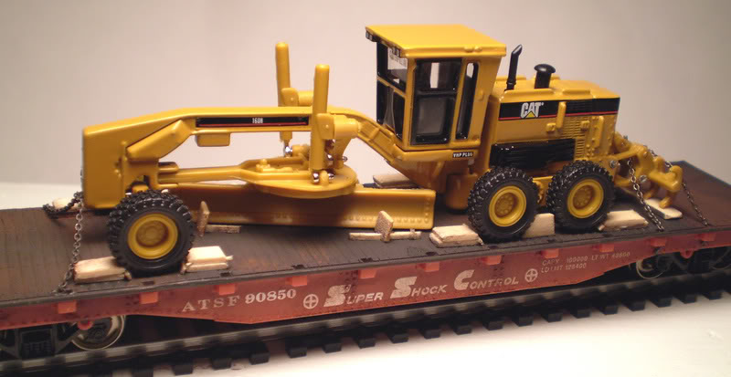

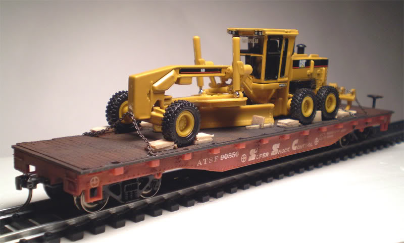

Got one of my Flat Cars with Loads done today.
Decided against the Wabash Flat Car for the Cat and went with a Santa Fe. The Flat Car is the lowest of low Bachmann standard line, non-Silver Series, that I picked up recently for $5.99.
Is it legal to put a die-cast $20 Norscot Cat on top of a $5 Bachmann Flat Car???
Anyway, I cut the wood strips and made the blocks for the wheels. That's A-Line's brass chain holding the front and rear of the Cat. The Cat is glued in place with CA cement. In fact, all the detail work is done with CA. The Cat is clean and new, but the Flat Car got a weathering with those weather chalks. The Flat Car required a spray of flat finish before the chalks would stick to it.
The plastic friction-style wheels supplied with the Flat have been swapped out with Bachmann Silver Series roller bearings. And Kadee Whisker scale knuckles are in place of the Bachmann EZ-Mate knuckles.
The Bachmann Flat Car was fairly light, so the heavy die-cast Norscot Cat was a good match.

 Posted - December 11 2006 :  3:52:35 PM Link directly to this reply  Show Profile  Send catfordken a Yahoo! Message  Add catfordken to Buddylist
nice one Tony proud to know you,Ken

 Posted - December 13 2006 :  10:20:41 AM Link directly to this reply  Show Profile  Add theoldreliable to Buddylist
VERY NICE, Mr. Cook!
Nice mods and details.
 Posted - December 14 2006 :  01:27:32 AM Link directly to this reply  Show Profile  Add GoingInCirclez to Buddylist
Great work! I really like the effect the wheel chocks have. Chain looks good too... I might have to try that.
So what made you decide against the other two flats? I really liked the deck on the Walthers car myself. But you did a nice job on that Bachmann deck, so no complaints [^]

 Posted - December 15 2006 :  07:42:06 AM Link directly to this reply  Show Profile  Add Tony Cook to Buddylist
Originally posted by GoingInCirclez - December 14 2006 :  12:27:32 AM
The Walthers Wabash car with the great looking deck is a terrible running car. Once I get a pair of trucks under it that'll keep it rolling better than I might do more with it. Had hoped the weight of the Norscot Cat would improve the Walthers' Flats performance...but it didn't.
Nixed the Model Power MetalTrain Flat as it is already heavy and didn't need the added weight of the Norscot die-cast Cat. Plan to put a couple light plastic Boley military vehicles on the MetalTrain Flat in the future.

 Posted - July 08 2022 :  2:57:50 PM Link directly to this reply  Show Profile  Add wks to Buddylist
"Got one of my Flat Cars with Loads done today.
The Flat Car is the lowest of low Bachmann standard line, non-Silver Series that I picked up recently for $6.
The Bachmann Flat Car was fairly light, so the heavy die-cast Norscot Cat was a good match."
Originally posted by Tony Cook on December 11 2006.
That is a great idea and looks fine on any layout.
