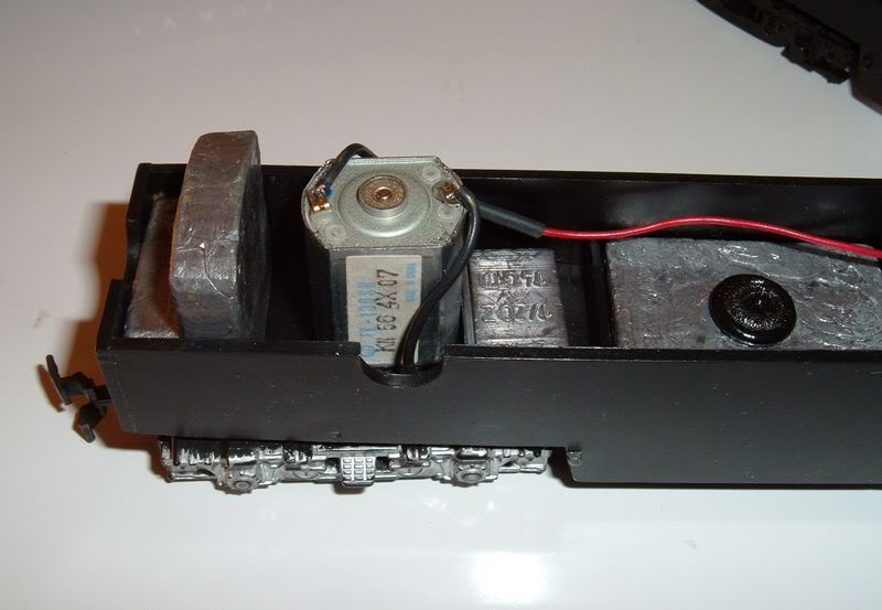

 Posted - July 14 2011 :  8:05:03 PM Link directly to this reply  Show Profile  Add NickelPlate759 to Buddylist
I just noticed this thread. The 3 pole motors in the C-Liners and BL2's that were used from the 70's onward are noisy as heck, and it comes from the shaft cogging inside the bearings, which are skimpier than the ones in the much better 5 pole versions from the 60's. If you grasp the motor shaft, you'll find that you can move it from side to side inside the bearing slightly, so there's enough play there for it to rattle up a storm when running. It can be quieted down with heavy oil or light grease on the bearings, but once it dissipates the growl comes back.
The gearing is actually quiet, but the fact that they used the worm to hold the truck on causes problems in alignment, especially if the worm is split (and a lot of them do) and slips on the shaft. The 60's version had a brass worm and a ring with 5 ball bearings between the worm and the truck, but in the later ones it's just plastic on plastic. What I do is put two large NWSL washers (# 114-4) between the worm and the truck housing (you'll need to ream the washers a tiny bit to get them over the shaft), then make sure that the worm is on tight enough that the truck turns freely, but doesn't flop around vertically. Teflon grease works very well on the plastic gearing. You can reuse a split worm by degreasing it and gluing it in place with CA.
Here's one I remotored with a can.
The motor is just glued to the bottom plate of the old motor, and it runs smooth and very quiet. It's a perfect speed match for my repowered RS2, because they have identical motors and gearing.
