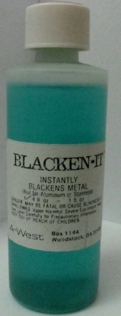

 Posted - March 25 2013 :  06:51:02 AM Link directly to this reply  Show Profile  Add Brianstyco to Buddylist
I have used this - From A West - bought at a train show several years back - works great. it is poisonous - so keep away from your pets and kids. Have even used it to blacken metal parts on vehicles - IE - wiper arms
 Posted - March 26 2013 :  05:10:24 AM Link directly to this reply  Show Profile  Click to see EM-1's MSN Messenger address  Send EM-1 a Yahoo! Message  Add EM-1 to Buddylist
Well, to give a cheaper alternative..........I visit the local "Stained Glass Store" pick up some Black Patina, made for Brass, Chrome, Zink, LEAD!, and just about any other metal! Costs about $6.00 a bottle, and sad thing is, you need a DIFFERENT type for each metal, you can EVEN get it for Aluminum, AND Copper! and is pretty much the same thing shown above as "Blacken-it" and works much the same way! I might add, it LASTS a LONG time, a 6 ounce or so, bottle full!
