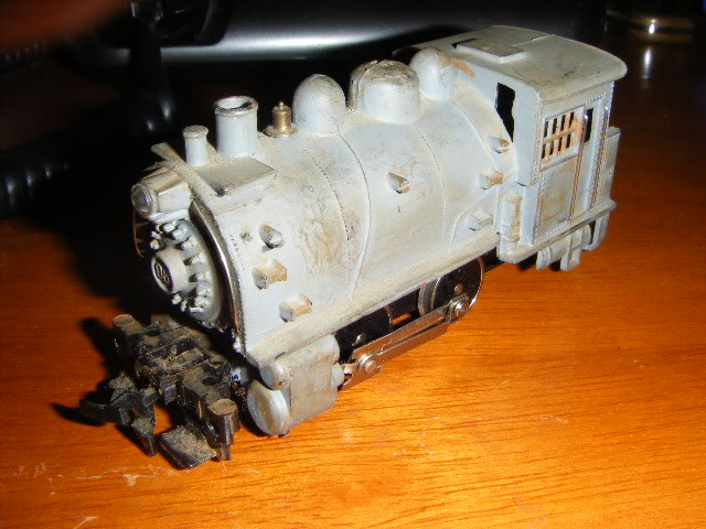

 Posted - January 05 2011 :  11:03:03 PM Link directly to this topic  Show Profile  Add RDC1 to Buddylist

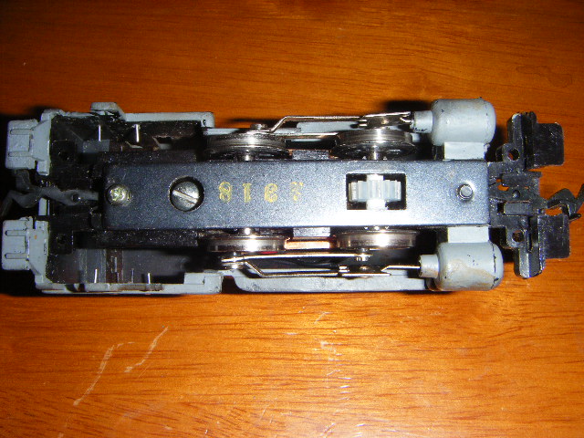

I pulled this off of the top of my neighbor's trash can. It's the dirtiest engine I ever had and it has a split drive gear on the axle. I pulled the body off, gave it a quick scrubbing & lube. The motor runs great and I'm waiting for Yardbird Trains to get back to me on a replacement gear. When I clean it up, paint it and replace the rails, it should turn out a pretty nice little lokie.

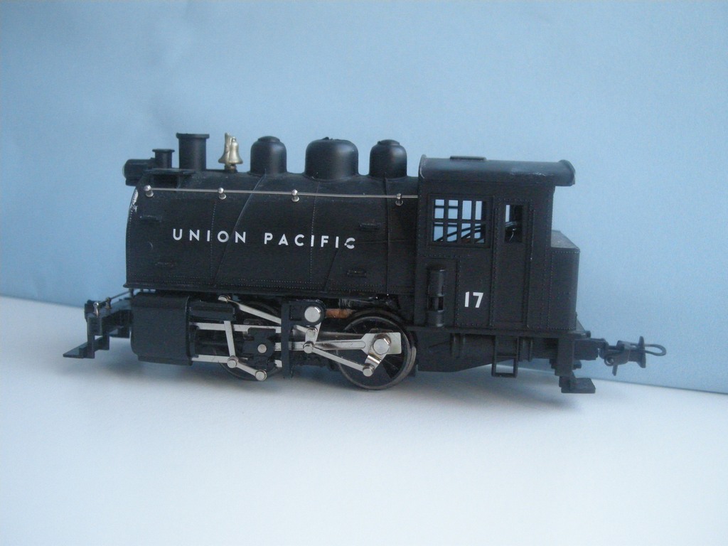

Nice! Bowser has a Valve Gear Kit for it! - Erich

hi rdc1 no not new but extra valve gear,the gear you have at the moment is the basic,bowsers is what they term super detail see link ken
http://www.hoseeker.net/assemblyexplosionBowser/bowser040docksideold3218.jpg
the super detail kit you would need is #460 Valve Gear Kit

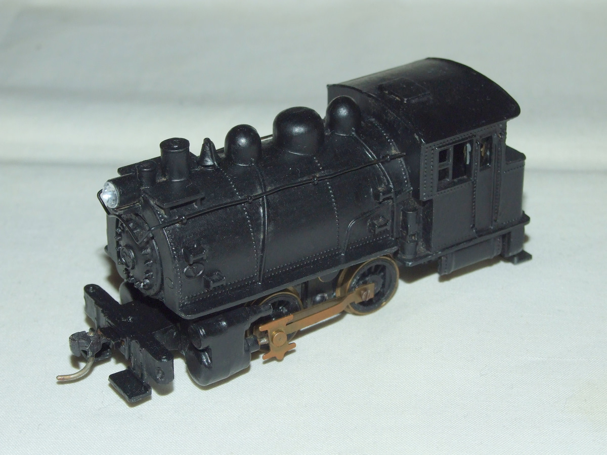

i think you have a lifelike one,looks same to me ken
http://tycotrain.tripod.com/lifelikemodeltrainscollectorsresource/id42.html
this is a varney plastic body on a lifelike chassis ken

OK, after weeks of searching, I could not find a direct replacement gear for this lil' lokie, but I did find something close at https://sdp-si.com/eStore/

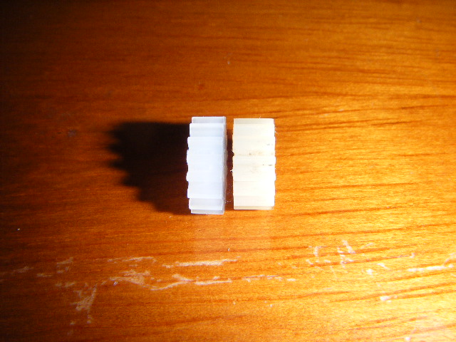

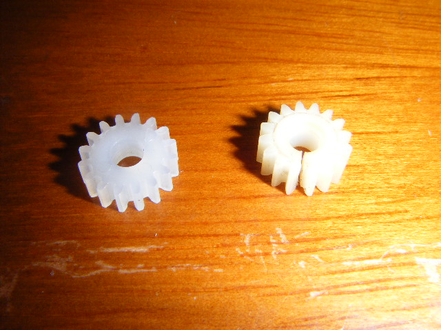

You can see the split in the original gear on the right.
In this photo you can see the difference in the width and diameter.
The new gear is a little larger in diameter, not quite as wide and the hole for the axle is slightly larger. Now, I hate to admit that I did this, but it worked. I used the Ernst Gear Kit method of enlarging the axle diameter by wrapping a small piece of Scotch tape around it. The new gear fits ... so far, so good.
With the engine reassembled, the gears were binding a little bit, so I shimmed the bottom plate, which happens to hold the axles in place, under the front mounting screw using a fiber washer left over from a Kadee coupler. This thing runs really good now! Next, I'll trim the scotch tape off of the axle and secure the new gear with some epoxy. After that, I'll clean up the flashing from the poor molding job, paint it, detail it a little bit and install some LED lighting.

The tape is necessary to enlarge the axle diameter evenly, to ensure the gear is centered and true to the axle centerline. One caution with this approach is to make sure the tape ends align with each other at the seam through the layers. and do not overlap.
That said... tape COULD wear. So what I would do is cut the strip of tape to be slightly narrower than the gear. Center the gear over the tape, and you should then have a small gap between the gear and the axle on either side. Fill this gap with epoxy or what have you, and that should be a much stronger repair with less likelihood of wear and slippage. Haven't tried this myself, but it seems like it should work.

I actually left a 2mm gap between tape ends to prevent wobble on the gear. That's a good idea to trim the tape so that the epoxy goes beneath the gear. Thanks!

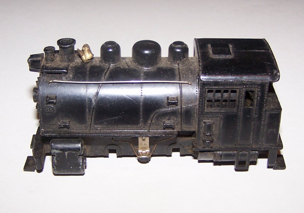

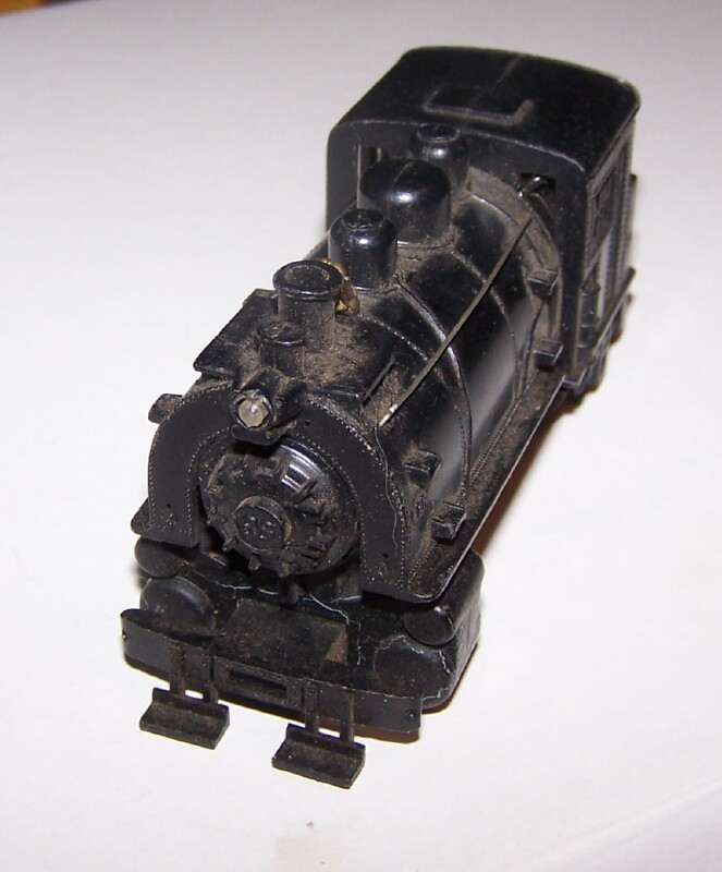

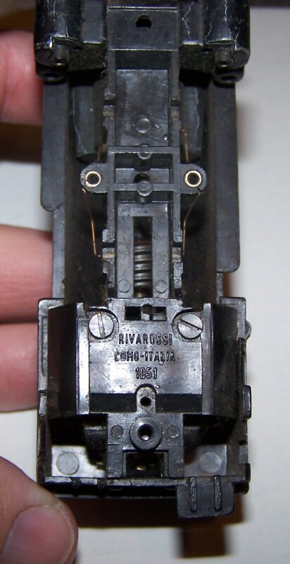

After looking at these little engines, I dug out my stash of junkbox Rivarossi engines I'd bought from my club buddy last year. I have one exactly like these here, mine says Rivarossi Como-Italia 1051 on the bottom. The fairly complete one has a broken off step in back, and a spare shell is in better shape except for the rear step area, which is broken worse, and the smoke stack is cut back some. Now all I need is the drivers and rods to complete one.
I may have to try those Lifelike wheels and rods to get this Rivarossi back running again.
BTW, I noticed the center of my front engine door had 98 imprinted inside it. Do any of your versions have a number printed there in front?

Yup, mine is 98 and I believe that the Varney is also 98. I've seen photos of B&O's 98, like this one:
http://star.ap.teacup.com/1435prr/timg/middle_1229327217.jpg
