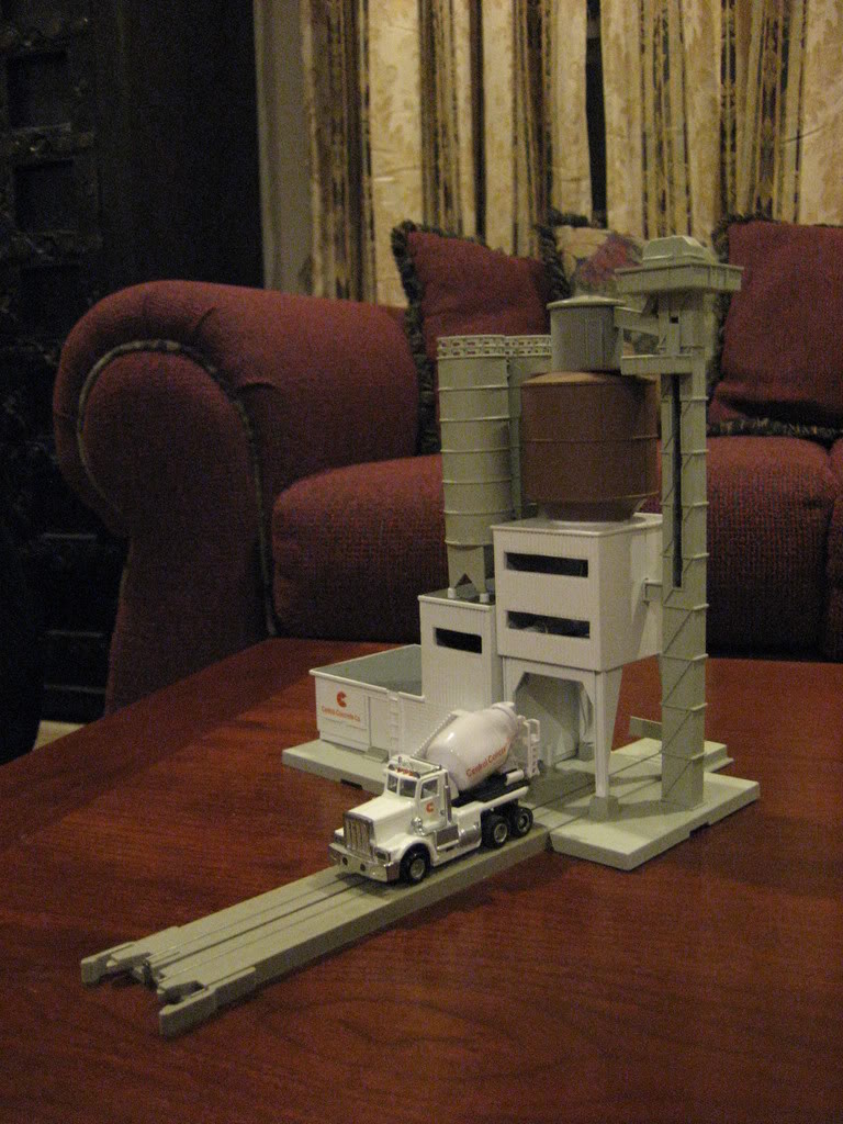

My custom cement truck & cement factory (a la IHC)-

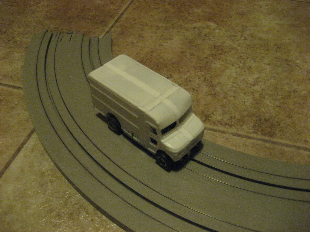

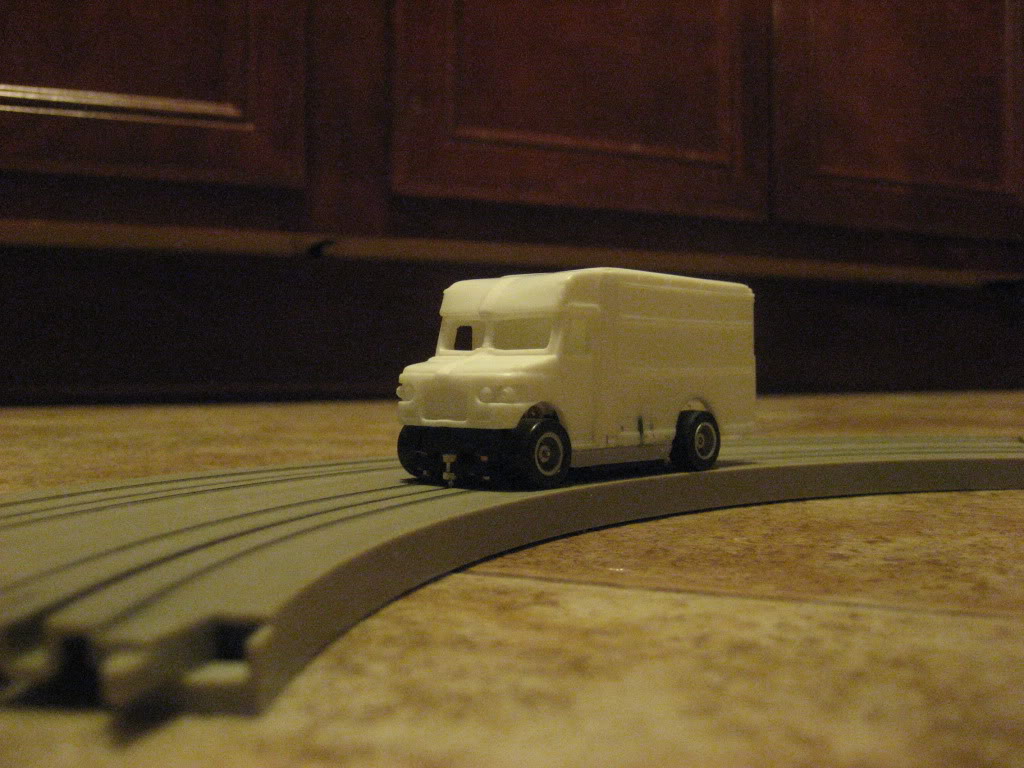

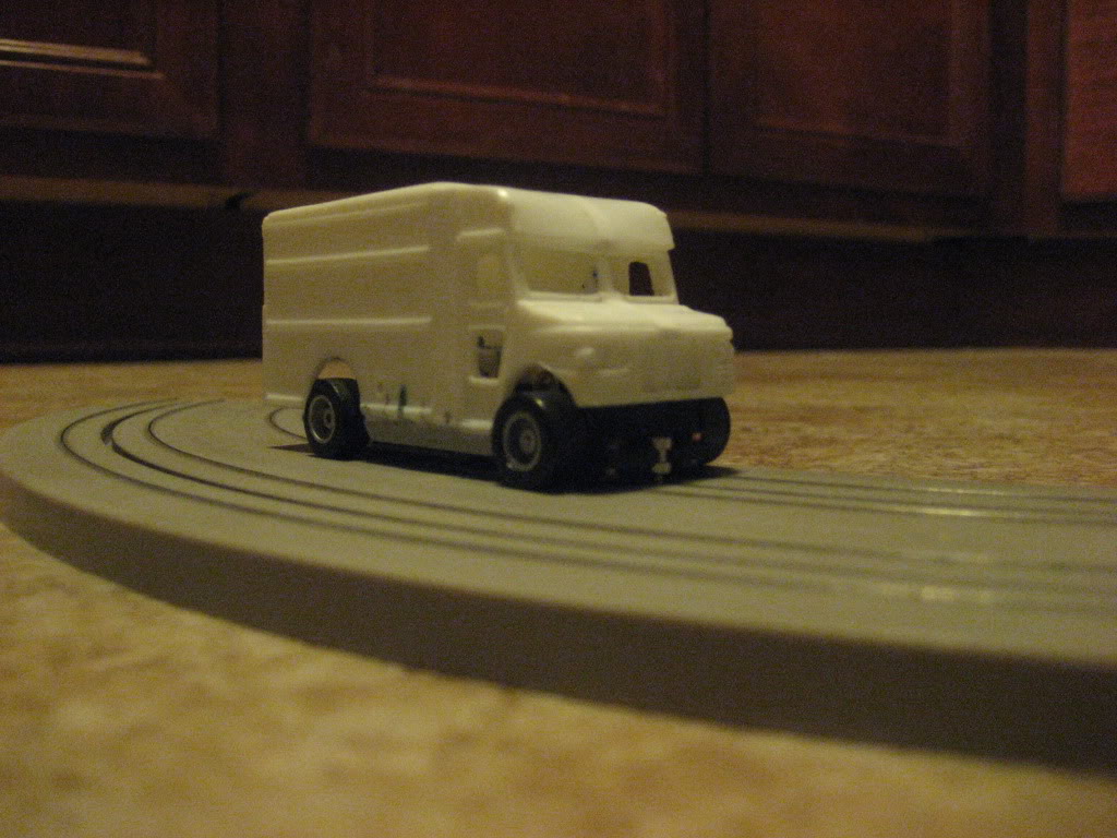

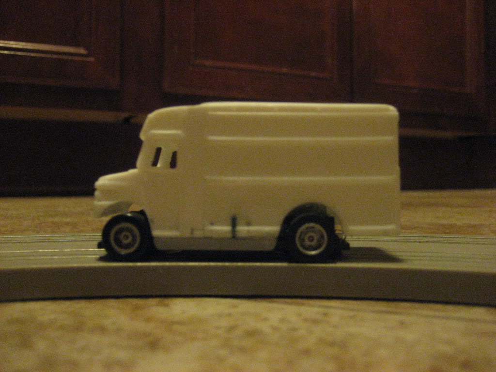

Well... it is taking shape.
I've settled on a delivery truck for Krispy Kreme Doughnuts. FWIW- Krispy Kreme is based out of North Carolina as well.
I purchased a Union City Body (aka UPS Truck) custom off of Ebay a few years ago. It is a bit small for the US-1 chassis... but nothing that 1/8 inch sections of styrene wouldn't fix.
In all, I had to section the body into four parts and then add 1/8 of styrene to the length and width. So, I cut it along the center and right behind the doors to expand it out to fit. It is a wide beast now! Any wider and the tailgate would strike the trucks on the other side of the road!
I also had to develop a means in which to get it to clip onto the US-1 chassis. For this I used the center channel groove located between the OEM tabs and then the bottom chassis rail below it. I did have to add rocker extensions (silver) and then the pieces to slide into the groove (green).
Next up... high build primer for the roof. I need something to work like body filler. Then- white paint and custom DECALS.
Here's the progress so far. Thought I'd let y'all see some of the "in progress" images. Enjoy!
