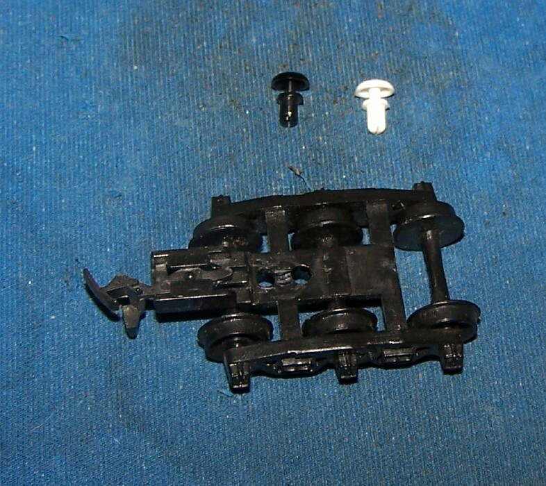

While sorting thru inventory at work, I ran across some push-pin rivets, ie they have a rod and head, and two jaws, and when you push the pin in, it splits the jaws wider, and holds the two pieces of whatever together. Well, these are 3mm, plastic, and small. I took one of my tyco 3-axle tankers to work and tried it out. hey, it worked! Here's the photo sequence of what it looks like after this repair.
Now, one thing, the rivets are only shallow, and they hold, but not so you can't pull them off. I'm wondering if I can find longer shaft of this type. Probably. Anyway, it works, so I'll use it for now. On with the show -
This shows what the rivets look like, and that I cut off the broken truck retaining pins, and cut them as flush as I could get.

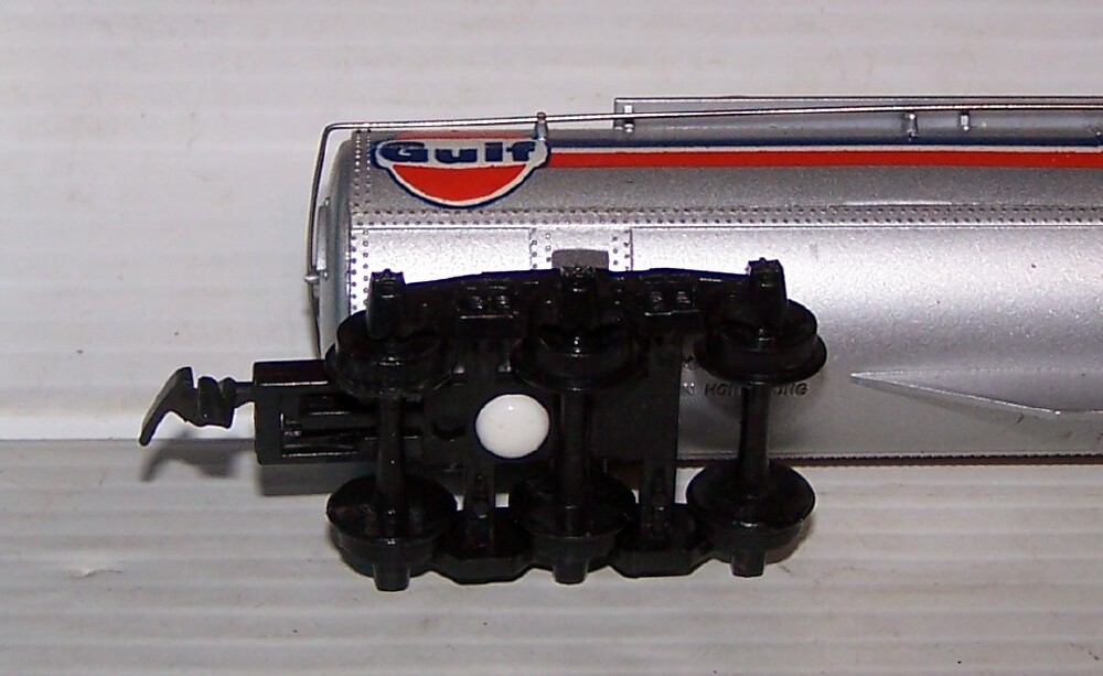

Here you see the rivet flush with the bottom of the truck, and it does a nice job of holding the truck to the tanker. Again, it's just a friction fit, but it's better than what you have with the broken hold-in pins.

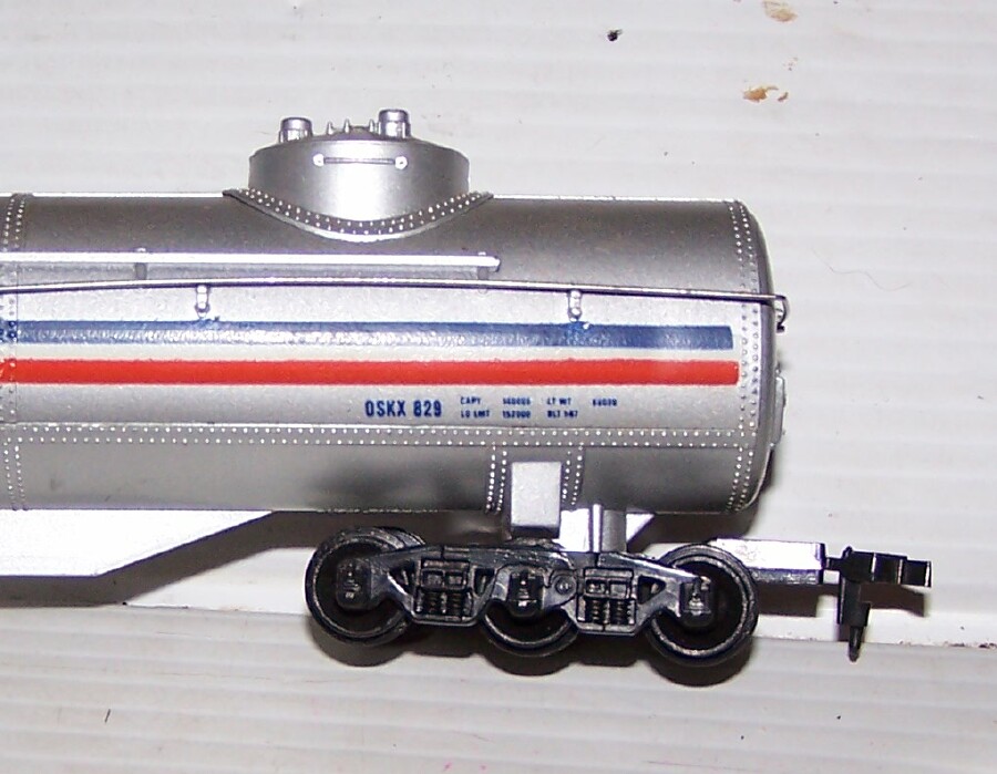

here's what it looks like from the side. Since it's only adding less than 1/8 inch to locating the truck under the tanker outward, it really isn't noticeable that its' shifted much. I'm using one of the two holes on either side of the former pin stud on the truck. Actually the one closest to the middle axle. It swivels fine, and you have to work to get it to come out. So I consider this a win-win at this point. Longer rivets would probably work better, but as long as you don't' get violent with the movement, I think it'll stay ok with even this shallow a rivet. If anyone wants some to try, I can put a couple in a standard mailing envelope for 43 cents and mail them to you. We apparently don't use this item any more, so they're going to become "excess inventory". And I'm the inventory manager for the old legacy products. Less stuff to keep track of! I'll have to see who we bought them from last. But a search on plastic push-pin rivets should find something like this. So save those old broken 3-axle trucks and reuse them.
