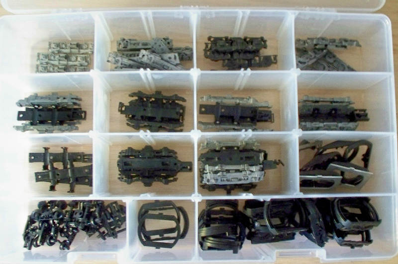

I have an enormous stash of these-take a good picture of the one you have & I'll send
you one if you like. If not, epoxy can work well-just be sure you clean it really well first
to remove any oil or grease residue. If the round plastic pin that is broken off is still in
the black truck frame, sometimes these can be pushed out (push from the outside in)
and glued back on the sideframe, but then you have to sand or file away the melted
part to get it to go back through the hole. This is usually way more trouble than it's
worth. If you go the epoxy route, scruff it up a bit with a scotchbrite pad or fine
sandpaper to give the epoxy something to grab onto. Pictured below is just part
of the ridiculous Tyco parts stash I have managed to accumulate over the years...
