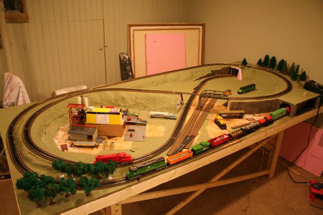

Hey Guys,
Thanks for all the welcomes to the group. I thought I should post about my new layout.
I last tried to do a layout when I was a kid. It was pretty horrible. As I recall it was a 4x8 sheet of plywood with an oval on it. I remember having some switches so it was probably some sort of double oval. I was starting with parts from a Tyco Over and Under trestle set but I doubt I ever got that to work correctly. Those little plastic trestles were so tippy. I had some of those foam mountain tunnels from Toys R Us as well.
So, as an adult it has been really interesting to come back at this as I can think about possibilities in a different way and the internet of course puts many options at your finger tips.
I'm still limited to a 4x8 as far as space and I'd like to put as much action on there as possible. I'm partly doing this as a project with my young son and he likes to watch the trains go round and round.
I had a 4x8 sheet of drywall sitting around so that seemed like a natural choice as a board to build on. So far it has worked pretty well though the edges were a little banged up so I'll probably put some kind of wood around the edges to protect it.
My first thought was to re-create a simple over under figure eight like I'd had as a kid since it seems much more interesting than an oval. I also wanted a spur that headed to an engine maintenance facility so that was added into the design. Knowing I could fit more on the layout I started to experiment with other ideas and it has evolved into the mock-up in the photos. The figure eight is the core of the design but it has a loop worked into the route so the train will do the loop and the figure eight before repeating itself. Instead of using a crossing piece where the loop crosses the eight I opted for raising the back side of the oval instead so it becomes a raised crossing with a bridge. I also opted for a viaduct type set-up on part of the high track so I can run track underneath. One fun thing is that on the far end the track is completely hidden by the raised section so I opted to make that a tunnel section.

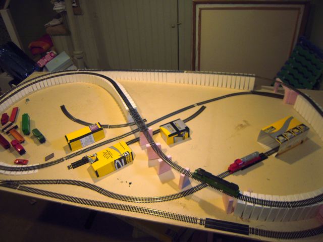

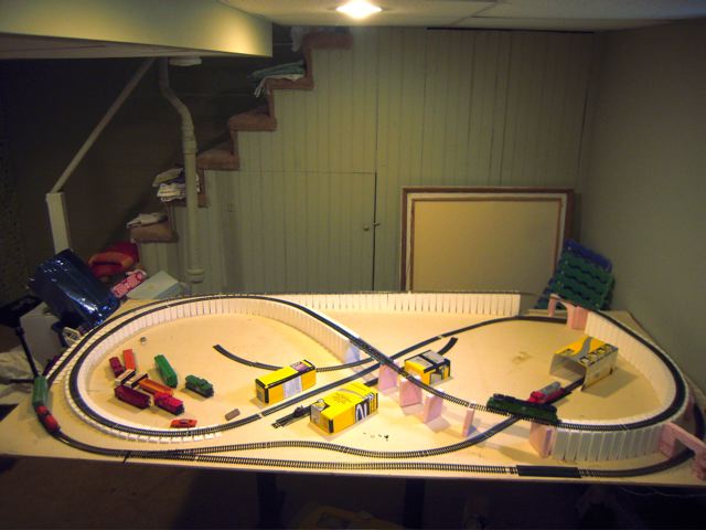

Here are the photos. First off, the shot of the whole layout thus far.

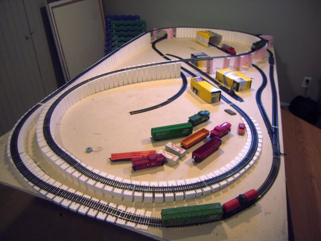

In this first photo you can see where the engine (a SAnta Fe GP-20) leaves the maintenance facility on the far right and heads down toward the main line. It goes under the track with the Burlington Northern Alco 430 on it. For now all of the building are just some quick things I threw together out of scrap from the boxes the foam risers came in.
Below is another shot that shows most of the layout. You can see where this starting track connects to the main oval on the far left.
Where the Alco engine is will be the viaduct made of three or four plate girder bridge pieces.

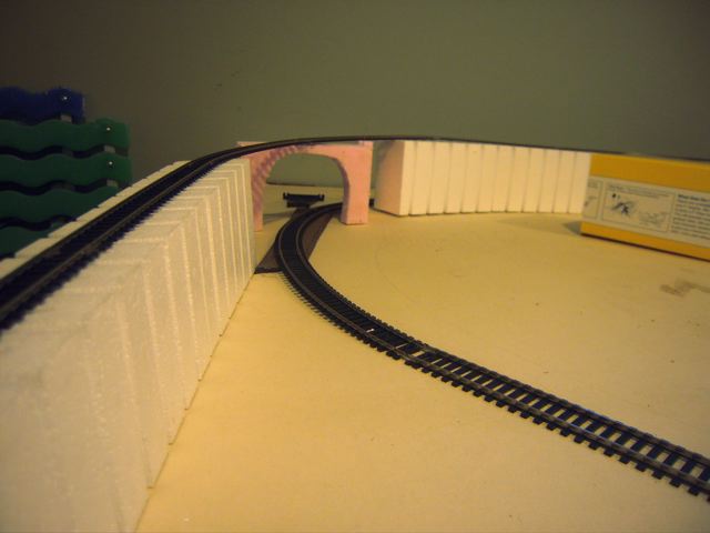

This forth photo below shows the left hand side of the layout where the trains curve around to the back side and go up the grade to the higher level. This is a 4% grade which is very steep in real world standards but necessary to get high enough for the bridges on a 4x8 board. This shot also shows the 4% grade back down on the inner loop. There is some misc. tyco rolling stock hanging out in the loop as well. The lonely siding coming into this loop is just some track I set there. I want to eventually have some industry in this area but it is open right now for future expansion.

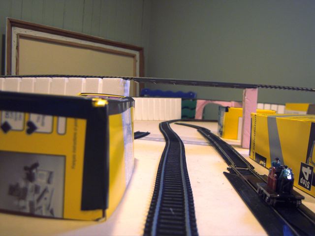

The next photo (below) shows the back corner of the layout. The track stays at for inches off the ground as makes the corner. The pink foam arch shows where the track goes into the eventual tunnel I will build. This is the entrance to the tunnel. The trains go in here after coming down from the inner loop in the above photo and and going under the center of the figure eight. I'll make a nicer tunnel entrance of course. This will be a tricky bit as the track curves here but I need a bridge. I'll need a wide straight bridge that will accommodate the curving track. I may have to kitbash something together.
This shot below shows the exit of the tunnel on the right and you an see this is close to where we started.
The last shot is the view down the main area that crosses in the middle of the eight. This area looks pretty rough. I put the gandy dancer on there for fun. The track on the right is not hooked up right now. It is going to be a siding for the industries on the right. The track on the left is the main line. You can see a tiny bit of the track (far left) that will eventually spur off to the industrial area in the left hand loop. This main bridge in the center will eventually have three tracks going under it.
Well that's it! Nothing is glued down yet, just held down with pins. I think I may start gluing the foam risers tonight. They were so nice to work with. Everything went together very quickly.
Curious to hear your thoughts. I'd actually like to have another loop in here somewhere to get an even longer circuit run but I can't wrap my head around how to make the curves work. I think this will be enough as is. It is fun to watch. Maybe I can pt up a video some time soon.

I love where you're going with the layout. That should be a lot of fun.
My only concern with it is the drywall. That stuff's not too sturdy. Let's hear some other opinions, but if it were me I would replace it with a sheet of plywood, or even particle board if you want to go a little cheaper. I'm just afraid that it's going to start sagging, or even worse break off when you or a kid leans on it.
An easy, relatively inexpensive thing to do would be make a 4x8 frame from cheap 1x4s--basically a rectangle with a couple supports across it. Then nail the 4x8 sheet of particle or plywood over it. I don't know what things cost where you're at, but I could get this done at the nearby Menards for under $20 if I used the cheapest particle board.

I think that would work. It shouldn't be too hard to transport 1x4's and get them down the stairs. Then you wouldn't have to worry as much about breaking the drywall. I'm not trying to tell you it's wrong, I just don't want to see you build a nice layout and then the kid leans on it and it collapses. Trust me, kids can be tough on trains.
Another option would be to get some plywood, and cut it down to sections. An 8x4 sheet could be cut down to two 4x4's, or 2x4's, then carried down the stairs and assembled over a 1x4 frame. You just have to have the supports running where the seams of the plywood panels meet.
And don't let awkward space or unusual materials get you down. Nobody here is going to judge the "quality" of your layout, unlike some other sites. My layout is in a garage/shed building that's hard to explain. Unheated, uncooled, when I go out at night the bugs swarm on the lights. It was that or nothing, so I did what I had to. Someday I'll post pics of the place because it's actually kind of unusual and historic.

The big concern for me as well, is the drywall. Once drywall starts to sag and or flex, It just gets worse and worse until it falls apart. It happens very quickly too. I would just hate to see you get all your track and things glued/nailed down to have it fall apart on you. I like burlington77's idea of getting some plywood and cutting it to fit down the stairs. I think you will be very glad you did.

i would trash the drywall & get osb board on a 1x4 frame. if you can't get the 4x8 sheet downstairs, cut it in half & carry two pieces. drywall is trash & it will not hold up.
i do like your design. i was thinking of doing something like that, but i'm concerned with it slowing down going up & running away when going down. i like to run long trains (20 cars) & it might give me trouble.

Unfortunately other posters are right about the drywall. Moisture creates havoc with the stuff
whether it be O S B or drywall please give a coat of paint. Is there Any way you can paint what you have now as much as possible both sides and as important the edges?.
I really like your layout. It's something i am toying with i e a figure 8 over and under. Nice to hear a 4 % will work..
What are the poly graduated blocks that you have under the incline/decline. It looks like something "store bought".
If not, how did you get it so uniform and graduated

Thanks for the comments everyone. Nothing is attached yet so I can easily switch to plywood. I'll have to be creative about it but should be possible. To answer a few questions:
Yes, the 4% grade is a pre-bought product. It is flexible and can be bent to any shape curve you want. It is just pinned in place right now but you glue it down and take the pins out when it is dry. It is designed to then have plaster cloth laid over it. It is made by Woodland Scenics. It is wonderfully easy to work. It comes in 2%, 3% or 4% grade. The 4% grade can be a lot for the engines to handle when loaded down. I suspect this is especially true with the Tyco engines but don't have anything else to compare. I had it going around pulling five or so cars and it struggled a bit even with fresh traction tires. I'm not too worried as I plan on running short trains and I may upgrade to a stronger engine at some point anyhow. I found that if the train has some speed going into the main grade it does a lot better. Of course, this translates into a lot of speed when it finally gets to the top. It requires a more hands-on technique at the controller but then again that is part of the fun. It does pick up some speed on the way down. I'm going to have some strategically placed re-railers around the track to help out on some of the spots where the cars are under more stress.

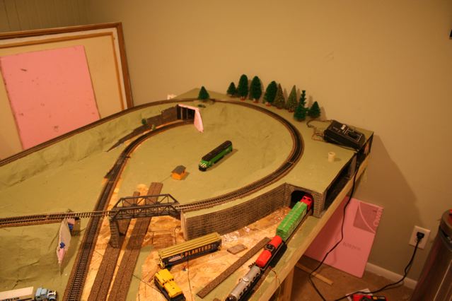

I've made a lot of progress. I just finished plastering, laying trackbed and all of the track for the main circuit. There is more track to be added and a lot of landscaping to be done but I wanted to get to a point where I could at least run some trains. My son is super excited that the trains are running again.
Here's the breakdown of the shots.

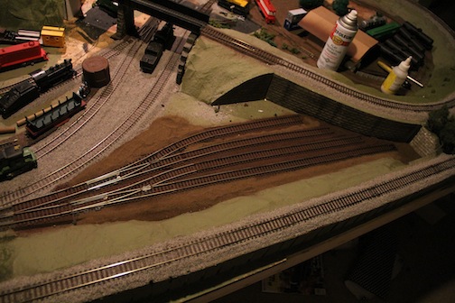

This is the general overview. I decided to completely scrap the idea of placing it on the table and just went the full 9 yards with the benchwork. This will give me many more options later on with wiring. It also frees up my table.
The basic layout remains the same.
If you follow the track that the green Alco Century 430 is on you can follow the route. Trains head around the first bend and up a 4% grade along the back of the layout. If I had to change anything it would be to make this a 3% grade on the up slope as I realized I could have gotten away with a longer incline. Oh well.
In case you are curious, the strange assortment of cars being pulled by the Alco was a test to see how much it could pull up the grade. There are a mix of sizes but it seemed to really start to struggle wit 10 cars.
The top of the grade is clear on the other end of the layout. I have some conifers stuck up there. It may become a forest, we'll see, they are just set up there. The track bends around and crosses over a bridge. The little one on there is an old Tyco bridge which will be replaced eventually with something longer but I like having it on there for now. The track then goes back down a 4% grade and loops under the bridge. It heads to a tunnel and curves back to the front of the layout where it exits the tunnel.
So what's missing? A couple of things. The big empty area on the right will be an engine maintenance facility with two tracks that tie into the main line.
I have some roadbed standing in for track about where they will go. There will be a siding on the back side of the layout in that little triangular area. The main industry will be on the left and is going to be some kind of scrap metal recycling facility. Right now it is just a pile of pieces waiting to be kitbashed. This are will be accessed by a track that splits off just after the exit to the tunnel. The track will then cross over the three tracks at a 90° angle and go straight into the industrial area.

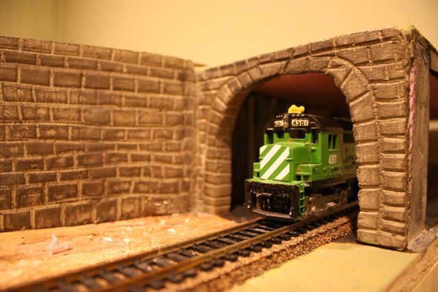

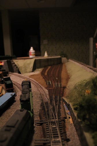

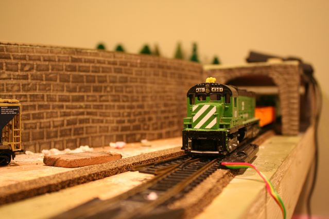

This shot is of the Alco C430 coming out of the tunnel. I am real happy with how the stonework turned out. It is all foam I hand carved. Looking at the photo I can see a pink spot. Oops!
Here's a similar shot but it shows more of the retaining wall as well.

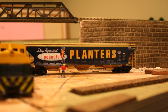

Here's a shot of a Planters car, a little of the wall and the bridge. The bridge supports have not been carved yet so it just magically floats in midair.

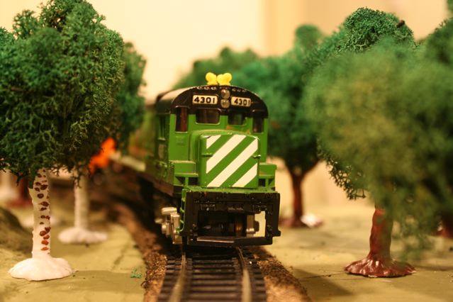

Finally, here's a shot of the Alco coming through the trees. The trees themselves have that real plastic look so I'm eventually going to repaint the bark in a flat brown.

The 4% grade on the downslope is absolutely no problem. The 4% on the up is a little rough. The engine started to struggle with 10 cars of mixed size. That was the Alco C430 that I re-motored with a cd motor. The Tyco seemed to crap out a few cars earlier. I don't have a more quality engine to try out. Something with a better motor could probably pull more. In reality, a train with too many cars looks kind of silly on this layout. I think my goal is to pull about 6 cars which is a length that seems to look good on this layout.
As mentioned above, the layout could have accommodated a 3% grade on the back hill which I think would make things easier on engines.
The little switcher can't make it up the hill with more than a couple cars. He's not really supposed to be back there though.

Awesome! It all looks great so far. I especially like your tunnel portals. I'll have to go back and make some portals like that for my layout
CamdenLine
Camden Line
 Posted - September 29 2010 :  11:15:30 PM Link directly to this reply  Show Profile  Add CamdenLine to Buddylist
Thanks! The portals are super easy. I'd still like to do a quick video some day of the process. Basically just score some lines in the foam, go over the lines with a nail head, paint, dry brush, done.

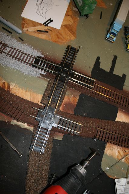

Another update is in order. A while back I got the Camden Line track all working in a continuous circuit. My son was really happy to have it all up and running finally. Constructing the layout isn’t quite as exciting for him as running trains. I'd been working on some landscaping lately but last Friday I had some time on my hands and decided it was finally time to make some changes to the track itself. There are two areas I had planned on developing but at least in the initial track-lay I didn’t include access to them. Partially, I had to wait until the budget allowed me to buy some more specific track pieces.

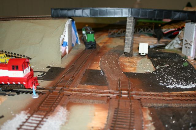

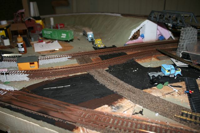

Here's the first area that needed work. In the middle of one of my loops I'll eventually make an industrial area. I'm leaning toward a rail scrapping facility. In order for trains to access the area, there needed to be two crossings. At the bottom, the track needs to cross the line that leads to and from the engine maintenance facility. Moments after that, the track has to cross the main line.
Here's a before shot. I had already laid roadbed so I could visualize how it would look.
I used Atlas 90° crossings but had to cut them down to size as they include a lot of extra track. Here's a photo as I was checking my cuts.
Finally, tonight I put it all together and added the connection from the main line. The paint on the ties is still wet in the photo. I still need to re-lay the line going to the engine maintenance facility. You can see the right hand track heading under the bridge is actually missing, it is just roadbed right now.

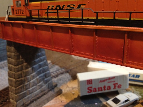

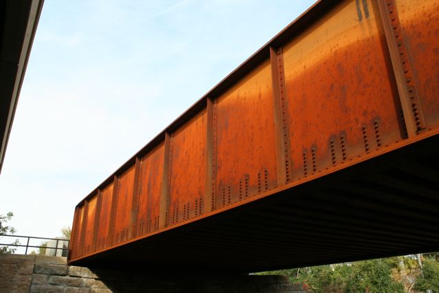

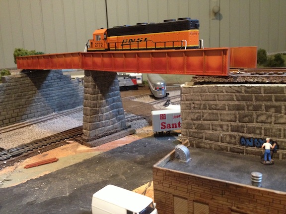

Speaking of the bridge, I also just installed the double plate girder bridge. It is a riding a little high and is also unpainted right now but will be a kind of burnt umber color eventually.
Here's the prototype bridge I was inspired by. This is on my bike route. I love the colors and patina.

I need to do another update. Looking at the old photos on here it has changed a lot! I've moved track, added a lot of ground foam bushes, kitbashed a bunch of buildings and more. Just tonight I cut two inches off a main hillside to make the underpass wider. It looks better and more correct with the double plate girder bridge and perhaps more importantly allowed me to remove a deadly s-curve that was derailing my long streamlined amtrak trains.
I'll try to get the camera out some day for some shots.

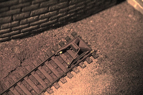

Time for another update. I'm working now on my small yard. It isn't very big but since I'm working on a 4x8 layout everything has to be representative or suggestive of something larger. The yard is comprised of three switches and four tracks.
In order to make it work, the first switch is actually a 3 way switch with one path being for the main line and the remaining two for the yard. This space saving move allowed me to have the entrance to the yard on a curve in the main line. At this point I still need to ballast and put in a dirt access road over the main line.
These are the bumpers I'm adding at the end of each track.
 Posted - March 16 2012 :  10:28:45 PM Link directly to this reply  Show Profile  Add Brianstyco to Buddylist
Like your switch set up for your yard - Great work

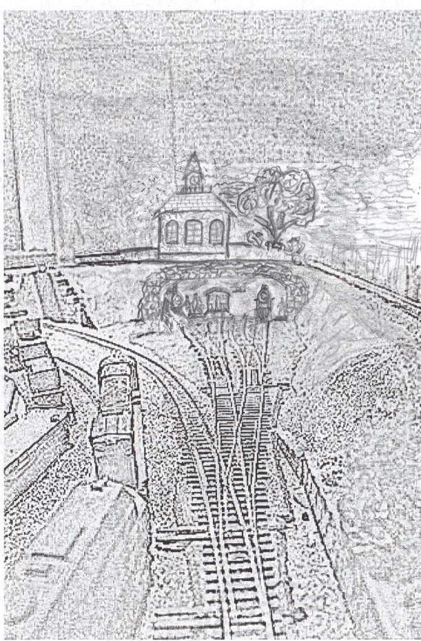

Kirk ; I hope you dont mind a idea.
** JUST MAYBE !!!
* Not a great picture but one I could do quickly.
* Open up underneath hill. Extend 4 tracks to board edge. Build a lift out platform for the hill surface above. This is for the train station building above the hill. This station area can be detailed with platforms between track 1 and 2, and past track 4. This will give you 4 longer storage tracks, 3 with platform access and 1 for trains straight through. Imaginary, yes. But it does increase your off main line storage track space for passenger yard. You could store a couple of passenger trains at the platform and as openings on the main lines occur run passenger trains in and out of the station.

Hey Frank, nice idea. I've often thought about other ways to expand and squeeze in track here or there. It is funny you mentioned the idea of cutting through the hillside and continuing on. I was just thinking about that the other night. It would certainly give me more room but it would do so at the expense of the scrap yard I am building on the other side of the hill. The idea of having a kind of platform over the yard like that is neat though. So many possibilities. That's part of the fun. It is so easy to change this stuff around that when I get sick of it a certain way in a few years I can always just switch it around.
Working on a 4x8 it is always interesting to see how you can fit everything in.

 Posted - February 03 2013 :  12:20:35 PM Link directly to this reply  Show Profile  Add CamdenLine to Buddylist
Wow, it has been almost a year since I have posted anything about the layout. I've been poking at it here and there making small improvements. This weekend I finally got around to painting the long bridge. It had been the shiny unpainted black plastic since the beginning. Black is a fine color for bridges as many companies used to paint them black but what with the state of the economy, no one wants to be spending money painting bridges anymore. Newer bridges are often made of weathering steel which forms a natural rust coating on the exterior. It basically protects like paint but you never have to do anything. I posted a photo of a weathering steel bridge further up in this topic.
Well, I finally go around to putting on the paint. It was airbrushed in many layers using very cheap craft paint from Michaels watered down 50% with windex. I forget what the two colors used were. I can certainly go look if someone is interested.
The central pier for the bridge is a few millimeters high so the bridge isn't exactly level. I'll need to work on that before I solder the track.
Here's a close up. It isn't quite as bright orange as this photo makes it look.
Finally, a shot of the hillside just after the bridge. I recently covered the area with grass and added some trees I also picked up at Michaels. I had a gift card and they were selling the trees in 4 packs for $10 which seemed reasonable. The quality is okay.
There are other areas I've made progress on. I'll try to get more photos later.
~CamdenLine

That's definitely a unique way to do an over/under figure-8! I don't think any train sets come with that anymore, though Bachmann does offer an E-Z Track expander set for just that (if you get a train set with just a circle of E-Z track). The only figure-8 set Life-Like also currently offers uses a 90-degree cross track.
Over/under layouts are usually an interesting novelty at times, though I'm keeping my layout mostly flat...

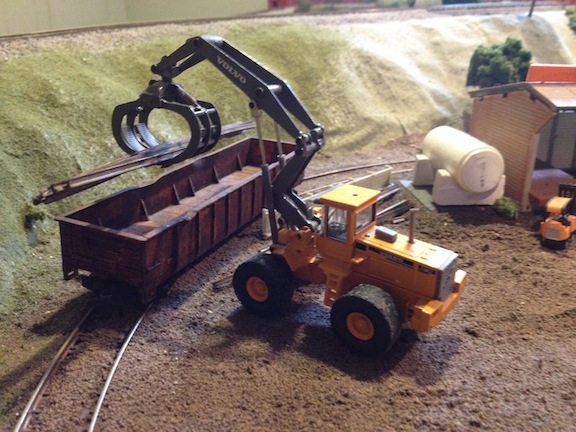

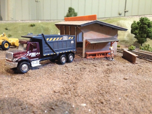

Mytyco commented a while back about wanting to see the scrap yard up and running. It's probably the least developed area on the layout but there are a few things there. I am thinking it will be part rail scrapping and part just general scrapping. The main building on the property was lightly modified from an old lumber yard I had sitting around. I think you can still buy this from several manufacturers including Atlas.
I have removed much of the innards to make them into bays where a truck can back up and load/unload. I also removed the shed from next to it and relocated it elsewhere. The shed was replaced with a large scratch built propane tank.
The yard is serviced by several vehicles including this Volvo. It is technically a log forwarder but it works great for moving large scrap like these rails around the yard.
The yard also features a walthers ferrous shredder which I don't have any photos of right now. One of the big things I need to do is create tons of scrap. Just one more winter project....
