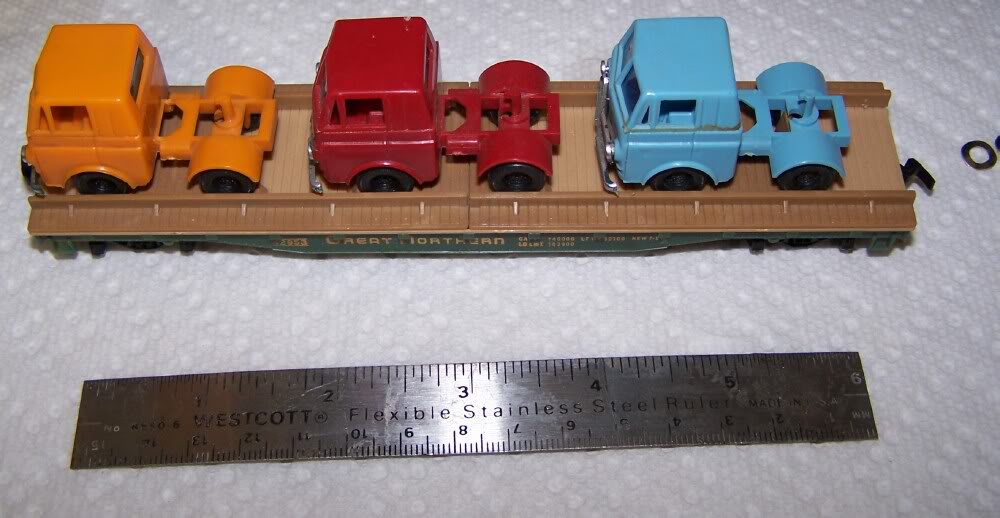

Hi, Jerry's Tip o' the Week, on how to keep your your rolling stock from looking like toy trash rolling down the track, doing the wobbly-weeblies. If you've ever run Tyco, Bachmann, Model power, etc cars and watched them oscillate back and forth while being pulled in a consist, you know how UN-prototypical that is ( and looks ). Here's a cheap way to fix it without modifying the original car body or truck, so you could return it to stock form with a few simple clicks.

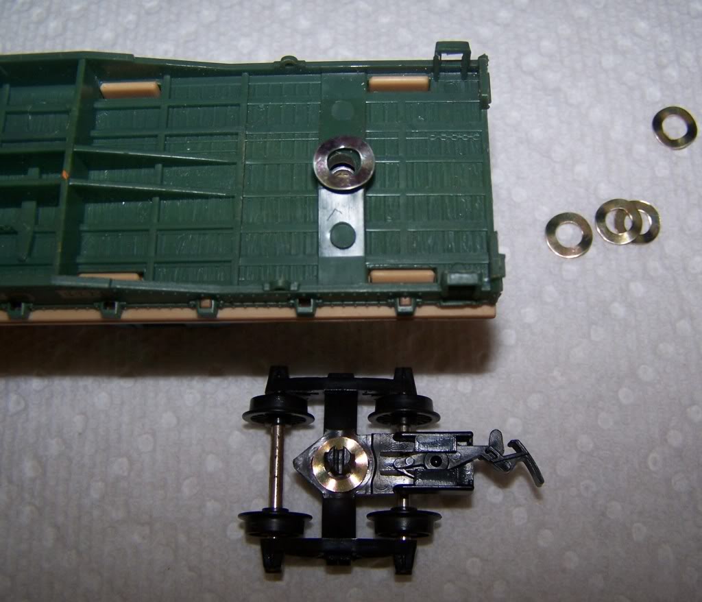

The cure? A simple spring washer, it's a very thin wavy-looking flat washer, and as it's name implies, it's springy. Used when there is need to take up a gap between hardware, but no room for a conventional spring. These I'm using are actually 4mm metric types, but any small enough to fit the truck pin will do. Here's the first picture, this is my first guinea pig :

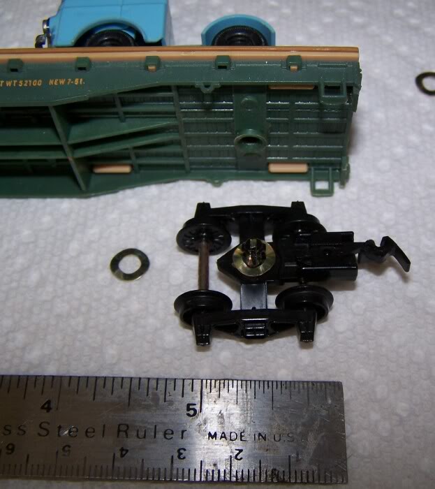

Simple basic flat car, but would wobble back and forth due to the excessive space between truck and car chassis. Here's the truck off the body, with washer next to it :

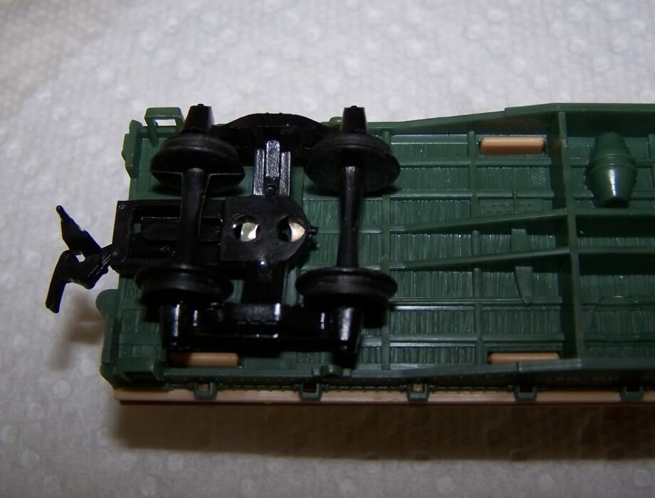

Takes a bit of effort to pull the trucks straight off, I'm going to see if I can make a tool to make it easier. Anyway, here's a pic with a washer on the truck, and one on the mounting pad :
You may need to use more than one per truck, my Lifelike RF&P boxcar required THREE per truck pin. My Tyco Union 76 Tanker took 2 each. My Purina open hopper car took only 1, like this flatcar with trucks. So it varies, depending on the space between the fingers which catch, and the pivot surface. Here's one of the finished flat car, you can see the gold washer in the holes :

Here's the dimensions of the spring washer :
8mm across OD
4mm opening ID

I too, like this topic and I'm glad Jerry posted this one. I like this fix because it is not a permenant modification, nothing cut or changed on train car body...
JERRY, did you glue the truck cabs to the flat car? I notice the blue truck in photo with the flat laying on its side, and looks to be a space under the flat laying upside down.
Thinking back many years it seems like the cabs & trailers "moved around" on the flat car as the train traveled...
I'll bet no cause the clips that hold the trucks down are pretty tight
-Walt
Originally posted by microbusss - July 03 2010 :  07:57:43 AM
Actually, Walt, like Micro sez, there are two flat plastic tabs for each truck that hold them on. They have a tooth on each one that grabs the truck axles, to prevent it from just sliding off, although the yellow truck tabs are slightly weak, and it pops off easily. But they won't shake, rattle, or roll running down the track. The yellow one kept falling off when I'd turn the car sideways for pictures, which is why you saw it loose. The tabs are pretty well-hidden in the photos, because they're right behind the wheels, from the side you can't see them at all.

Ben & Jerry, You guys are correct! I had forgotten about the tabs the point upward holding down the truck cabs. It must have been the trailers that I remember walking around on the flat car....
