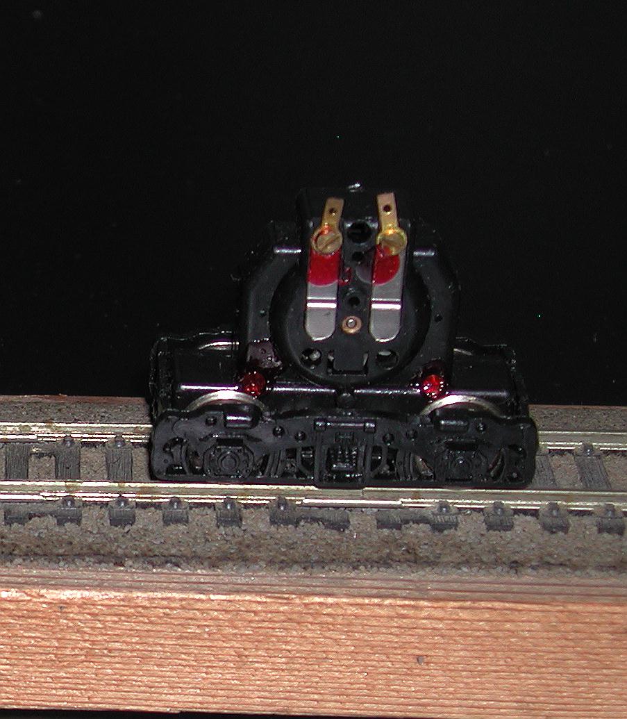

Hi Jerry. The early 1970's Bachmann engines had a square Brush that used a very poor method of putting tension on the brushes. (See picture 1) They had just a copper arm that was suppose to keep tension. But, if it got hot it would lose the ability to put pressure on the bush and then it would cause the brush to arc and cause motor to cook. That is what happen to these 2 engines.

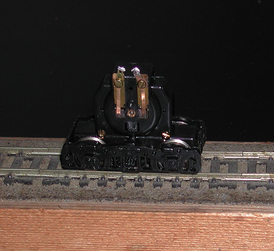

The later 1980's type (see picture 2) had a much better brush set up with springs and better connection, reducing heat and making the motor run better. I just replaced the complete assembly with the newer style. The engine is only 4 wheel drive so it cannot pull a lot but, at least it now runs.. The best thing to do would be to get the 8 wheel Bachmann drive used in the autotrain engine. That would be a much better upgrade. I wonder if the shell would fit on the U33B Athearn made. Mmm Going to have to check it out later.. Carl
