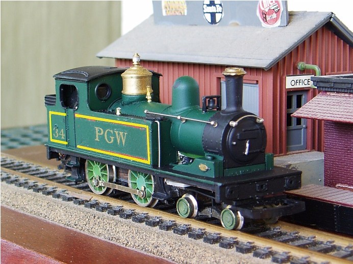

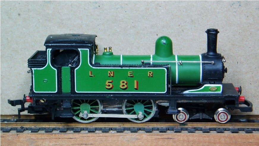

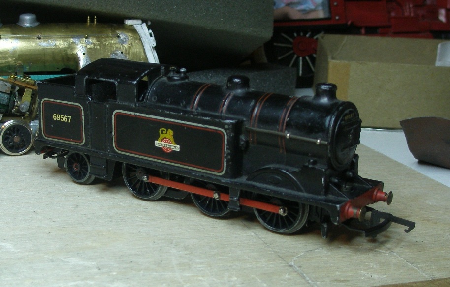

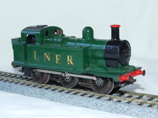

I had acquired a pair of 0-6-0ts from the chief engineer at the Catford Branch, PGW, London England.
They are English inside connected 0-6-0ts. The road name is LNER. The" London North Eastern Railway",
I think. The kitbash came about because of the ability of using one of them which was a parts loco, and a
attempt to bring it back to life.
The geared drive axle was ok. The two idler axles each had problems. Breaking them down from their 3
parts apiece I was able to make 1 good axle. The motor once it was cleaned up
did run so why waste a engine. Different spacing between the axels, and the fact
that the side rod connecting the center axel to the front axle was bent, made a
conversion to a 4-4-0 a natural. I have a 4 wheel Rivarossi front pilot truck
from a Genoa American. it looks like I have the makins of a 4-4-0 side tanker.
Now to put it together. Once I cut away the front part of the split frames, I
lose a supporting spacing piece, which also is used to hold on the bottom plate.
I have to replace it. I put in a additional insulating spacer between the
frames, cut the bottom plate to match the new length of the driver section. I
did some things to insulate the split frames from the new front pilot truck.
Drilled and taped a new plat retention screw location. Put it all together,
lubed it and it goes. The kitbashing is done. Like with any running locomotive,
I am always tweaking the drive to make it better. these split frame drives have
enough engineered built in problems that the tweaking is a ongoing thing. It
will become a loco to be repainted or just relettered in the future.
The future is now. I have stripped both Main Line bodies and I will repaint them for the Pennsylvania Great Western railway. A railway I share with a London modeler, catfordken. He at present is repainting a Penn Line Mikado. I am doing the 4-4-0t I changed the drive on, 0-6-0t , and my Jouef 4-6-2.
Here is where it started. Two 0-6-0ts. Transfered from the Catford Branch to the Frankford Branch.
The one with the scrach on the sand dome became the focus of the kitbash. It changed from a 0-6-0t to a 4-4-0t.

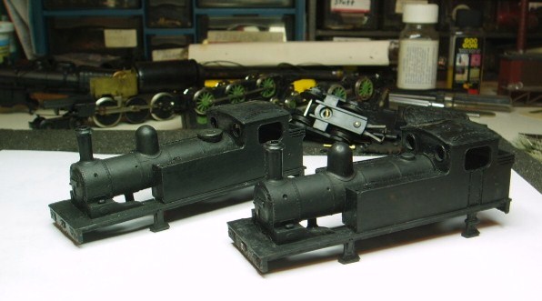

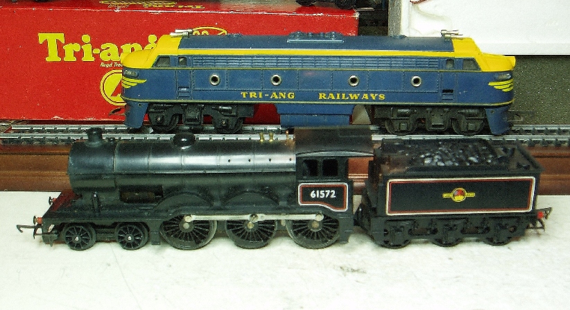

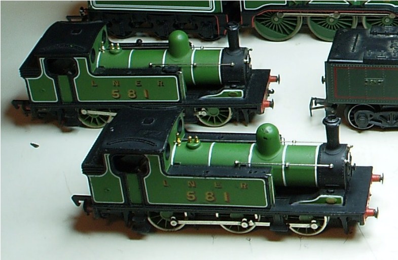

Here is the striped down pair of Main Line Models. The bumpers have been removed. Also on the one to the rear, a base for a new steam dome has been added. All work done at Frankford roundhouse..
Here is the Jouef pacific. Locomitive only transfered from the Catford Branch to the Frankford Branch. Tender was purchased directly

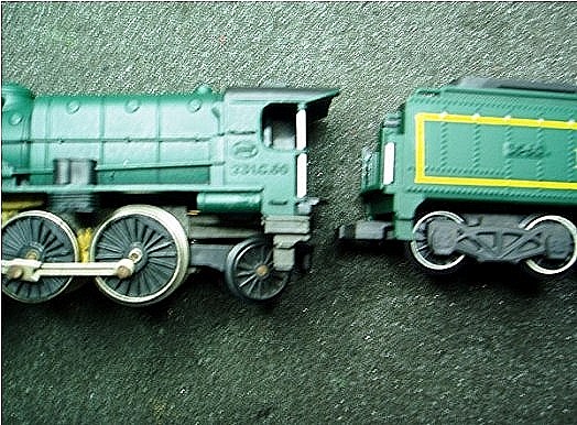

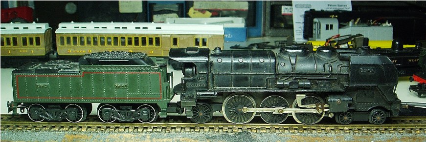

Here are photos of the Jouef 4-6-2 and how it is now. all work is done at Frankford Roundhouse. Locomitive only transfered from the Catford Branch to the Frankford Branch. Tender was purchased directly
Edited by - toptrain on June 19 2010 09:49:28 AM

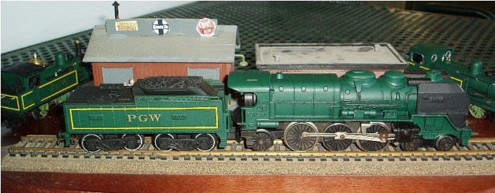

* On my Jouef 4-6-2 pacific, the handrails on the cab rear, and tender front, of the 6 only one was Ok. 5 had to be replaced. The trailing truck's wheels had a broken flange. I am luckey in having a trailing truck from a Model Power ( Mehano ) Pacific. The Jouef was all black plactic where as the Model Power has a metal tire rim. It is much nicer and in size a perfect match. I have 1 photo of it. it is out of focus. It shows the firemans side where all 3 rails had to be replaced. the Jouef trailing truck axel and wheels are still in place. I used white plastic round stock, 1/32" made be Evergreen Scale models.
* the photo
Edited by - toptrain on June 01 2010 08:25:10 AM

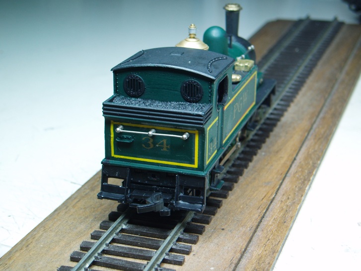

 Posted - June 01 2010 :  11:04:34 PM Link directly to this reply  Show Profile  Add toptrain to Buddylist

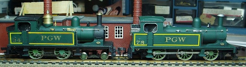

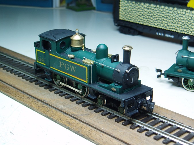

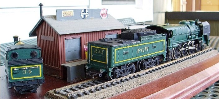

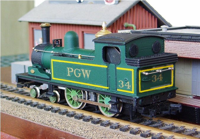

Here is PGW Loco # 34 now completed. All work is done at the Frankford Roundhouse at Bergen Point. Locomitive transfered from the Catford Branch to the Frankford Branch.
Edited by - toptrain on June 19 2010 09:56:30 AM
 Posted - June 02 2010 :  07:04:23 AM Link directly to this reply  Show Profile  Send catfordken a Yahoo! Message  Add catfordken to Buddylist
hi frank,ready to rock and roll there at frankford,ken

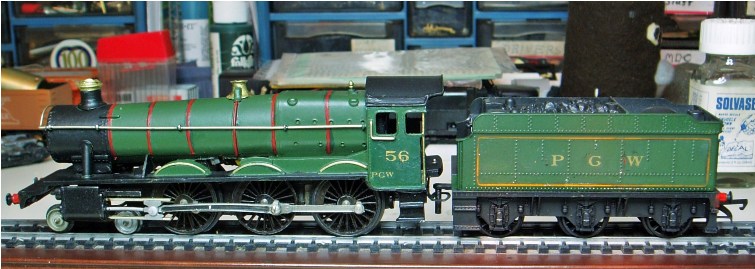

 Posted - June 03 2010 :  7:46:28 PM Link directly to this reply  Show Profile  Add toptrain to Buddylist

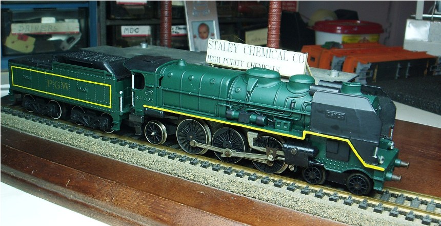

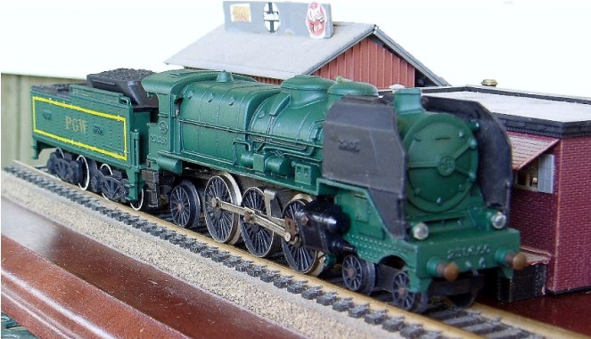

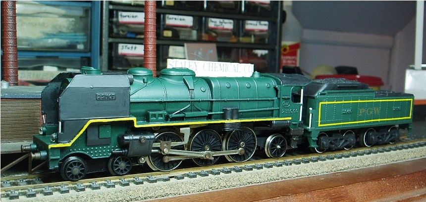

Here is the completed PGW # 231. It is a Jouef 4-6-2 Pacific. All work is done at the Frankford Roundhouse at Bergen Point. Locomitive only transfered from the Catford Branch to the Frankford Branch. Tender was purchased directly
[center
Edited by - toptrain on June 19 2010 09:51:18 AM

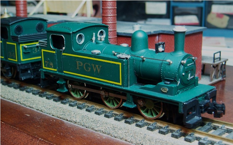

 Posted - June 05 2010 :  9:48:05 PM Link directly to this reply  Show Profile  Add toptrain to Buddylist

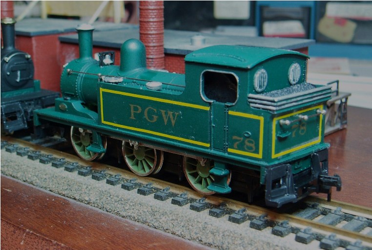

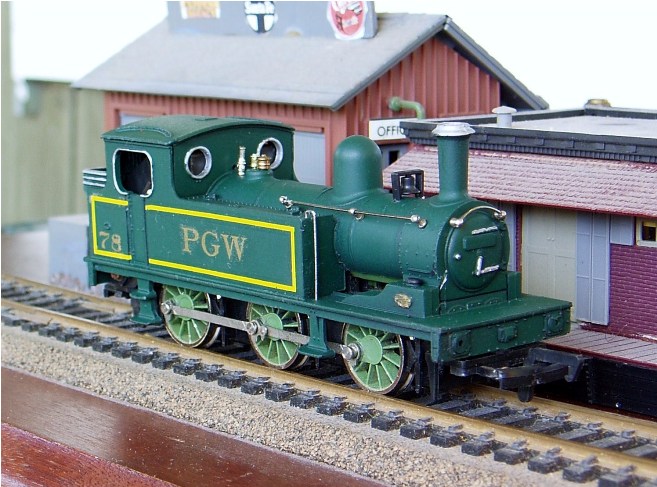

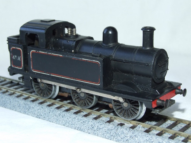

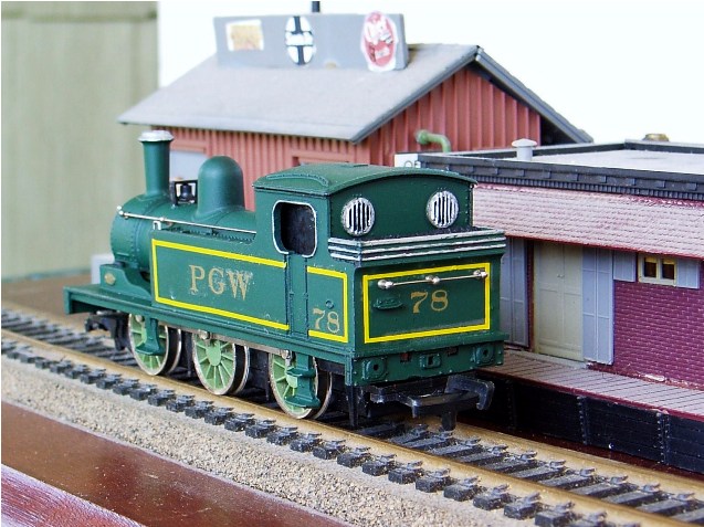

Here is the repainted amd ameicanized Main Line Railways J-72 0-6-0t. Now PGW # 78. All work is done at the Frankford Roundhouse at Bergen Point. Locomitive transfered from the Catford Branch to the Frankford Branch.
Edited by - toptrain on June 19 2010 09:54:04 AM
 Posted - June 06 2010 :  10:16:23 AM Link directly to this reply  Show Profile  Add toptrain to Buddylist
MainLine (Bachmann) J-72 split frame locomotives. All work is done at the Frankford Roundhouse at Bergen Point. Locomitives transfered from the Catford Branch to the Frankford Branch.
Two J-72s have become a ODD couple. They look nice on the layout. They appear to be able to handle small Passenger and freight trains. Since I recieved them they have been in constant need of quartering. They run a little then go out of quater and lock up. The motors respond well to power applied directly to them. Pick up of electricity thro the wheel and split frames is erratic. This causes a jerking in the drive. The snap is so sudden even the ACC cement applied to hold drivers quatered let go. I don't know how many times the side rods will be straingned before they break. It appears these locos are to be Roundhouse and layout props. Senic aids only before they destroy them selves. Just like all my other old Bachmann.
Edited by - toptrain on June 19 2010 09:55:15 AM

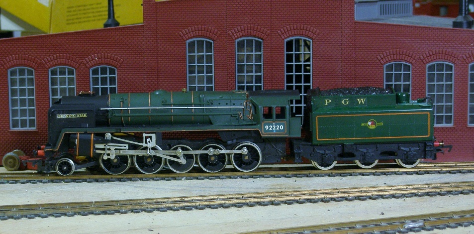

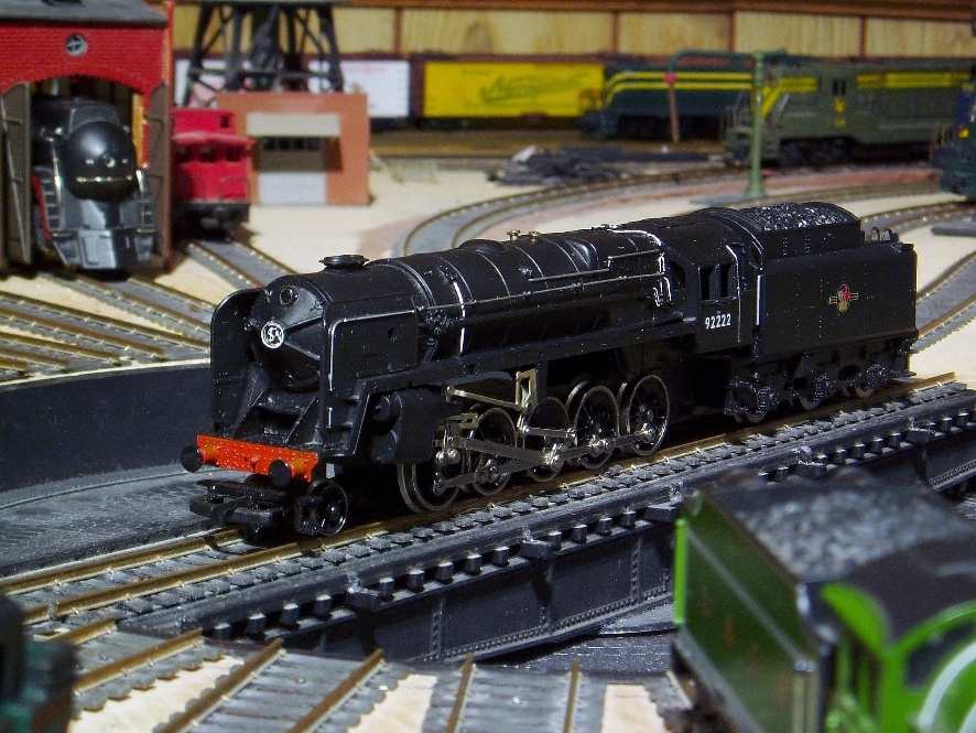

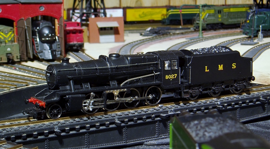

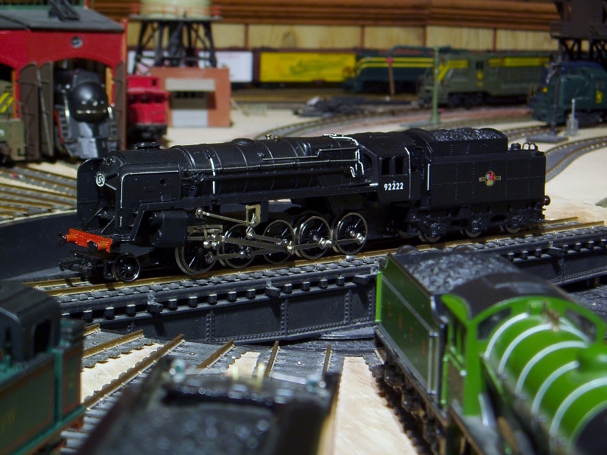

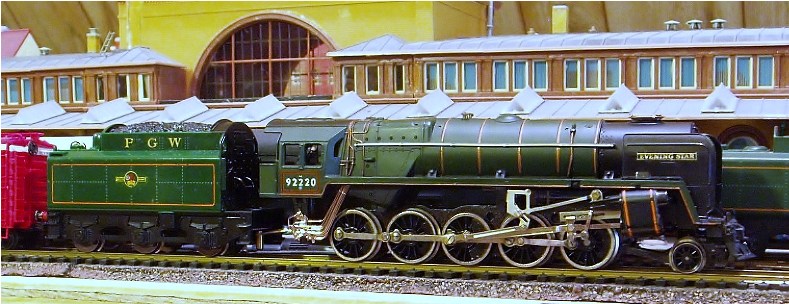

HERE IS ONE OF THE FIRST LOCOS TO JOIN THE PGW ROSTER. The Hornby 9F decapod "Evening Star". Aquired directly from BR British Railway for the PGW. The tender was transfered from the Catford branch. I didn't have the correct tender and the chief Engineer, Catfordken at the Catford branch engine facility sent this one. It was a great upgrage.
tottrain
Edited by - toptrain on July 03 2010 6:12:53 PM

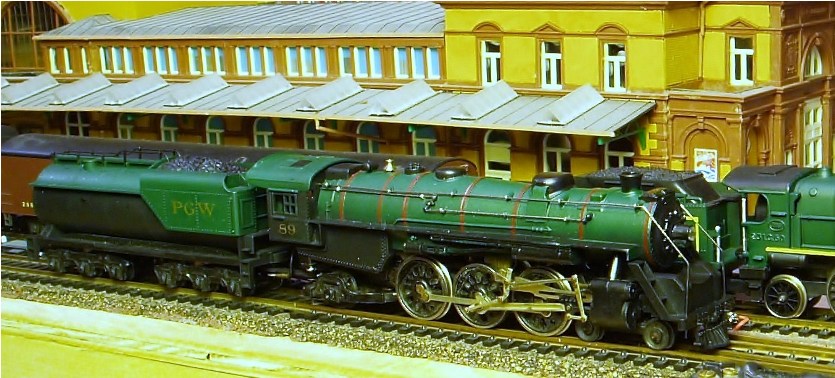

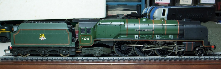

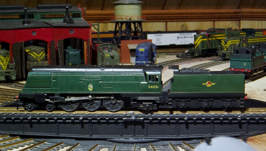

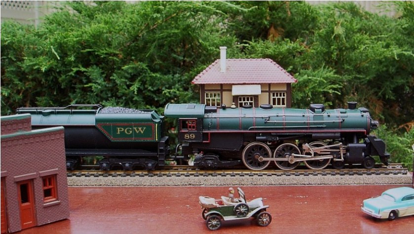

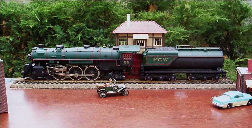

New Pacific Joins the PGW roster. Locomotive # 89. Rebuilt and painted at the Frankford Branch. Transfered to the Catford Branch. All work is done at the Frankford Roundhouse at Bergen Point.

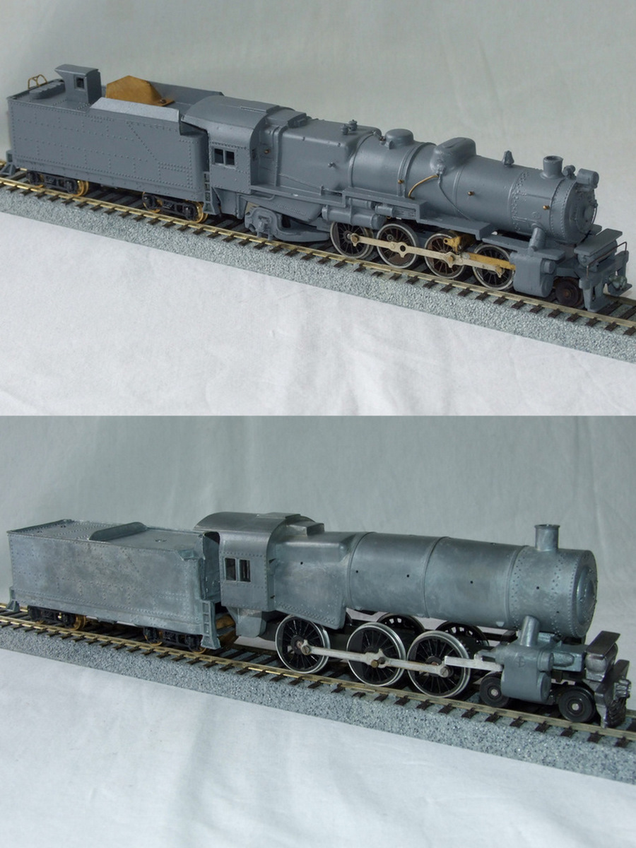

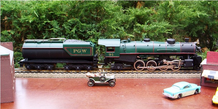

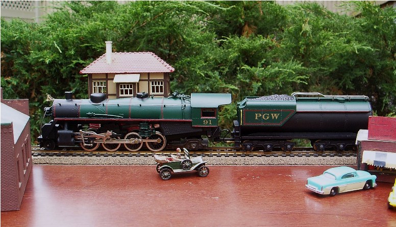

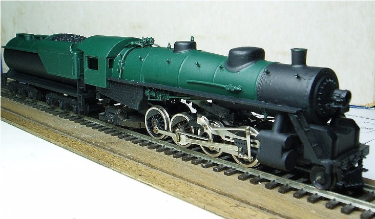

* And the work goes on ! The next is a USRA Heavy Mikado. A Mantua Mike is the starting point. It has a can motor and standard valve gear. A Cary USRA Heavy conversion bolier with details is next. The choice of most likley a Vanderbuilt tender to keep it in the same appearance as Loco # 89, the USRA pacific. We will see how it comes along.
Edited by - toptrain on June 12 2010 12:13:39 PM
 Posted - June 12 2010 :  5:17:30 PM Link directly to this reply  Show Profile  Add toptrain to Buddylist
PGW # 91 USRA Heavy Mikado. Rebuilt and painted at the Frankford branch. Transfered to the Catford Branch. All work is done at the Frankford Roundhouse at Bergen Point.
Edited by - toptrain on June 19 2010 10:04:03 AM

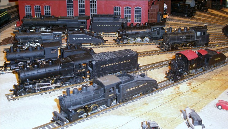

* Here on the shipping track sit two reconditioned and properly painted PGW locomotives. All work was done here at the Frankford branch. They have been transfered to the Catford London branch.
[/center]
Edited by - toptrain on June 19 2010 09:26:30 AM

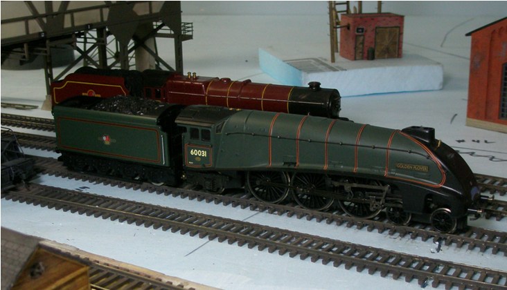

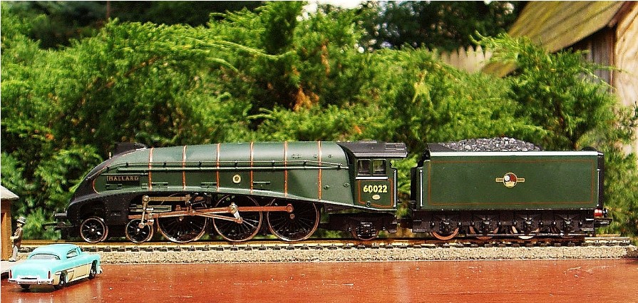

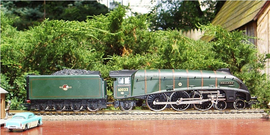

New locomitive for the PGW Frankford Branch. BR A4 class streamlined pacific " MALLARD ". It has been transfered here from the Catford Branch of the PGW.
Edited by - toptrain on June 19 2010 09:35:53 AM
 Posted - June 16 2010 :  4:07:00 PM Link directly to this reply  Show Profile  Add toptrain to Buddylist

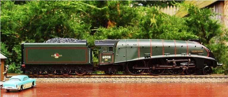

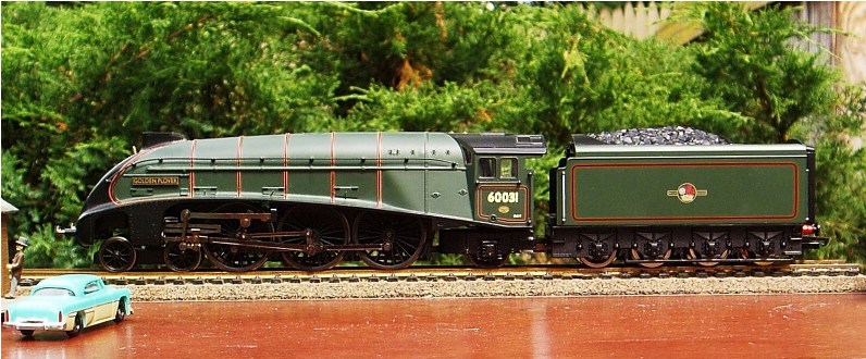

New locomitive for the PGW Frankford Branch. A BR A4 class streamlined pacific "GOLDEN PLOVER ". It has been transfered here from the Catford branch of the PGW.
Edited by - toptrain on June 19 2010 09:33:36 AM

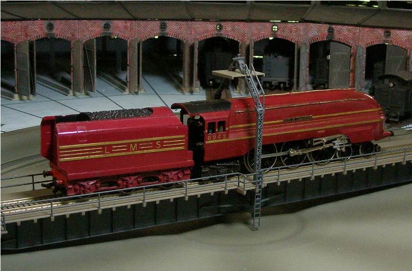

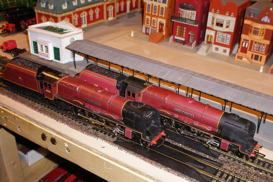

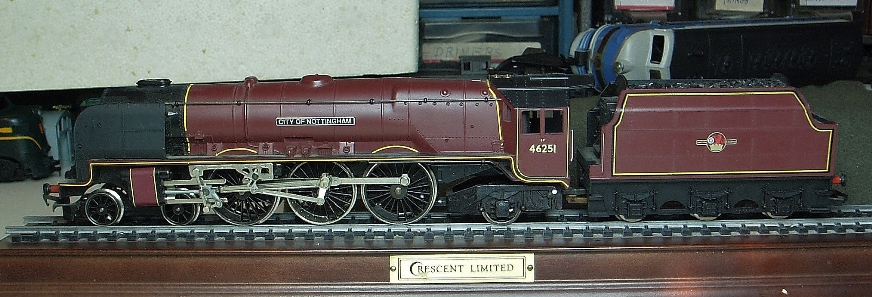

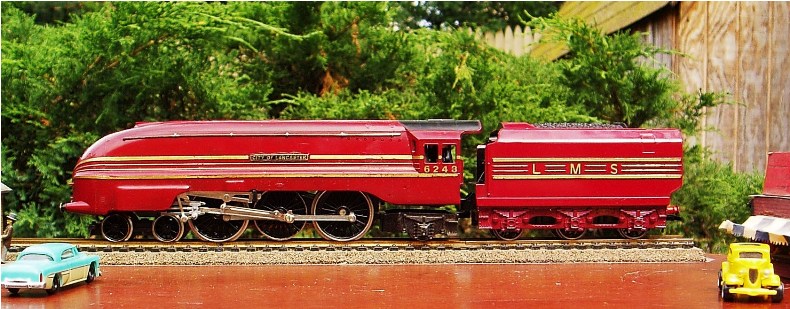

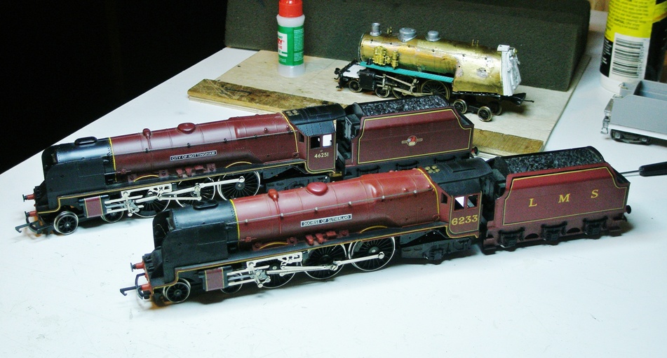

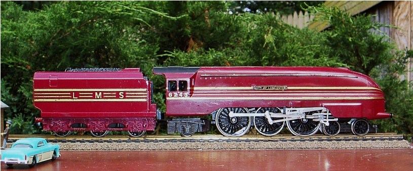

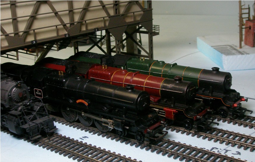

New locomitive for the PGW Frankford Branch. A LNER Coronation class streamlined pacific "City of Lancaster ". It has been transfered here from the Catford branch of the PGW
Edited by - toptrain on June 19 2010 09:30:45 AM

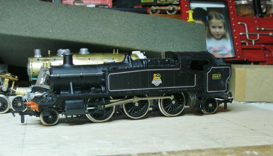

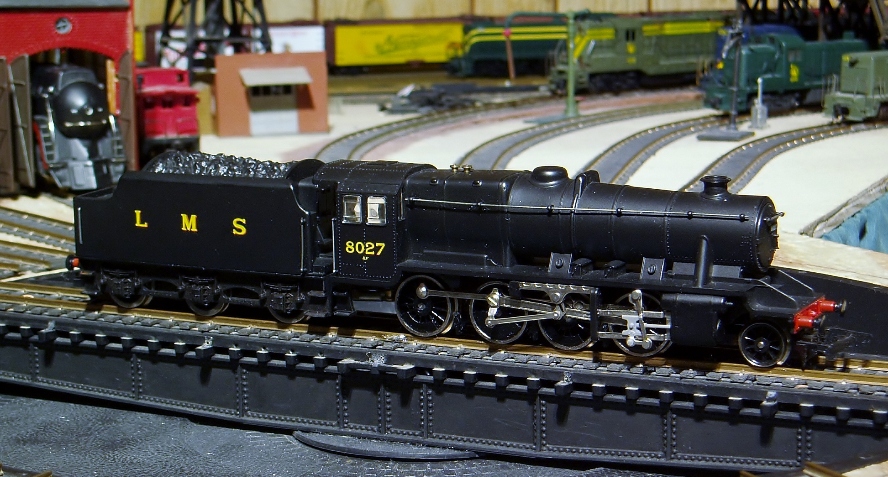

 Posted - July 04 2010 :  11:34:33 AM Link directly to this reply  Show Profile  Add toptrain to Buddylist

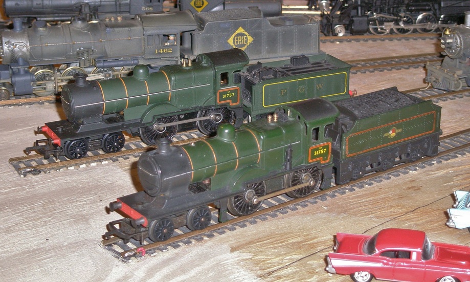

The Pennsylvania Great Western has need for some small switchers and has rebuilt a pair of 0-6-0ts. Forsitely they were transfered from the Catford branch in London here to the Frankford branch in Bergen Point. The maintance dept has done a excellent job of repairing this pair of 0-6-0ts.
Photos when they arived.
Now at there present state of painting.
All is coming along nicely
Frank

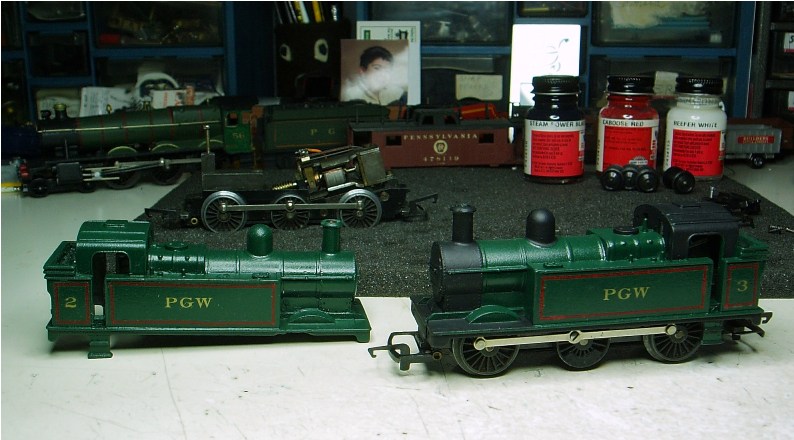

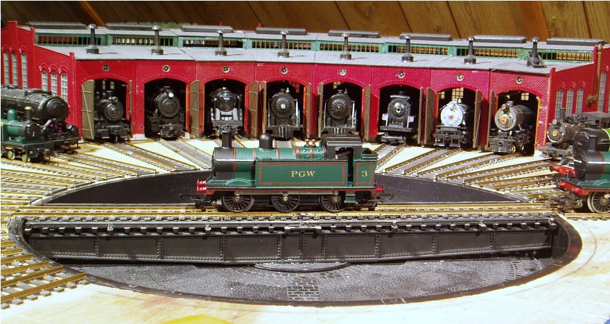

 Posted - July 07 2010 :  11:14:39 AM Link directly to this reply  Show Profile  Add toptrain to Buddylist

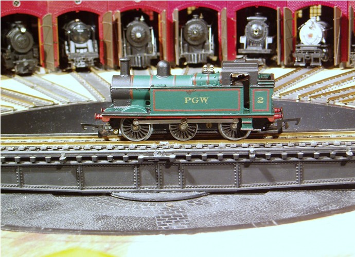

PGW Locomotives # 2, and # 3. Both Triang 0-6-0t type, X British Railway. Just rebuilt for the PGW.
Edited by - toptrain on July 07 2010 1:11:12 PM

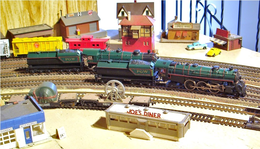

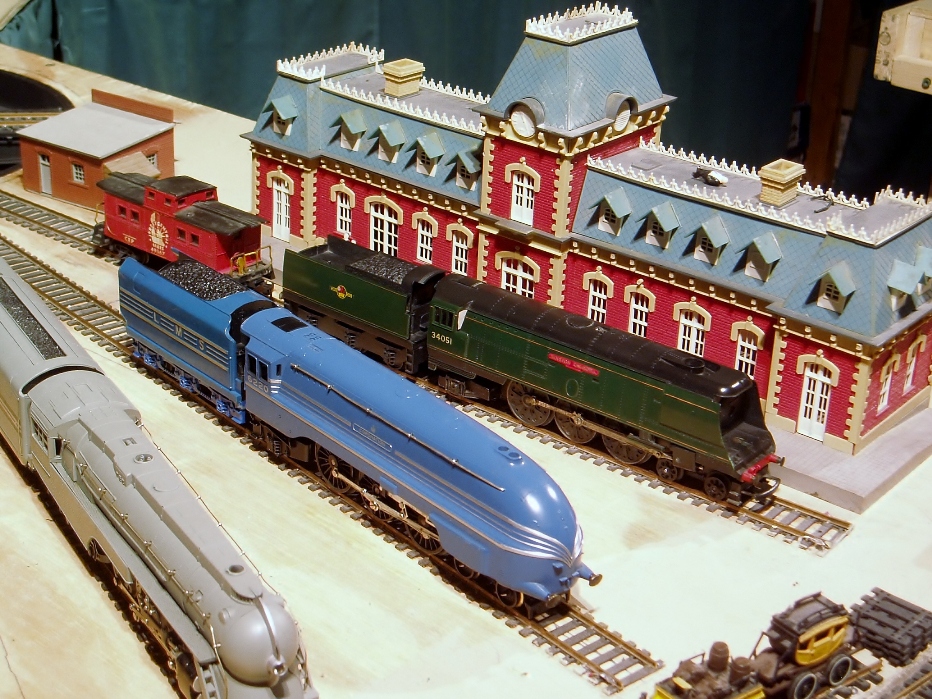

* The PGW at Saylorsburg.
* The PGW shares space with the ANNA RR, The Lehigh and New England, and CNJ. The Pennsylvania, Reading, Lehigh Valley, and Lehigh and Hudson are also seen from time to time here. There locomotives are no strangers to the Saliorsburg Engine facility. Here you will see PGW equipment at Sailorsburgh. Pacifics getting Coal with a Pennsylvania RR HH1.
PGW Streamliner on turntable.
A4 Golder Plover leaving coal tower.

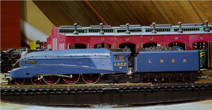

 Posted - August 07 2010 :  3:10:46 PM Link directly to this reply  Show Profile  Add toptrain to Buddylist
The New Hornby. LNER A4 Seagull. Thansfered here from the Catford London Branch.

Two new Pacifics 4-6-2 types for the PGW. 8P Coronation class. Cities on Nottingham and Sheffield.
* City of Nottingham
[/center]
* City of Sheffield
[/center]
Edited by - toptrain on January 07 2011 09:37:09 AM

A new ten wheeler has been added to the roster of PGW locomotives.
* A British Rail B-12 4-6-0. here it is seen with a British EMD made doublender.
[/center]

A new Decapod has joined the PGW roster. Transfered from Catford Branch it will be assigned to freight service on the Frankford branch.
Edited by - toptrain on April 19 2011 2:02:05 PM
 Posted - April 19 2011 :  1:59:11 PM Link directly to this reply  Show Profile  Add toptrain to Buddylist
Another locomotive arrived with the Churchill, and Decapod. Another freight locomotive, A Consolitation.

* Here are the latest two additions to the PGW fleet. Two more pacific typs. Seen here on the storage display tracks directly behind the PGWs main office building.
* Frank

A new addition the the PGW. This is the new Triang 4-4-0 with the correct tender next to the old one PGW with the Jouef tender.

* A pair of 6 driver locomotives are assigned to the PGW locomotive pool. A 0-6-2t By Hornby mehano, and a 2-6-2t by Airfix.
 Posted - January 12 2012 :  4:00:33 PM Link directly to this reply  Show Profile  Add toptrain to Buddylist
* A new larger Pacific. The "Dutchess of Southerland". A Hornby model with a tender drive. Here you see it with the " City of Nottingham".
Frank
Edited by - toptrain on November 06 2012 09:57:31 AM

The Next is another decapod. The " Evening Star ". I have 2 of these locomotives now, and 3 of the class. Maybe one of the pair will be renamed, and renumbered.
Edited by - toptrain on November 06 2012 09:23:37 AM

* In this photo we compare the difference between a un-streamlined Coronation Class and a Duchess Class pacific. The City of Nottingham is a Coronation class. The Duchess of Southerland is a Duchess class.
* If anyone here can explain what the difference is, or what is seen here, please comment.
* Frank
