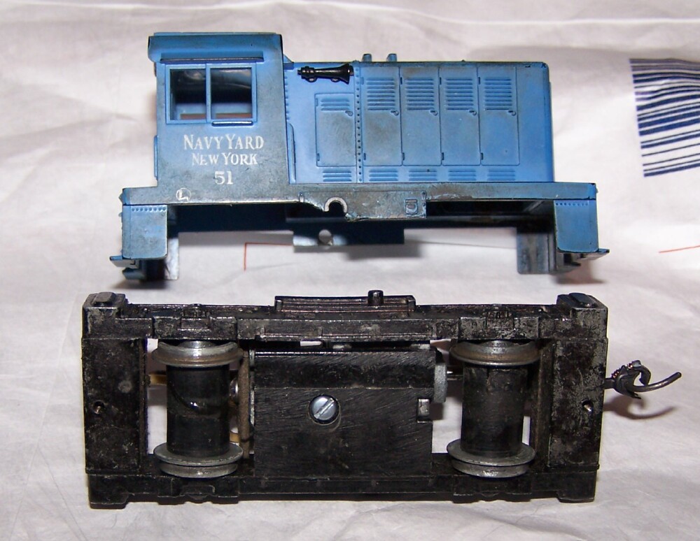

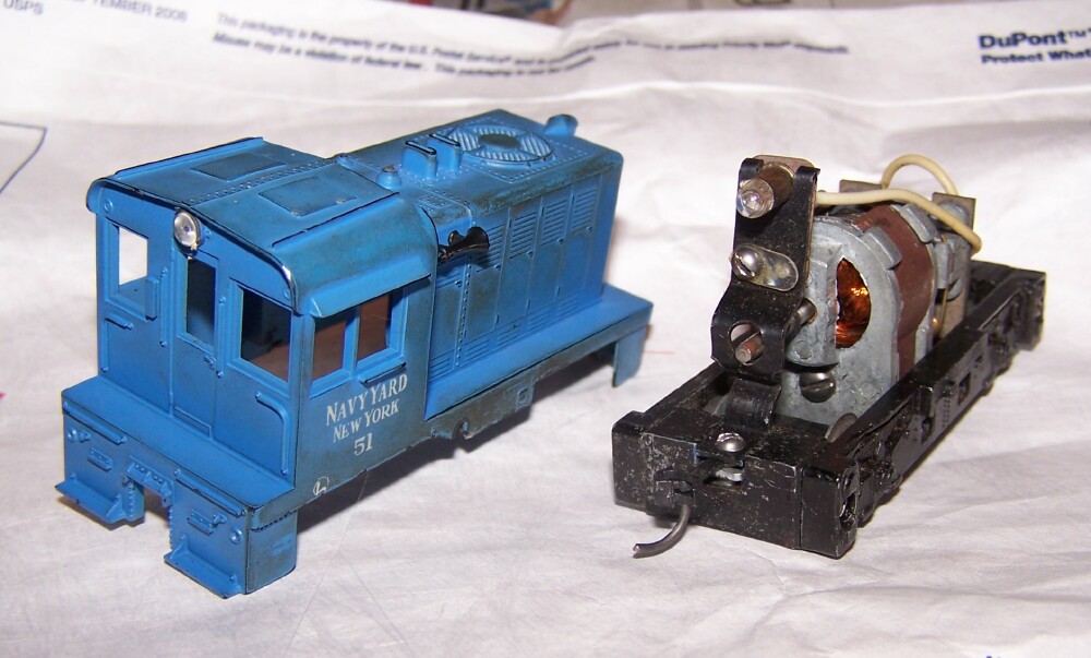

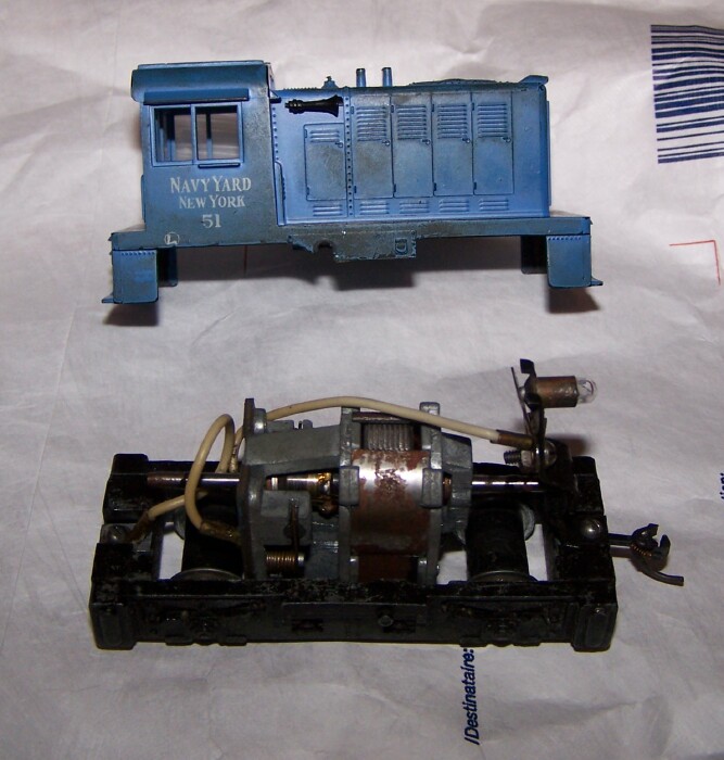

Here's some pics of the Lionel hustler - has a broken mounting tap, but nice otherwise.
And a side view :
rear view here :
Overall, for what I paid, I think I got a great deal...but it really wasn't the deal I was looking for, and I specifically asked about gears. Oh well, I guess God smiled on me for paying so little for some good stuff, so I shouldn't complain TOO much - but I gave up on other auctions with what I wanted ( they had pics of the underside, geared Hustlers ),so I could bid and win on this one first, not having much $ left in the Paypal account at the time last week. Very annoying to get this, and it turns out to be not what I had asked about directly. Guess I stepped on one of those banana peels this time... the metal Sharknose is probably worth alone what I paid for the entire auction. Man, is that thing HEAVY. Hope I can get it running.

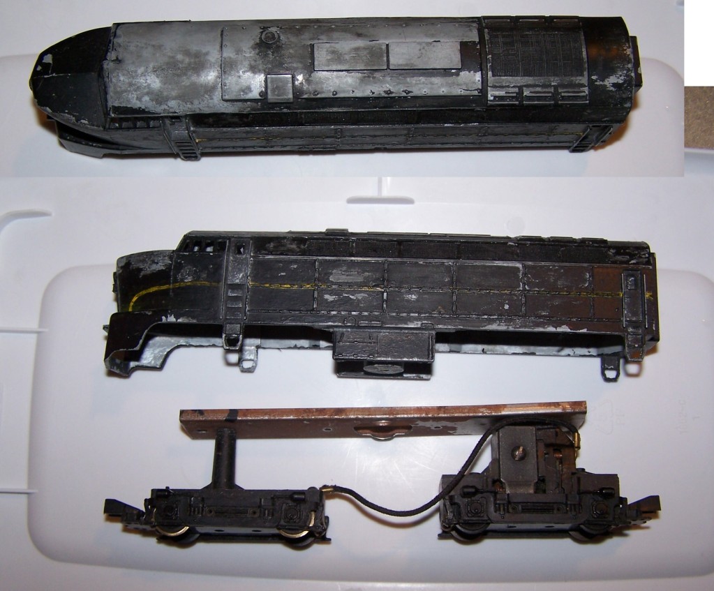

I took apart the Shark's brushes, and cleaned them with a tiny wire brush. Definitely had a glaze on them, plus some crud on the wire spring contact grooves. After a little maintenance, I put it back together, and cleaned the wheels also, they were heavily crudded, I set the chassis on the track, then set the heavy body on it. Hit the power, and away it went! Erratically at first, then it smoothed out. Slow, but does go around the circle. More than it did out the Ebay box! So with a little common cleaning, I think this will be a fine old runner. Here's a pic of it -
Notice the paint loss on top, and some on the front and sides. Is there any loss of value in repainting these? I'm thinking of stripping it down to metal and shooting it with some plain black, since it's already wearing off, or the former owner did some stripping, too. Hard to say. I think this is my very first Heavy Metal Mantua, and it's a nice one. Don't want to ruin it by modifying it , but not sure how valuable they are. NOT for sale at this time, it's a keeper. LOL.
