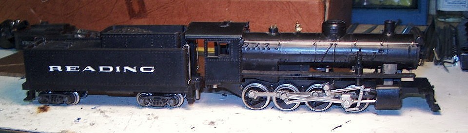

At a show a few weeks ago at Paramus High School a dealer had a lot of Lionel Ho. With them was some Rivarossi 2-8-0s. He had both the franch and english cab version. The only difference was the cab. It also had two different smoke box fronts. A plain one and one with a feedwater heater tank. The loco came with and without valve gear. The tenders coal bumker had either a top edge sloped down towards the front, or a flat top edge. The photo shows the flat coal bunker, a feedwated heater, and valve gear with the english cab. I know the Lionel name was on none of them. This dealer said that all the ones he had were lionel. He had a few different types. If Lionel sold this loco. What was it's appearance. What made it different.

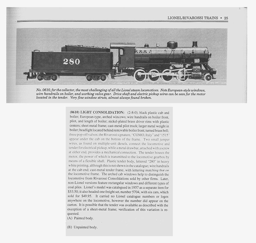

 Posted - March 28 2010 :  5:16:25 PM Link directly to this reply  Show Profile  Add VintageHO to Buddylist
Hi Frank. Lionel did offer a Rivarossi 2-8-0 Catalog number 0610. It was different for the regular AHM / Rivarossi engine. It had a plastic shell tender with a diecast frame and motor in tender. Number 280 on shell. It had a D shaped European cab window as opposed to the square American type. There were also no road names. If the guy at the show had some with the square cab windows with road names they were not the early models that Lionel had imported. It is hard to find the D cab window engine along with a Tender that the diecast frame did not rot away. My scanner is dying. But, I was able to scan page from Greenberg Book. You can see the differences. Carl

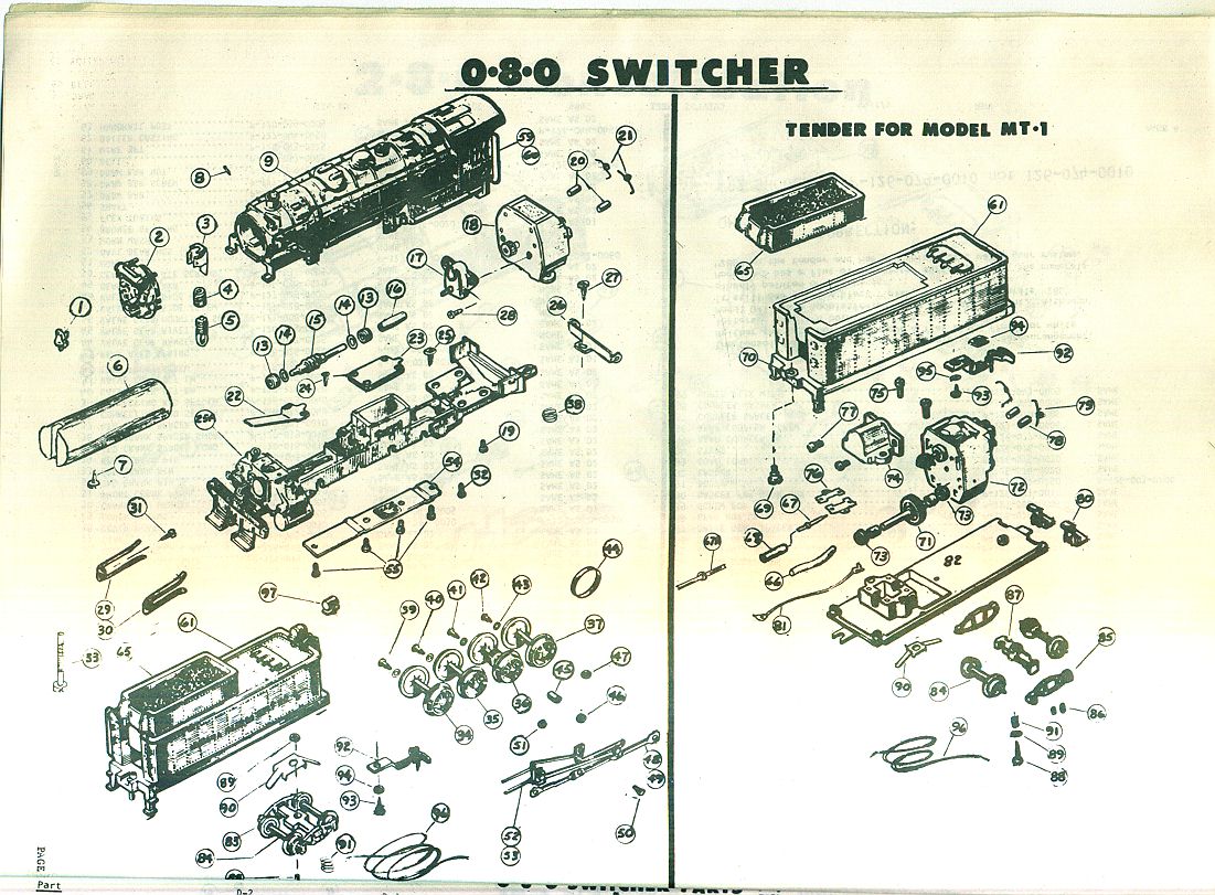

 Posted - March 28 2010 :  7:19:37 PM Link directly to this reply  Show Profile  Add NickelPlate759 to Buddylist
Frank & Carl, we've been having a discussion about these on one of the vintage HO groups I belong to, and we've also been trying to figure out who imported the tender drive version of the RR Harbor belt 0-8-0 in the 60's. It wasn't AHM. Do either of you know? Was it AHC?
VintageHO
Tyco Time
 Posted - March 28 2010 :  10:00:41 PM Link directly to this reply  Show Profile  Add VintageHO to Buddylist
Hi Nelson. Well you can tell the guys at the other discussion that it was AHM that imported the 0-8-0 IHB. In the AHM Parts Catalog from 5/1966 that shows both types of drives for the 0-8-0 According to the parts list it states that there were 3 versions of the 0-8-0. one was the MT-1 version with the motor in the tender. Carl
Numquam Immoderatio Satis Est
(Too Much Is Never Enough )
Edited by - VintageHO on March 28 2010 10:03:05 PM
 Posted - March 28 2010 :  10:48:13 PM Link directly to this reply  Show Profile  Add NickelPlate759 to Buddylist
Thanks for that, Carl. The AHM Scratchbuilder's Bible on HOSeeker starts with the 1969 version with the motor in the cab, so that threw us off.

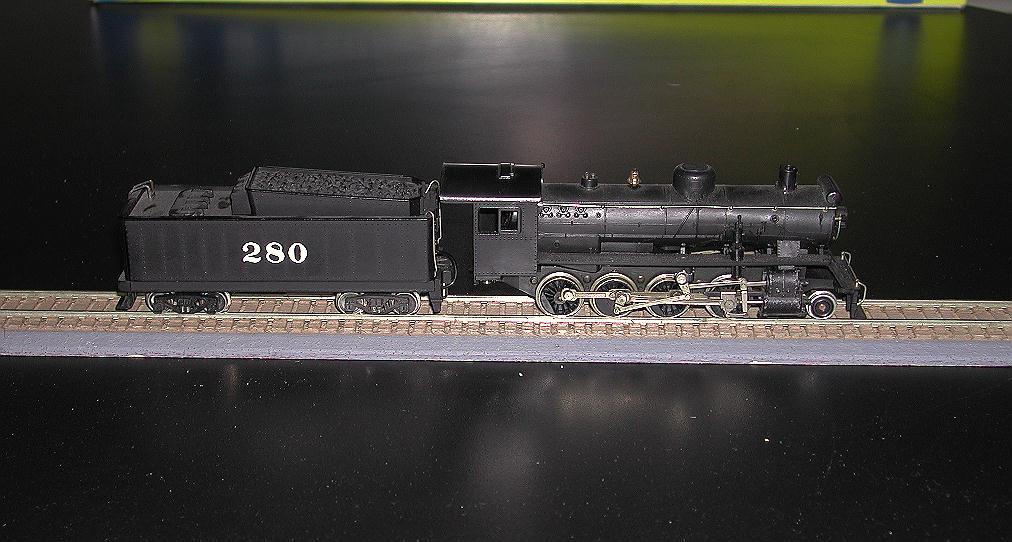

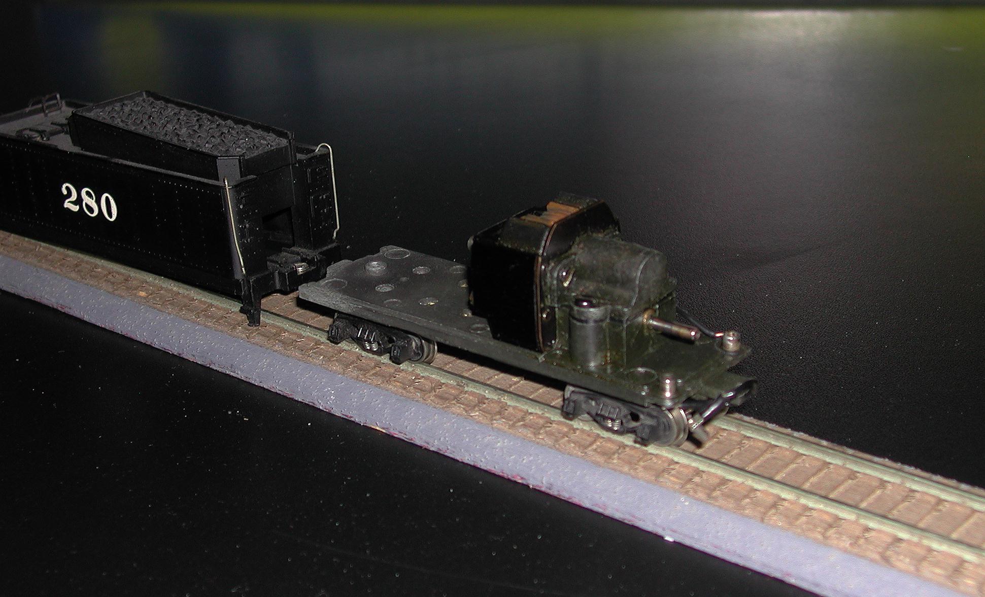

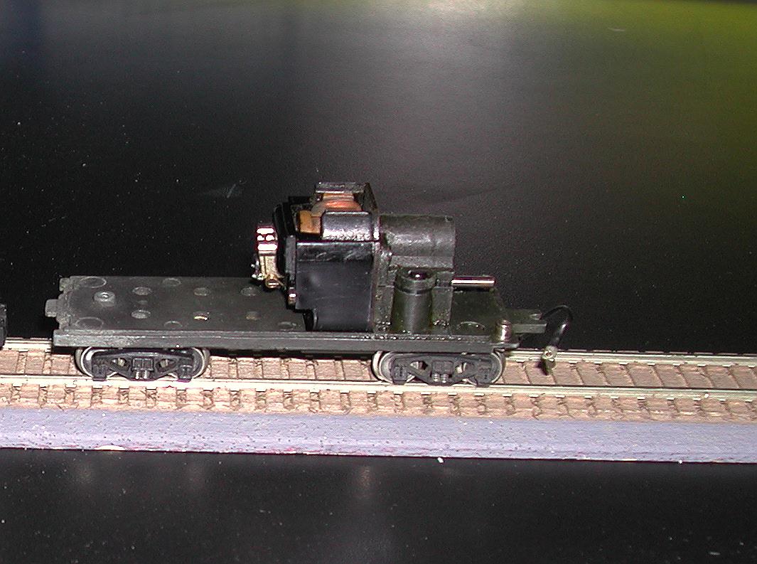

 Posted - March 28 2010 :  10:57:02 PM Link directly to this reply  Show Profile  Add VintageHO to Buddylist
I took pictures of the 2-8-0 I have this is the only one I have that the diecast parts of the tender have not gotton Zinc rot.. Carl
