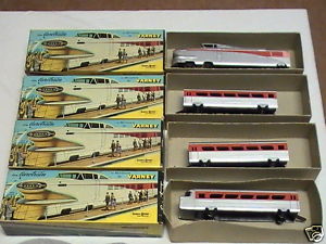

Hello All, I just picked up a beautiful complete Varney Aerotrain. The loco is powered with the old Kemtron drive. I was wondering if anyone has had experience with re-motoring. I've heard Bowser made a kit so an Athearn SW drive can be used. Has anyone done this?

It wasn't cheap at $100 for the set, but it's the lowest price I've found for a complete like-new set. It does not have any railroad decals, only GM and the numbers in the number boards. I'm thinking about Rock Island decals, though. I've wanted one for a long time also, so I splurged.

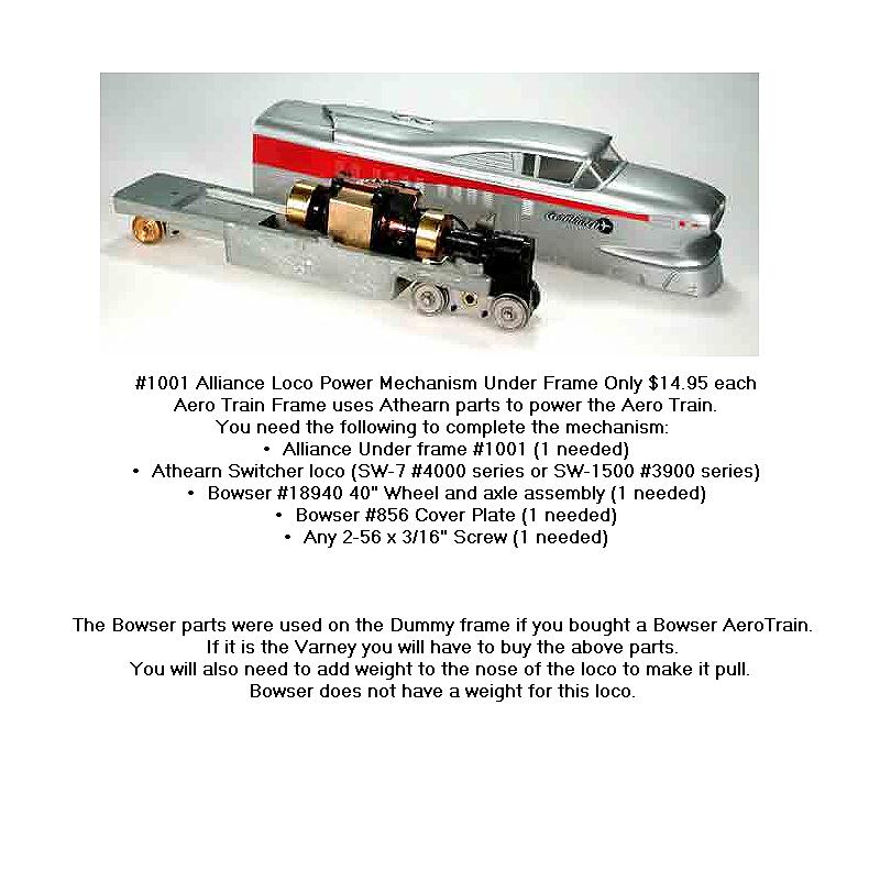

Hi Chris. Here is the Info On the Bowser/Alliance/Athearn Frame Power drive conversion. The frame from Bowser was $14.95 I do not think that it is still available. you would have to check.
There is a website called accuratelighting.com that lists the part. But, they are selling it for $27.95 almost twice the price.
Hobbytown of Boston also made a Drive also. Once I find the info I will post it.
My AeroTrain Has the original Varney power drive. Carl

Thanks, Carl, for the info. I did contact Bowser, and they don't have it anymore. If you find out anything else, I'd be glad to hear from you. Mine has what I guess is the original drive, which was made by Kemtron. It works as good as expected, but it's the same old story whenever you have a rubber tube shaft and no U-joints. Chris

Hi Chris. I Guess if you want one in a hurry that accuratelightning site is the only place right now. .
http://www.accuratelighting.com/HOscale/Electrical/HoscaleElectrical_BowserAerotrain.htm
Here are some pictures of the Varney Drive.
/tyco/forum/uploaded/vintageho/Varney Aero train Drive.jpg
/tyco/forum/uploaded/vintageho/Varney Aero train Bottom.jpg

Yes, Carl, Nice picture and nice Aerotrain---Looks like the Varney had a solid driveshaft with u-joints. The Kemtron looks very similar, but has a few more metal parts, like the gears. However, it has the flexible tube shaft. Maybe instead of a new mechanism, I can somehow find or build a drive shaft. Chris
