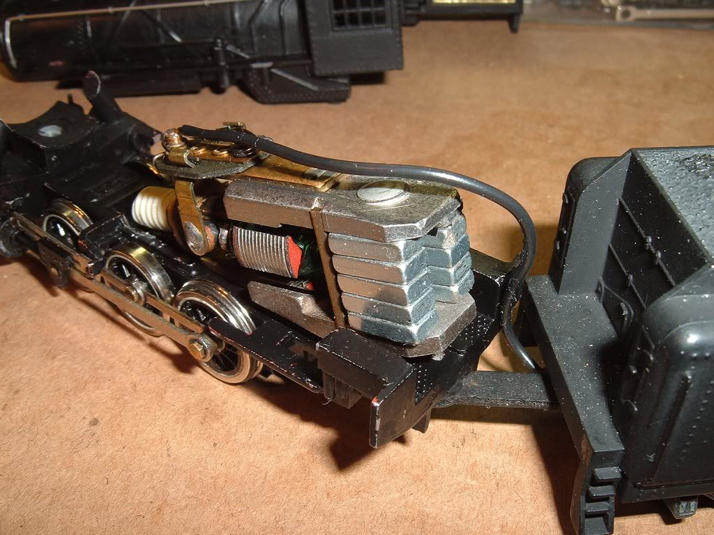

Yep, it's the metal chunk on the back. Here is a shot of my Big Six with two stacks of neodymiums on either side of the rivet.
These magnets came from Sonicare toothbrush heads, believe it or not. I'm not sure of their exact dimensions, because I don't want to magnetize my calipers. The original magnet is 1/2" high, so you could easily use a 1/2" block magnet and do away with the rivet altogether. You could glue it in, but the magnet will be more than strong enough to hold the motor together.

The old magnet can be pulled or pried out. The benefits: lower current draw, lower top speed, and more torque.
It won't be quite as stable speed-wise as some can motors, but it's a significantly cheaper option than a Helix Humper or the motors Yardbird Trains sells.
