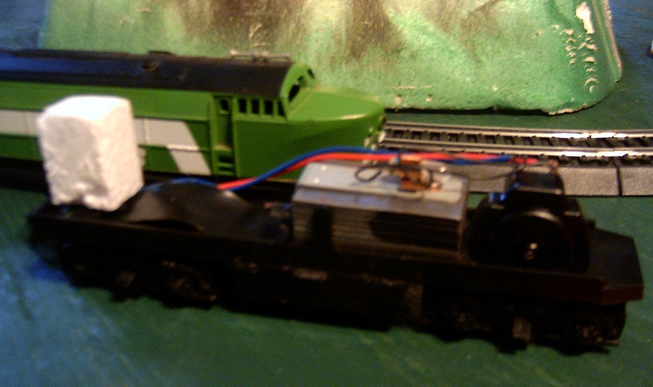

Someone asked about this in another thread, so I decided to make it my locomotive of the week:
It's a Tyco BN shark riding on a Life-Like F7 chassis. Simple. It's not for perfectionists, but it's a very easy way to power a shark.
Here's the inside. All I had to do was "whittle" the tabs on the side a little bit. They are in the same place, but they are too big. I wasn't very careful, and ended up with only the middle of the three tabs left. The foam block is there to help keep the shell from tipping backwards. A more careful modeler could have done a better job with this. The only real issues are: a) getting the shell to ride level and b) you have to completely remove the light bracket from the shell. Other than that, it's simple.

I have that same motor under my LL Chessie F7. Other than the fact in scale speed it runs about 300mph, its been very good to me. Actually on a good MRC transformer running about part 50-60% throttle. It pulls about 10 or so cars at a believable speed and stays pretty smooth. I have a matching B-unit for it which I've debated making it extra electrical picking for the front unit I think it would run much better.

That's exactly what this one came from. #4472, just like in your picture. My daughter wanted a dummy to push around the track, so squeezed an Athearn frame under it.
