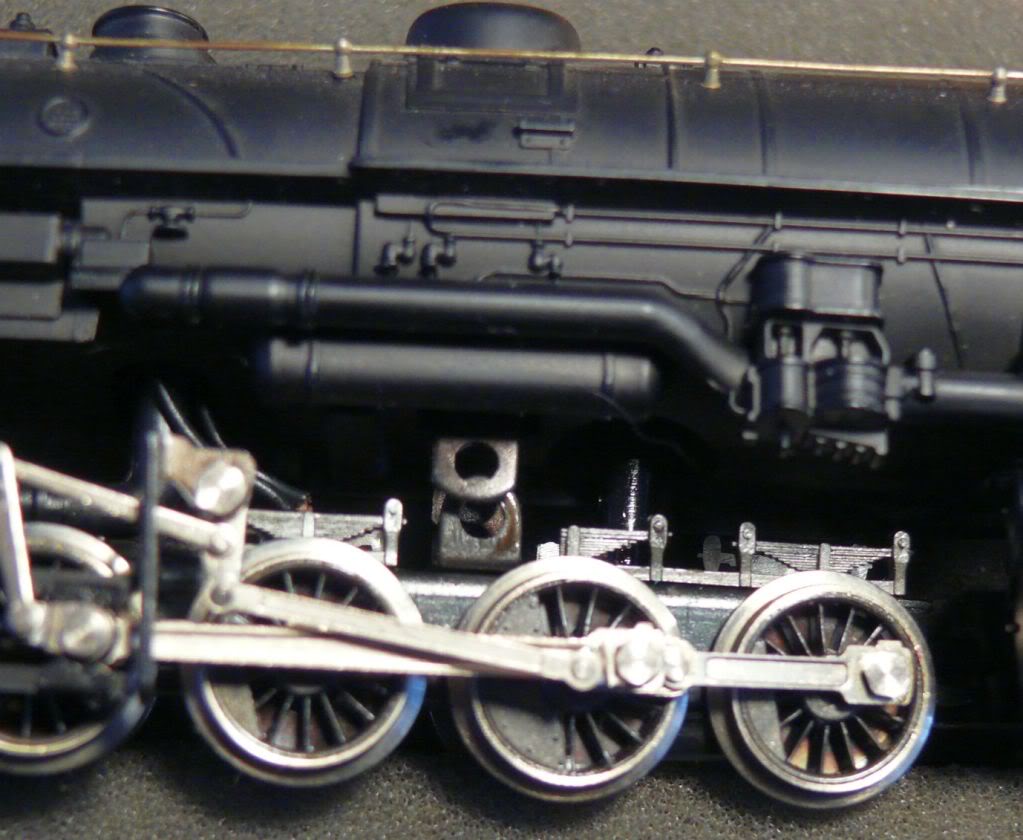

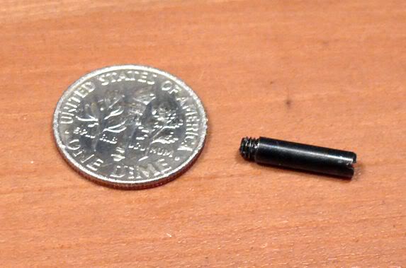

Steve - dug into my IHC parts catalog & I think the part you need is P-160-037, Metal Pivot Screw. As you can see, its a specialized screw. Notched RHS, threaded LHS in the
picture below. Also show a picture of where it goes, between the 2 'U' plates.
Unfortunately I don't have one, but they come up from time to time on Ebay when a couple of sellers of Y6B Mallet parts include them in the front truck frames they are selling from tear downs. You need to look real hard at the pics &/ or, send a query.
If you are missing the metal Pivot Screw, how are you for P-160-027, Front Metal Universal Joint?? - Its lurking vertically to the right of the pivot plates in the 2nd pic. It may have dropped out.
